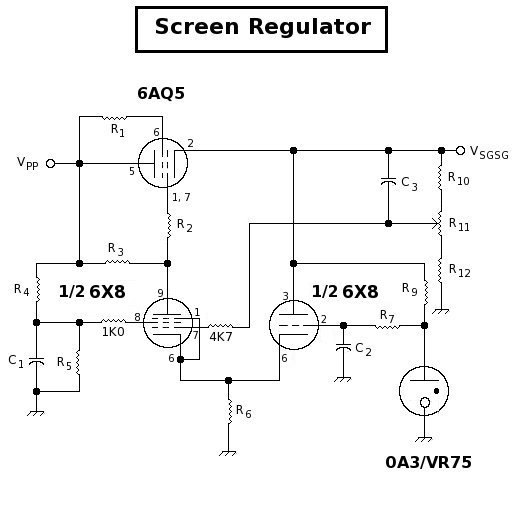

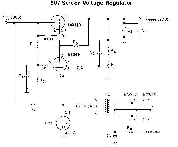

Me three. I include active screen regulation. This wasn't used much back in "the day", and even VR tube regulation was pretty rare, but it's worth it for sonic performance. These are series pass regulators. The design that uses an unbalanced differential error amp is somewhat better in that the noise from the voltage reference can be filtered, besides it allows you to use those 6X8s. Both are quite effective in stabilizing the screen voltage.
You could also solid state these regulators, but I didn't do that since I didn't have any high voltage transistors, and I'd already done that loads of times before, so this was different. Trioded 6AQ5s work nicely as series pass devices.
