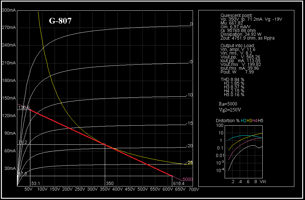

You say you have 94db speakers and you are trying to reach 102db. 4Watts gets you to 100db... within range of a SE triode with a 5K OPT.
I'm not sure what will give the lowest distortion... however triode seems to give good sound even with 5k opt's.
I will take even order harmonic distortion with no feedback over odd order...
However, the great thing is... everyone hears differently... so the question is... what do you like?
Build the chassis larger than you think you need...to give yourself space to add tubes, components as you develop it... you can start with triode...if you don't like it, you will have room for tetrode...and even PP if you decide...
No one can really tell you what will sound better...only distortion figures, power and safety can be calculated by math and what people convey on paper/ screen.

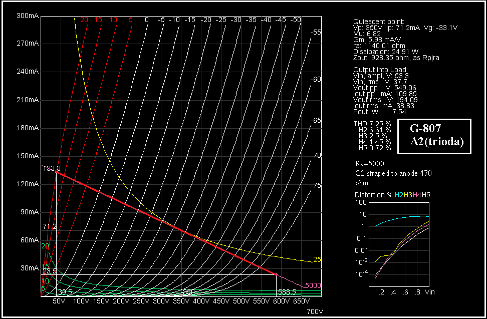

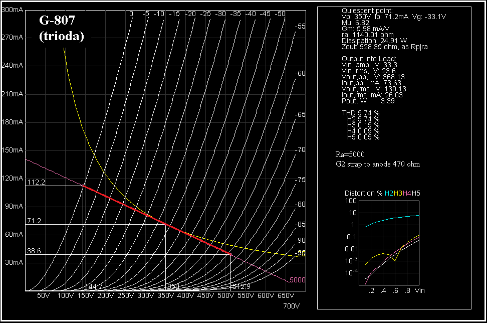

From these charts you can see the differences between the 807 tube configurations, at least theoretically.
The charts are for Ra = 5000 ohms
