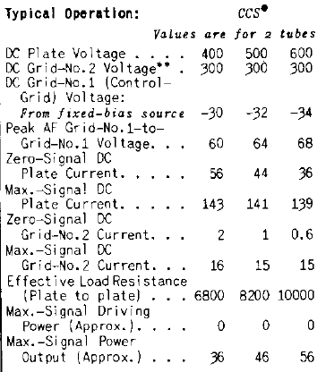

Janos - your results are quite exciting! Who would think good ol' 807 is capable of such tricks...
Low distortion of 807 at high plate voltages can be deduced from data sheet distortion curves. In fixed bias AB1, the third harmonic at maximum power decreases as plate voltage and power output increase:
Ua=500 V, Pout=46 W, D3=2.6%
Ua=600 V, Pout=56 W, D3=2.2%
Extrapolating, it could be something like this:
Ua=800 V, Pout=75 W, D3≈1.5%? Or, at half-power, 37.5 W, D3=0.75%! And this is without any negative feedback!
For comparison, 807 triode-connected:
Ua=400 V, Pout=15 W, D3=3.1%.
My experience with global negative feedback is similar to yours.
I also believe (no definitive proof) that having good cathode current reserve is beneficial for sound. In your case, only 25% of cathode current capability is used.
The last but not least, running 807 at your operating point is conservative with regard to tube reliability and longevity.
The only shortcoming I see is a requirement for custom output transformer.
