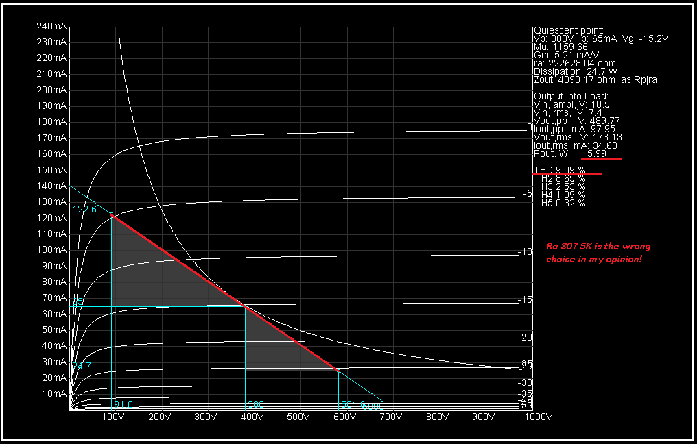

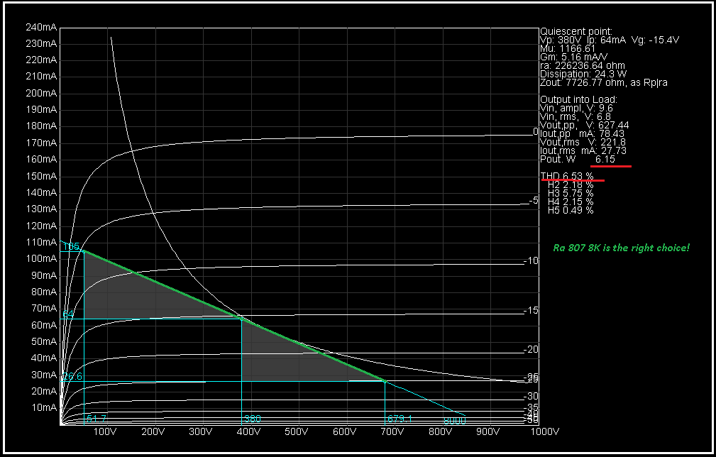

Http://6streetbridge.blogspot.ro/2012/11/project-command-1625-tube-amplifier.html project here, is something very beautiful, but in my opinion I think that the choice of R = 5K is a poor choice, but with R = 8K would be the best load on the power supply.
Major differences between the two graphs same static operating point tubevacuum 807.

It depends. According to your analysis, Ra = 8k results in slightly (neglegible!) more Output power @ less THD, which mainly consists of H3 distortion. 5k gives more THD with more H2 than H3, which may sound more pleasant to some ears.
Best regards!
Quite rightly you say, I looked Electric, audiophiles is somewhat difficult to understand
and very subjective in the end.
Best regards!
