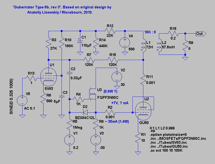

Instead of 811 you can use GU-50 connecting all grids together. Great tube, but as cheap as a dirt!
http://www.wavebourn.com/forum/download.php?id=491&f=7
I wish keep Triode, Thanks for Help;Instead of 811 you can use GU-50 connecting all grids together. Great tube, but as cheap as a dirt!

It is "right handed triode" connection, exactly like 811! All grids are connected together, as one grid! 🙂
