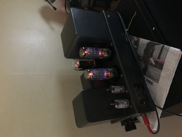

Yeah, these are of superior construction, due to the lack of that old pinch stem. But they won't equal a 6L6GC, 'cause plate dissipation is lower.
Another more modern derivative is the 5933, which even features the UX-5 base, but also lacks the pinch stem.

Here they are, substituting for KT66 in a Quad 2. I am using a 5R4GYB rectifier, so B+ is reduced to 318v, and they are biased at 22.5v, with a separate cathode bias resistor of 390ohms. I’m wondering about the screens, which will be seeing nearly 300V. It is hard to work out if that is an issue because there are not a lot of data sheets for these tubes. They sound OK though!
