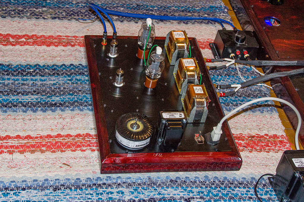

I am listening to the 807 -->6J51P amp with anode anode feedback, I just built.
Trying to compare it with my EL36SE amp,I think the 807 is as good or even better...🙂
It is a little brighter in a good way.I havent done any mesaurements yet,as I am rebuilding my PC.
Oh the driver is Pentode mode.
It is brighter but it also have deep bass.
Very nice job on the chassis Ake!

Do you can assign the various transformers?I am listening to the 807 -->6J51P amp with anode anode feedback, I just built.
The transformers are Lundahls,the opt are LL1663 the choke are LL1673 and then theres a choke from hammond the black tall one.
Is from Transformatory toroidalne - Producent transformatorow Toroidy.pl custommade.
At first I planned to use the 807 triodconnected so I wind the trafo for about 500v DC but now I´m using 350v tetrode mode (250v g2).So i´m using a very small (2uF) cap before choke 1,so i get about 350v under load.

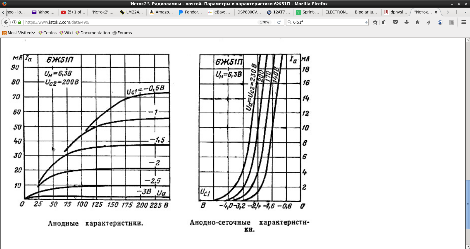

I triodconnected the 6J51P but the sound was to dark and lifeless,so I thought I try the 6P15P triodconnected,I know people talked about it before in this thread I think.
And to my surprise it sounds quite good!The inputsensetivity is lower but I will manage.I have not yet decided if I should try it in pentodemode...
The anode to anode feedback is now 150K.

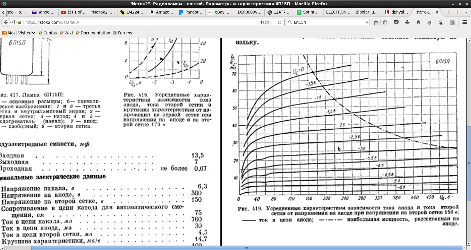

6J51P wants more voltage, 6P15P can deliver more of linear current. Actual load is anode load resistor in parallel with input resistance of the output stage that in your case is 150k divided by voltage amplification factor of your output stage. You do not want low non-linear internal resistance of the driver tube in triode mode to be effectively in parallel with the anode resistor that is in the voltage divider for the local feedback loop, so better use it in pentode mode.

I am now using 6P15P in pentodemode,its good but not the best,the treble is to low..
When I tried 6J51P I forgott that I have a potentiometer on the treblespeaker to use...
Else I have the 6J49P any one tried it?
How much does it want?I belive I used about 170v...6J51P wants more voltage
