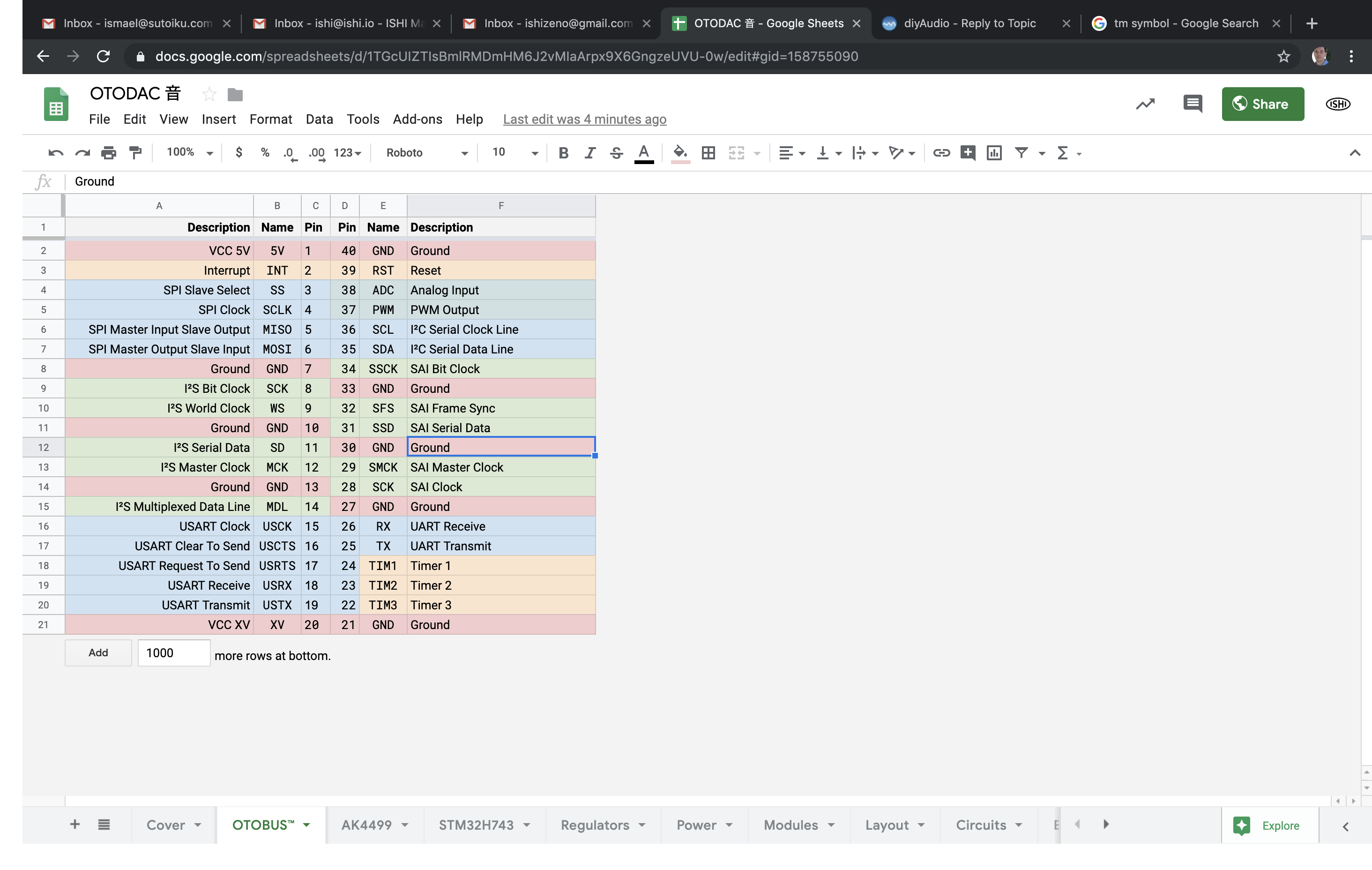

Redesigned OTOBUS™
Following the advice of a reader, I have redesigned the OTOBUS™ in order to provide more ground return circuits for the parts of the bus that matter most: the I²S and SAI interface. There, every single circuit is just a pin away from a ground return pin, and sometimes to adjacent pins are available for ground returns.
This came at a cost though: all the power supply lines at the exception of 5V had to go. This design was motivated by the fact that most bricks will be perfectly happy with 5V, and the ones that are not (DAC and ADC bricks for example) will need very specific power levels. Therefore, there really wasn't much sense trying to back that into the core OTOBUS™ architecture.
Instead, we're much better off leaving that to the brick, simply providing enough current through multiple 5V lines. As a result, the OTOBUS™ has two 5V line, and knowing that every brick comes with two OTOBUS™ connectors, this gives us 4 lines in total for every brick. And knowing that the ERF8/ERM8 connectors used for the OTOBUS™ are rated at 2.2A per pin with 2 pins powered, that gives us a theoretical total of 8.8A per brick. Furthermore, the DAC brick is a 3 OTO™ unit brick, therefore could get a theoretical total of 26.4A. Clearly, we will never get anywhere close to that...

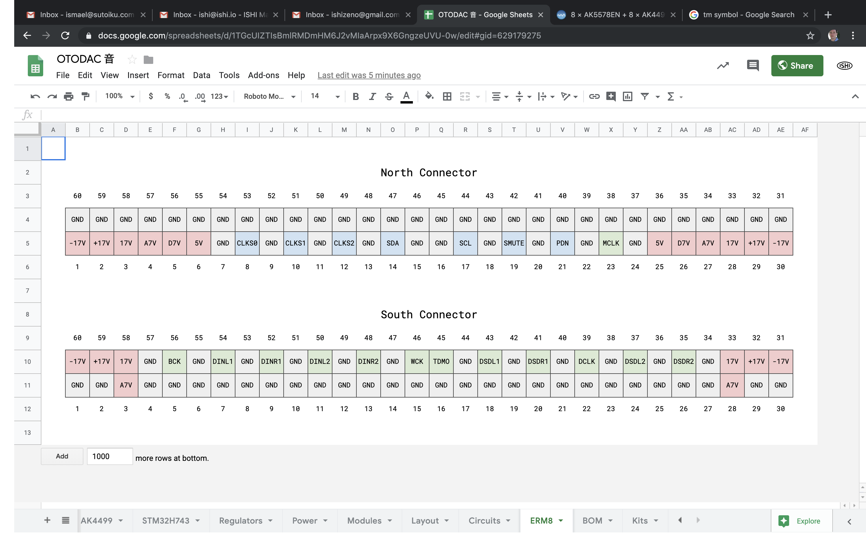

Connectors for DAC Board
I have done a detailed analysis of the logic and signal pins that we need to handle on the AK4499. Nine of them can be hardwired. The others will need to be driven by the MCU. This allowed me to create this list of circuits that need to be handled by the connectors going from the DAC board to the interface board, which will play a dual role: interface to the MCU board (what is called the "Plate Board") and first-stage power regulation (feeding from the USB's 5V). On the power side, the set of required circuits was driven from this power supply design.
Taking all that into consideration and looking at the pinout for the AK4499 DAC chip, I designed the pinouts for the two ERM8 connectors that will connect the DAC board to the interface board. And because we need much less pins that originally thought, I got rid of the two UMPT connectors, and I made sure to provide as many ground return circuits as possible.
I dedicated three pins for clock selection. One will be used to select the clock frequency, another to select clock division, and the third to by-pass the built-in clock and feed from an external clock. The MCLK pin on the North connector will feed whichever clock is selected back to the interface board.
Most power circuits have been doubled in order to spread their loads and get some level of redundancy. Knowing that we have so many pins dedicated to ground returns, I wonder if some of them could be used to double some logic and signal pins as well. I assume that doing so for digital signal circuits could induce some unwanted jitter, but I'd love to get some confirmation on that.

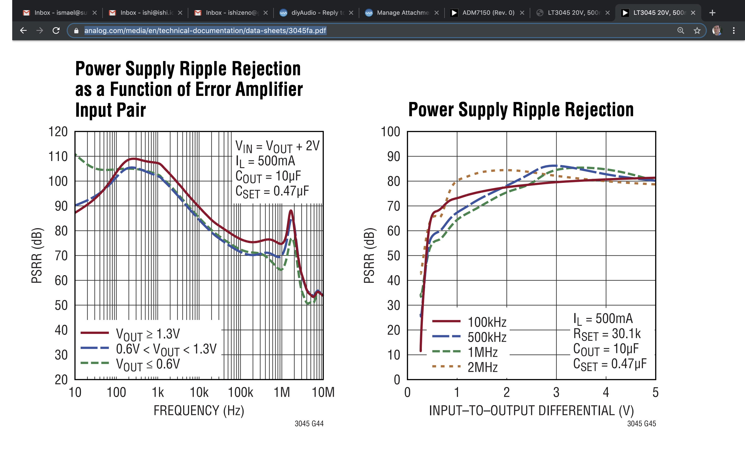

Yes, there is a reason for going higher. LDO regulation is better with a higher delta, but there is a limit to that. That's true for other linear regulators as well.
IME (in my experience), using ADM7150 to produce 3.3v with 5v input resulted in less than optimal regulation. IMHO, 7v was sufficient. I only suggest 8v to allow some tolerance. For ADM7150, the data sheet page 11 shows PSRR (power supply rejection ratio) vs input headroom, but PSRR may not be the whole story. I could hear a difference using ADM7150 for 3.3v AVCC as input voltage was adjusted, and distortion from the regulator didn't seem to level out until about 7v input. That amounts to 3.7v of headroom. Above 7v I could not hear any further improvement. In the event anyone claims I am imagining things, I still have the regulators and you can test them for AVCC yourself. You may also want to consider the implications if 5v output were to be needed.
Got it!
The LT3045 datasheet does not have as many charts for PSRR analysis. These two charts on page 10 suggest that 2V might be a sweet spot (high enough to provide good performance, but low enough to keep dissipation as low as possible).

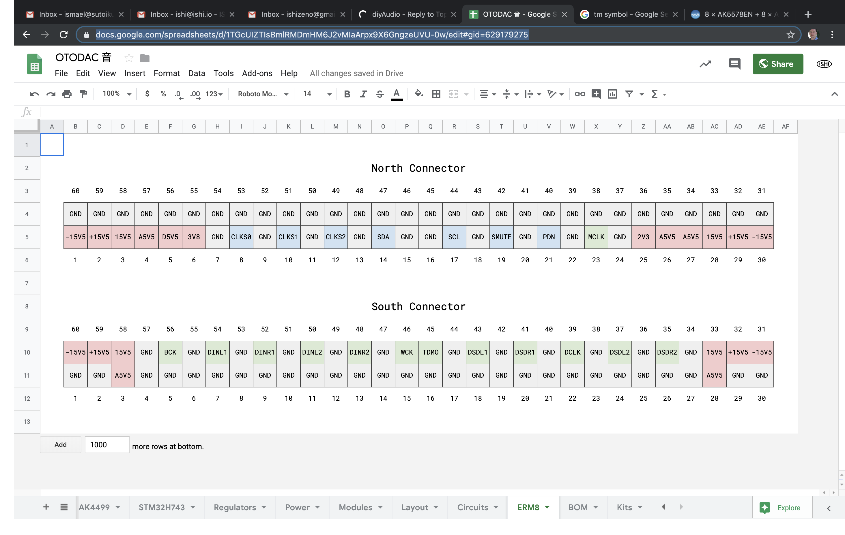

I've updated the power scheme, circuits, and connectors accordingly.

Updated Power Supply Architecture
Just to clarify, based on the previous discussions, I think we can simplify our PSU board and only use 3 × LTM8045 and 2 × LTM8049:
- 1 × LTM8045 to boost 5V to 7V for analog components
- 1 × LTM8045 to boost 5V to 7V for digital components
- 1 × LTM8045 to boost 5V to 17V
- 2 × LTM8045 to boost 5V to ±17V
From there, the PSU board would provide the following supplies (Cf. Circuits):
- 5V
- A7V
- D7V
- 17V
- +17V
- -17V
And here is what the new connector pinouts would look like.
Since everything gets regulated again on the DAC board, I'm not sure that we need separate first-stage regulators for 7V though, and maybe we can save one LTM8045. Any strong opinions on the matter?

Improved OTOBUS™
This might be an insignificant change, but I've moved things around on the OTOBUS™ in order to get the critical I²S and SAI interfaces in the center of the connector, away from the power supply lines, which are located on the edges.
