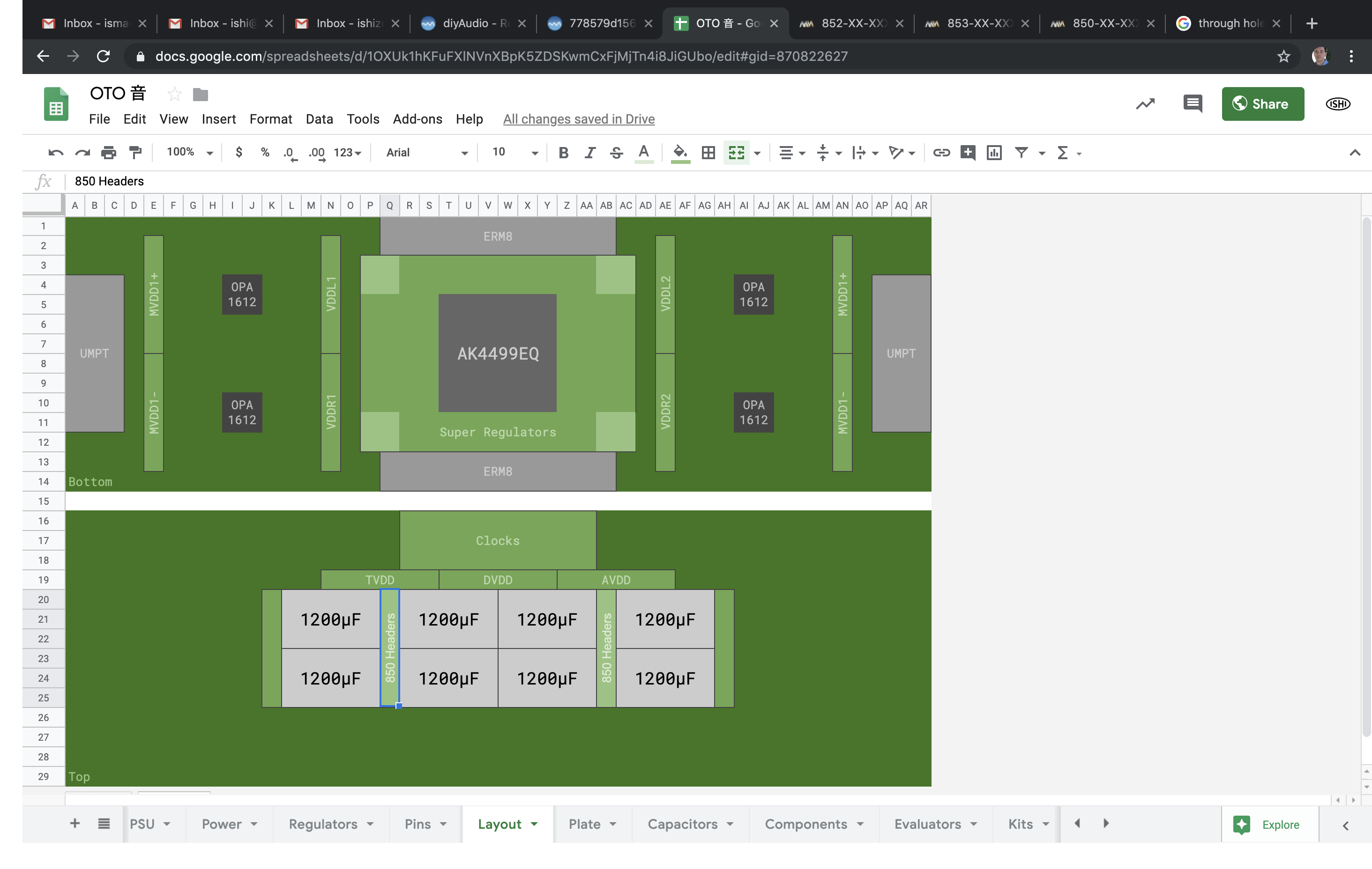

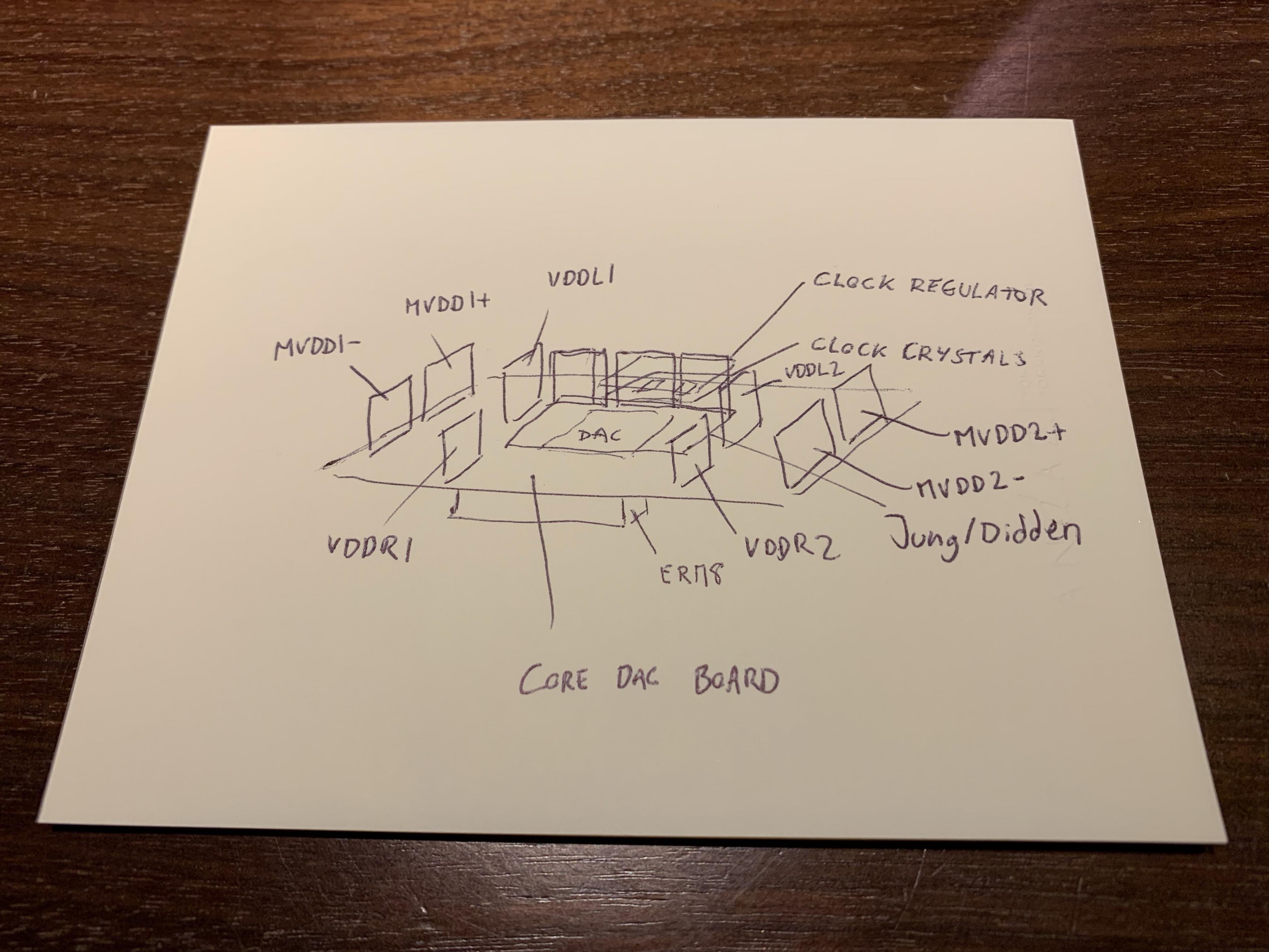

Modular DAC Architecture
Here is what I have in mind regarding the modular architecture for our DAC.
The core DAC board is a 110mm × 35mm board, probably 10 or 12 layers. The AK4499EQ DAC chip sits right in the middle of the top layer. Laying on top of it is a board with four Jung/Didden Super Regulator circuits for the four VREF supplies. This board will be mounted on top of the core DAC board using four sets of 4-pin 852/853 machined pin headers and sockets located very close to their associated pins on the DAC chip. A 16V to 15V LT3042 regulator board (not shown) will lay flat on top of it in order to provide the 15V supply needed by the four AD825 operational amplifiers.
On the bottom of the board, we have two ERM8 connectors (North and South) for digital and analog signals, and two UMPT connectors (East and West, not shown) for power. These connectors allow the DAC board to be mounted on an OTOBUS™ interface board. This board is itself connected to the Plate Board (via two sets of ERM8/ERF8 connectors), which will have the LTM804X µModules and the STM32H743 MCU (with USB interface and Thesycon U-HEAR driver).
Immediately on the North side of the DAC chip are three regulator boards mounted vertically for AVDD (5V), DVDD (1.8V), and TVDD (3.3V). These boards will be mounted in such a way that the traces leading to the respective AVDD (pin 107), DVDD (pin 109), and TVDD (pin 111) pins on the core DAC board are kept as short as possible.
Right behind them is the Clock board, laying flat, on the opposite side of the North-side ERM8 connector. Because the NZ2520SDA crystals are so small (2.5mm × 2mm), it should have no problem fitting all the necessary components. Laying on top of it is an LT3042 regulator board, but with a slightly different form factor than our regular regulator board. The Clock board will use a pair of SMP coaxial connectors with a bullet linking them for the output clock signal, plus a set of 852/853 pin header and socket for power and clock selection. The SMP connector mounted on the board will be very close to the MLCK pin on the DAC chip. The placement of that connector will take priority over the traces for AVDD, DVDD, and TVDD (the four pins are right next to each other on the DAC chip, with DVSS between DVDD and TVDD).
On the West and East sides of the DAC chip are four 5.5V to 5V LT3042 regulator boards mounted vertically for VDDL1, VDDR1, VDDL2, and VDDR2.
Finally, on the far West and far East sides of the core DAC board are two +16V to +15V LT3045 and -16V to -16V LT3094 regulator boards also mounted vertically for MVDD1+, MVDD1-, MVDD2+, and MVDD2-.
This arrangement should leave plenty of room on the core DAC board for all the large capacitors that need to be added, especially on the bottom side of the board (all regulator boards will be mounted on the top side).
The connectors linking the core DAC board to the XLR board to be mounted on top of it have yet to be selected. This selection will be largely influenced by the height of the vertically-mounted regulator boards, which itself will be defined once some PCB layout has been done for them (I'm in Japan right now, away from my EDA workstation).
Nobody has made any comments on this design so far, and I'm really curious to know whether this is a viable approach, or whether this is a dead end (keeping in mind all the constraints that we are trying to deal with of course).
An alternative approach would consist in putting the ERM8 and UMPT connectors on the same side as the DAC chip, alongside the regulator boards. This would allow us to avoid using vias for all the digital signal and power circuits. And since the shielded versions of the ERF8/ERM8 connectors are available with 16mm mating height, it would still leave plenty of room for the vertically-mounted regulator board.
Also, it means that the Clock board would be on the opposite side of the DAC board (DAC chip at the bottom, Clock board on top), and the use of through-hole SMP connectors would ensure that our clock signal does not go through any via.
This is probably a much better option.

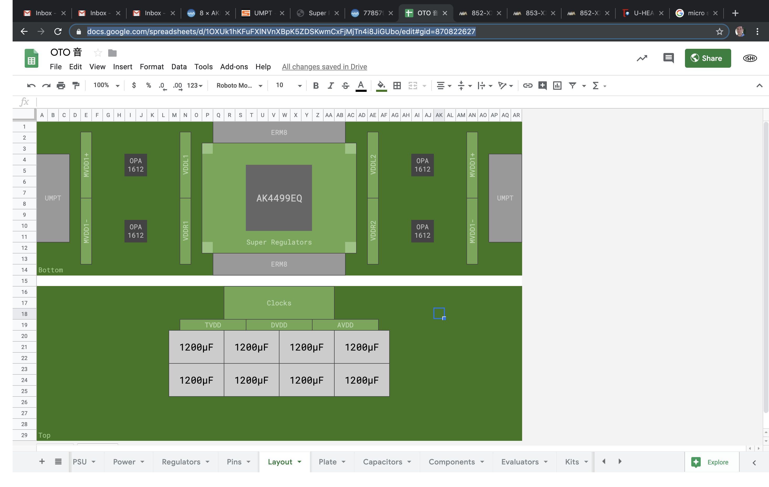

DAC Board Layout
Here is what the layout for the modular DAC board could look like (bottom and top layers). Lighter green areas outline modular boards (regulator modules, super regulator board, and clock board), some vertically-mounted (regulator modules), and some horizontally-mounted (super regulator board, and clock board).
This is crazy, but I kinda like it...
Large Capacitors
We've had so many discussions about the large capacitors that I think we should mount them on their own mezzanine board as well, as illustrated here. We would use 850 through-hole machined pin headers to ensure proper connectivity. This design would facilitate the testing of different capacitors and different capacitor combinations. For example, I am wondering how a pair of 1,200µF electrolytic capacitors would compare to a set of one 1,200µF electrolytic and one 580µF hybrid capacitor (the one recommended by Chris — Panasonic Conductive Polymer Hybrid Aluminum Electrolytic Capacitors), or to a pair of 580µF hybrid capacitors.
The more I am thinking about this modular architecture, the more I believe that it could provide a really powerful platform for prototyping products of that nature. The final product might need to consolidate everything onto a single board in order to reduce BOM and manufacturing costs, but leveraging a pre-existing collection of regulator boards and other sub-assemblies should make prototyping a lot easier and a lot faster.
We've had so many discussions about the large capacitors that I think we should mount them on their own mezzanine board as well...
