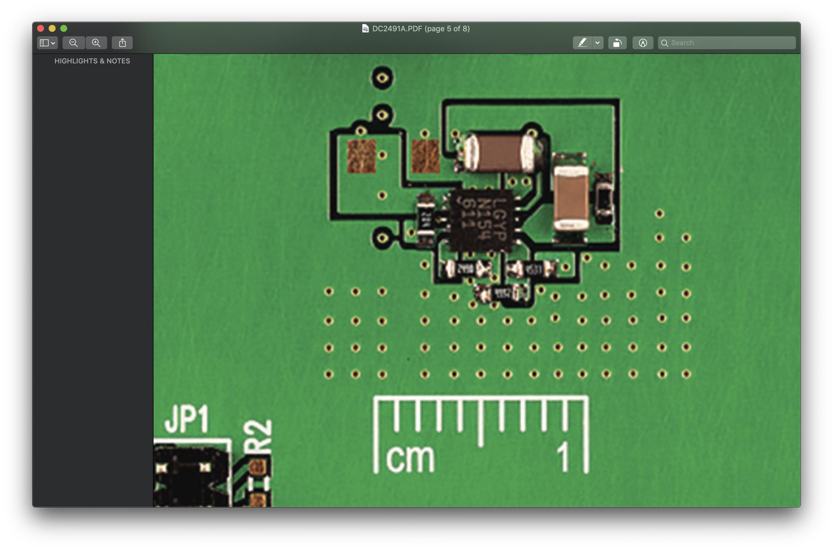

If we really want to bring all the LDOs as close to their targets on the DAC board as possible, an alternative option would be to develop subminiature versions of these regulator boards. Based on earlier work, we need 8 × LT3042, 2 × LT3045, and 2 × LT3094, plus 4 × Jung/Didden regulators (Cf. Power Analysis).
Each LT30XX regulator could be mounted on a very small 10mm × 6mm PCB, using 0.050" headers like these. With such a design, the output capacitor of the regulator would not be more than 4 or 5mm from its target. And because we are using ERF8/ERM8 connectors with a 16mm mating height, we would have no problems mounting these regulator boards vertically, parallel to all our large electrolytic capacitors.
For the Jung/Didden regulator, we could have a mezzanine board that would be mounted right on top of the DAC chip, using straight 0.050" headers that would be soldered really close to the DAC's pins.
Doing so, we would get rid of the DAC PSU board entirely, leaving only the Plate PSU board with its LT3045, LTM8045, and LTM8049 regulators.
This design would make it much easier to test different regulators and different regulation circuits for the different power supplies needed by the DAC chip.
And if we go down that path, I would suggest that we use four sets of ERF8/ERM8 connectors instead of two, cleanly separating signals from power. We would have North and South sets for signals, while adding West and East sets for power.
And if we're confident that we do not need capacitors larger than E12 (11.9mm height), we could use the UMPS/UMPT connectors for the West and East sides power connectors, because they're available with the same 12mm mating height as the ERF8/ERM8 connectors. Of course, this would prevent any component to be mounted on the Plate board opposite to the tall capacitors mounted at the bottom of the DAC board, but this should not be a problem.
Quite frankly, the more I am thinking about that design, the more I like it.

Here is what a regulator circuit looks like for the LT3045. Note the 1cm scale to see that it would fit within a 10mm × 6mm PCB, leaving a bit less than 6mm for the headers connecting the regulator board to the DAC board.
The 22μF CIN capacitor is not shown on the picture, but it could be mounted to the left of the regulator IC, therefore making the board 12mm to 13 wide. This should not be a problem though, because these regulator boards could be mounted parallel to each other on the DAC board.
If using that part, maybe better to use the low noise filter cap option at the programming input, and also enable fast startup mode.
I understand the fast start-up mode, but I can't find the "low noise filter cap option at the programming input" that you are referring to. Can you point me to a specific page on the datasheet? Thanks!

Reading your comments and the datasheet, I guess we should use a 22µF capacitor on CSET. LDOVR uses the T495C226K025ATE300 tantalum capacitor for CIN. Is it fair to assume that the same capacitor could be used for CSET as well?
The input cap should be ceramic or tantalum || ceramic. The SET pin cap could go either way. I would probably choose a ceramic cap there because I don't have much concern about piezoelectric effects in a stationary desktop device, but it is a concern at that node in general. The tantalum would be ok, but since the goal of the large cap is to lower LF noise, I wonder about the LF noise of tantalum and aluminum electrolytic caps here. I haven't found a ton of info or measurements except that it tends to follow DC leakage, so a 22 uF hybrid polymer Al electrolytic might be better than a tantalum. An interesting option, that I have never tried or tested, is an acrylic capacitor like the Rubycon PMLCAP. A bit large and limited to 16V, but it looks cool anyway:

It looks really cool indeed. It's also quite expensive... Would you consider it for CIN, CSET, or both?

Only CSET, which is the reference filter. The datasheet mentions the effect is negligible for input and output caps due to the PSRR and low output Z. I probably would just use a 22uF X7R myself. Another option that may be better than the tantalum (but larger) is the Al hybrid like I mentioned before:
EEH-ZC1V220R Panasonic Electronic Components | Capacitors | DigiKey
Actually, that particular tantalum they used probably has around the same leakage, but higher ESR. Since it's not a polymer tantalum, keep in mind it has to be derated by 50%.
