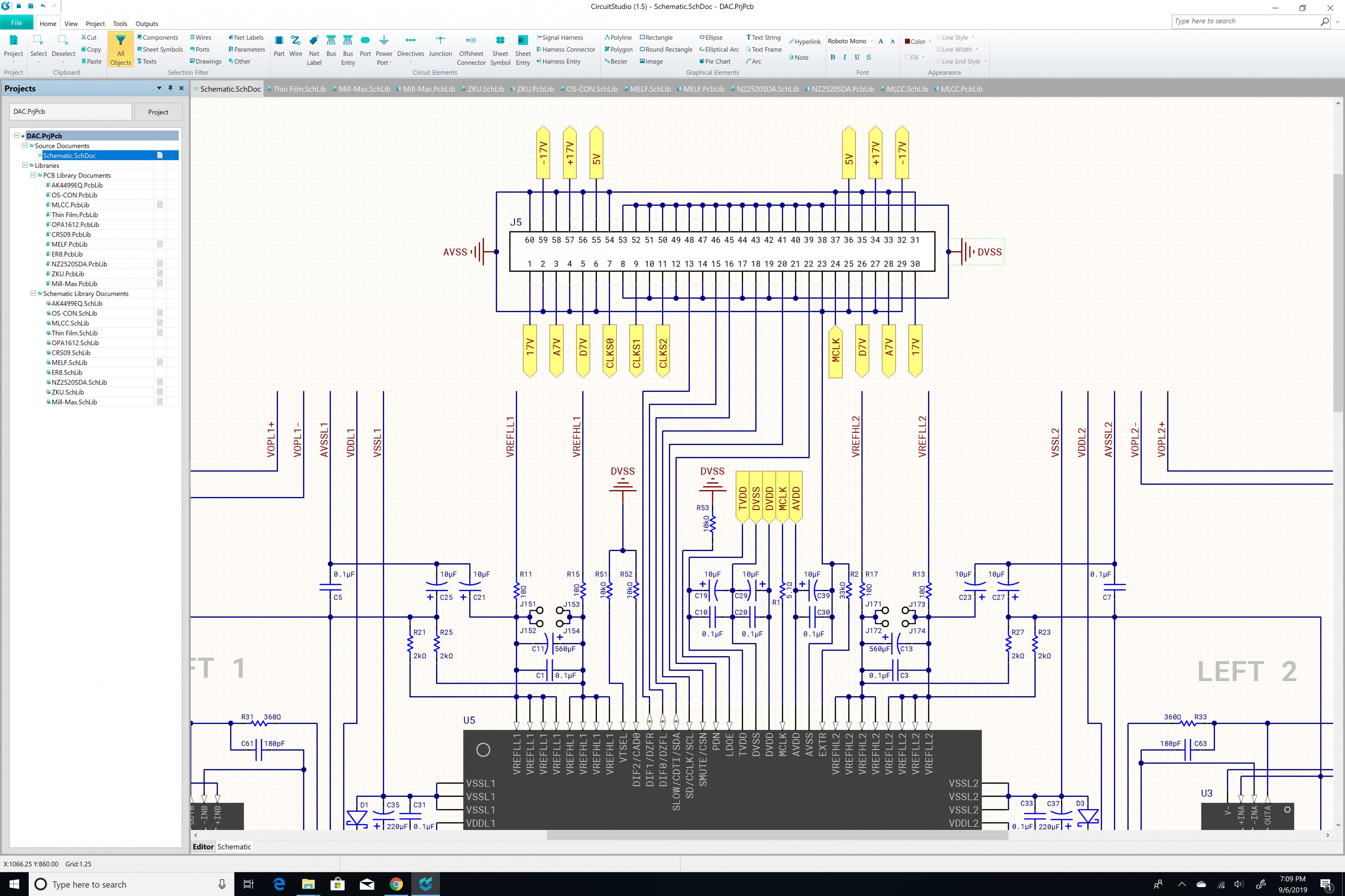

But what does it mean when we have an analog pin next to a digital pin on the connectors, with ground pins facing them on the other side of the connector? Do we connect one to the AVSS plane and the other to the DVSS plane like I did before you posted your reply? Should we revert to that design?
Checkpoint
Here is what the DAC's schematic looks like so far.
I'm now working on VREF.
Probably, it looks like AKM has done that, although there is only one DVSS connection on their entire header that I see at a quick glance.
Indeed, and that does not make much sense to me. The only reasonable explanation I can come up with is that it does not matter that much, but I can't see how what I am doing could hurt either...

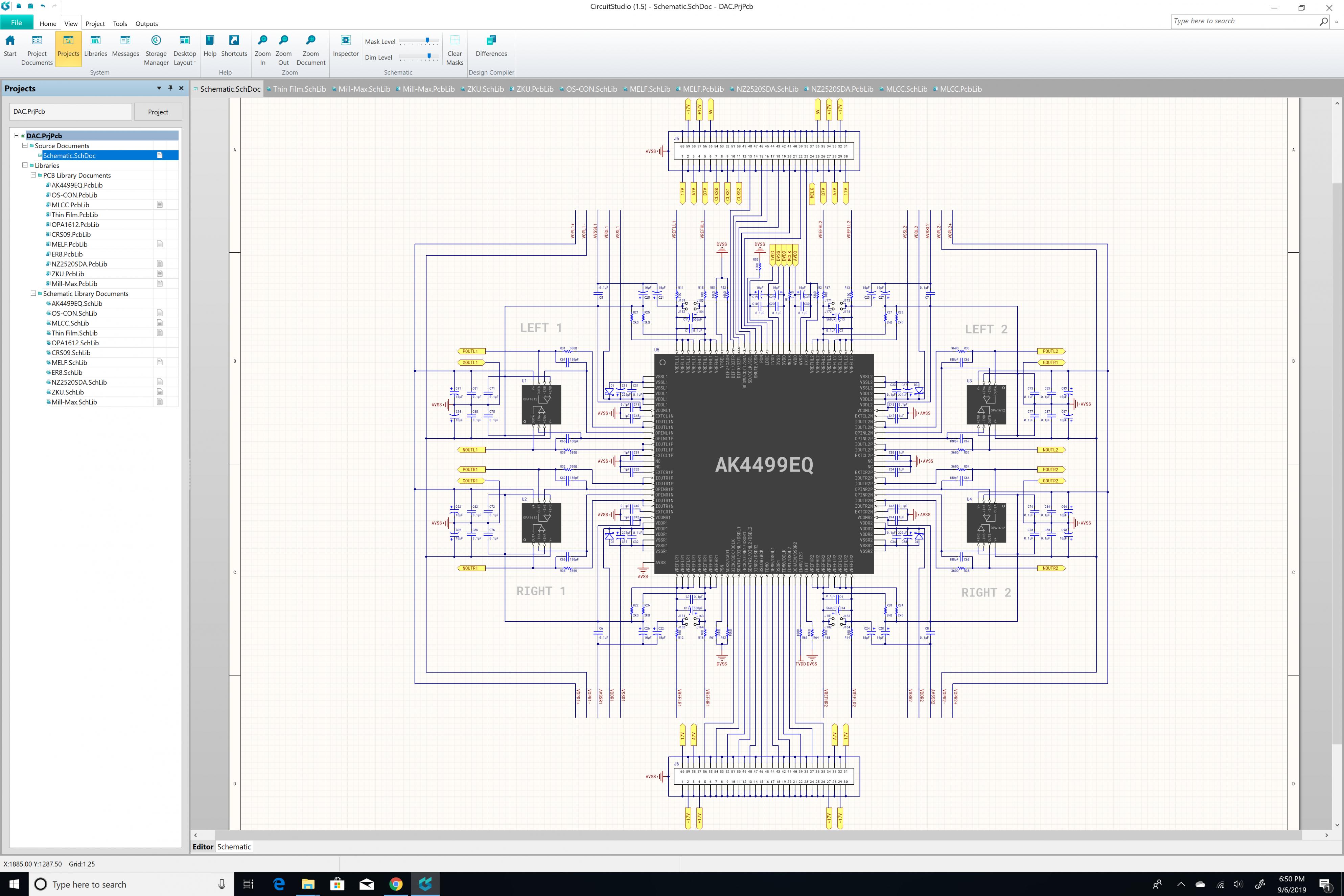

Here is the North side...
There seems to be a lot more art than science in a lot of this...
Which is probably a good thing for us mortal beings...
One of the books you are supposed to be reading is entitled, The Art of Electronics. That said, everything has an underlying physical basis at some level.
Could be you will encounter some things that we do not have fully developed research to understand as well as we would like. Could also be a demonstration will be waiting in Auburn for someday when you can visit.
