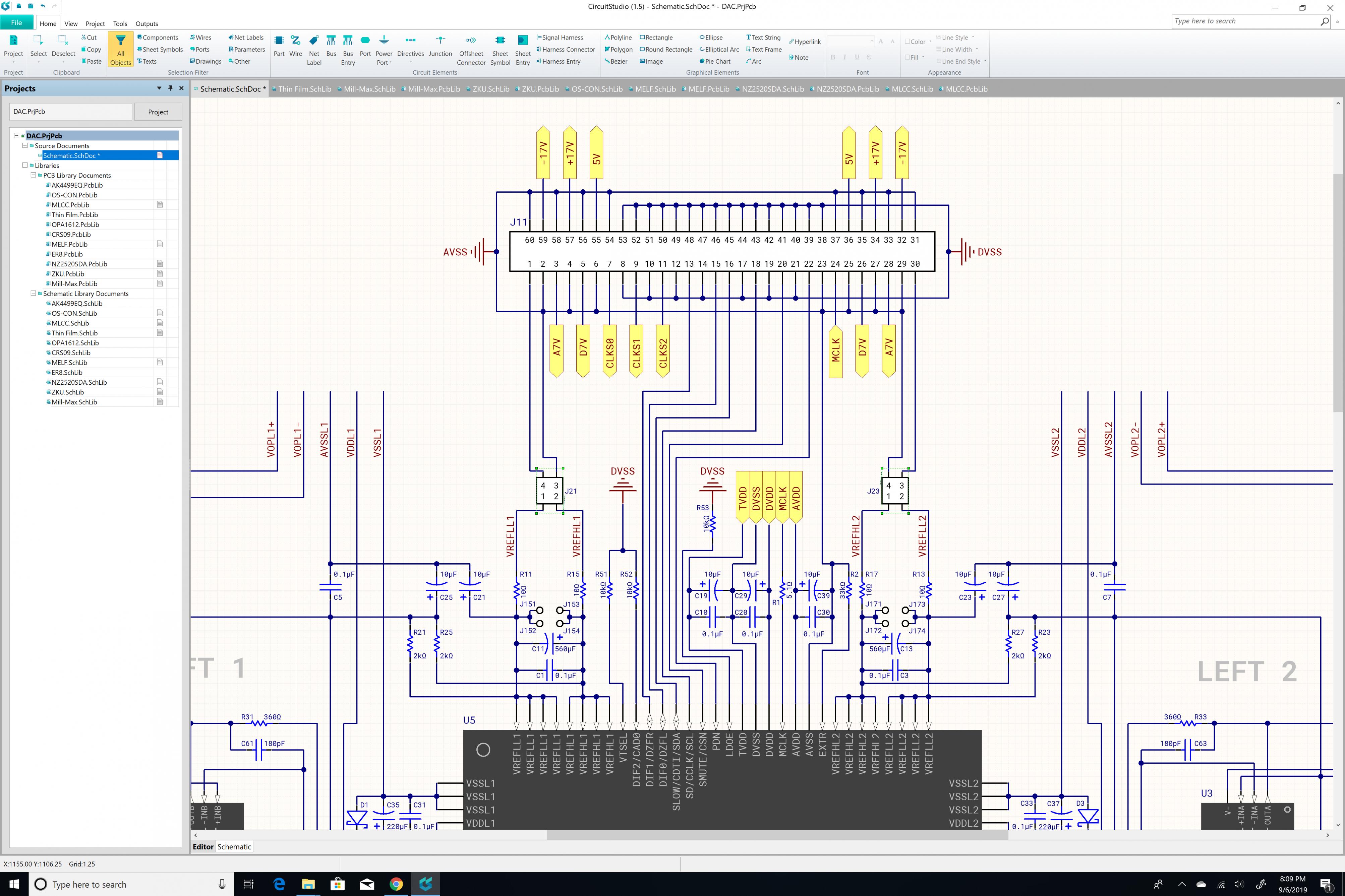

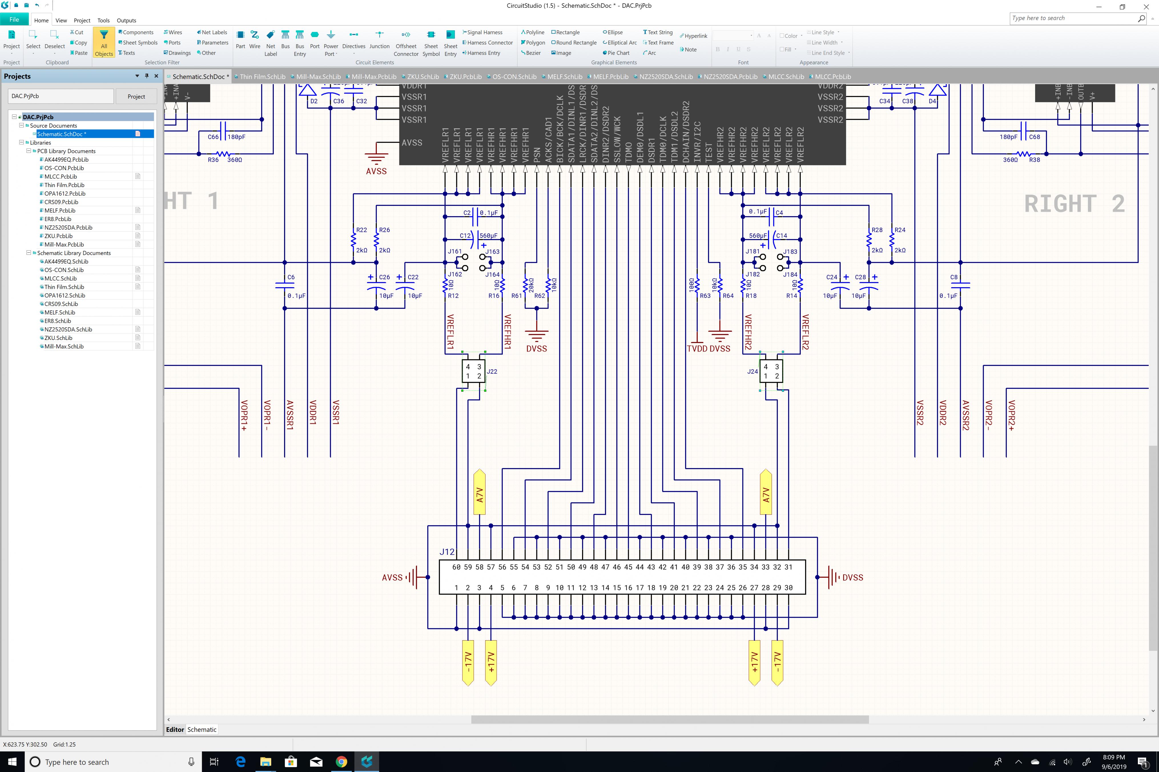

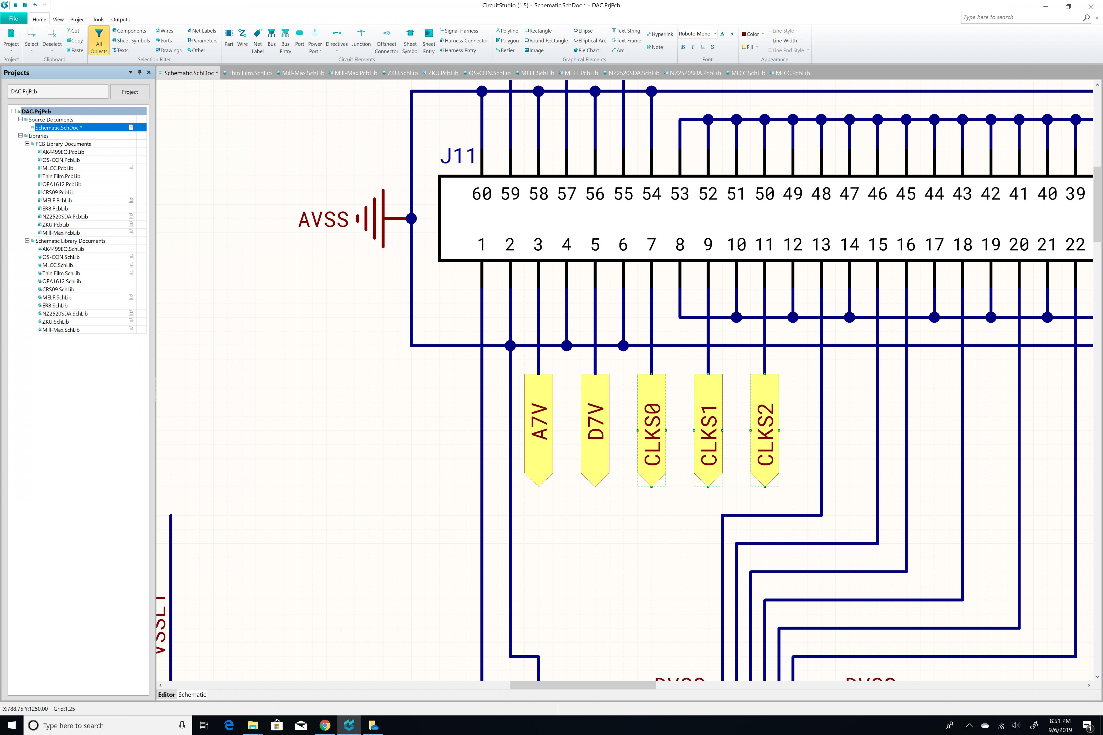

Updated PSU to DAC Connector Pair
Here is the updated connector pair between the PSU Board and the DAC Board.
In a totally-unexpected way, it's becoming more and more symmetrical.

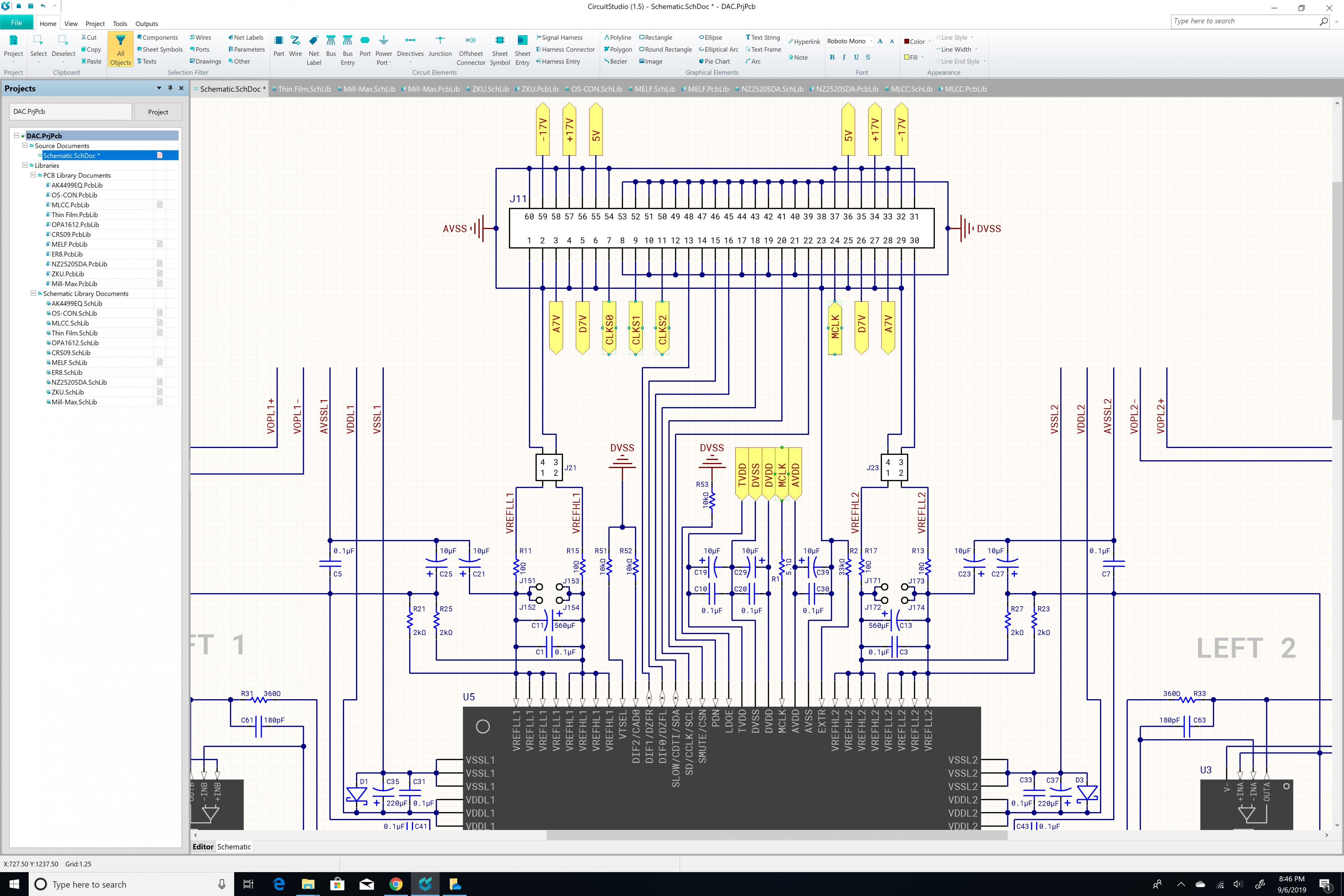

Connectors for Super Regulator Board
Here are the four connectors for the four corners of the 4-channel Super Regulator board. Currently, this assumes that the 17V to 15V regulation (with 1, 2, or 4 LT3042 LDOs) happens on the Super Regulator board itself. That being said, I think we could do it using four regulator boards mounted on the DAC board, really close to the four 4-pin sockets used to connect the Super Regulator board. This would allow us to reuse the LT3042 regulator boards that we will use for the rest of the DAC board. This change to the schematic should be really straightforward if we decide to go down that path.
Here is the updated connector pair..
All you need in the way of digital audio connections are the same as shown for Port 100 on page 3 of the eval board manual. I would suggest to try to lay them out on a connector as they do on the eval board.

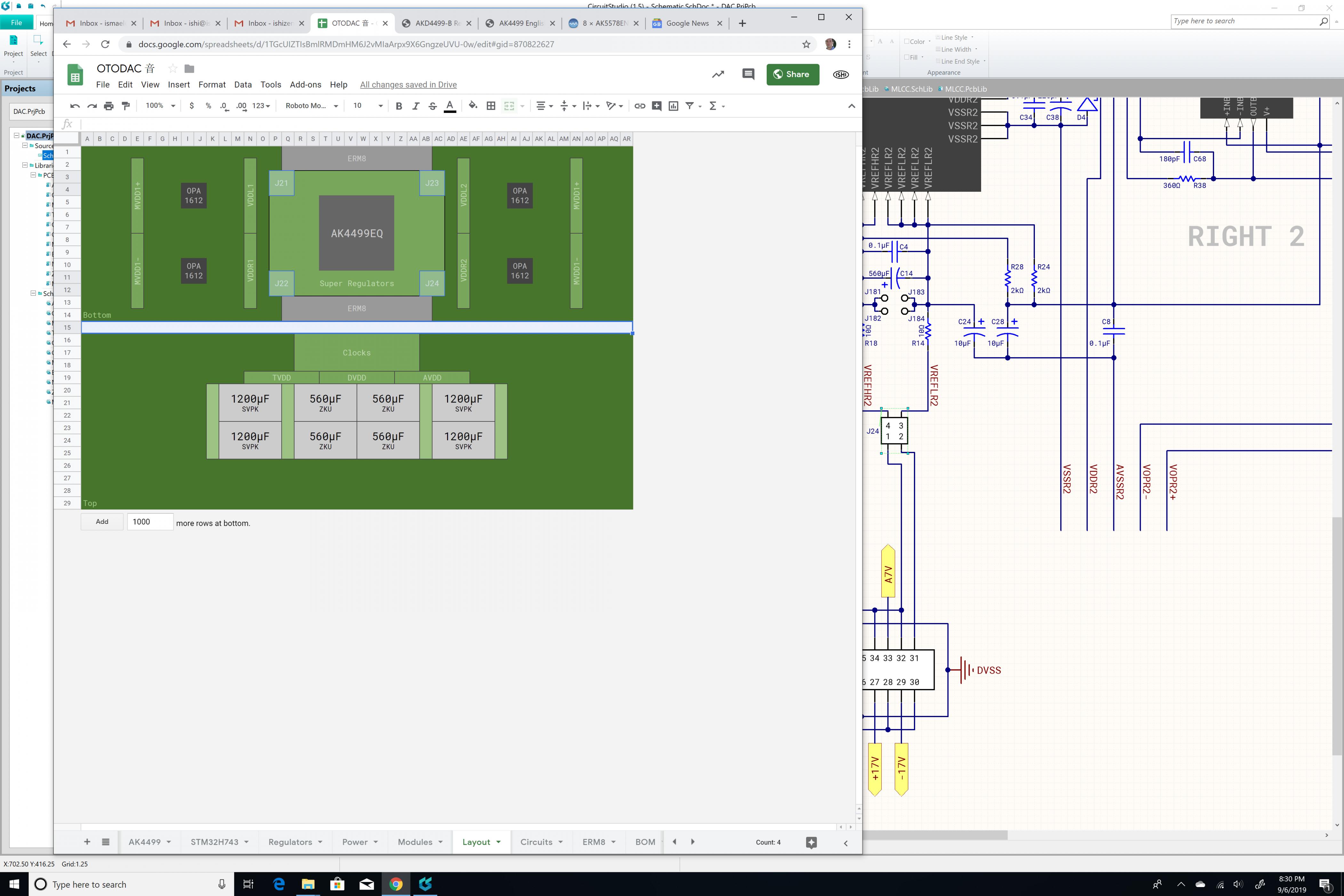

I don't think so. What my connectors are for is the mezzanine board that will have the four Jung/Didden Super Regulators, which are our alternative implementation for what is found on page 58. They will use the AD825 instead of the AD817. You can see J21..24 on this layout. Yes, I know, it's a lot of boards... But if we want the right level of power regulation within such a tight form factor, I do not know any way around it...
The Jung regulators don't need digital audio signals, in fact those signals should not be stubbed out to where they will not be used. It can only distort the RF waveforms.

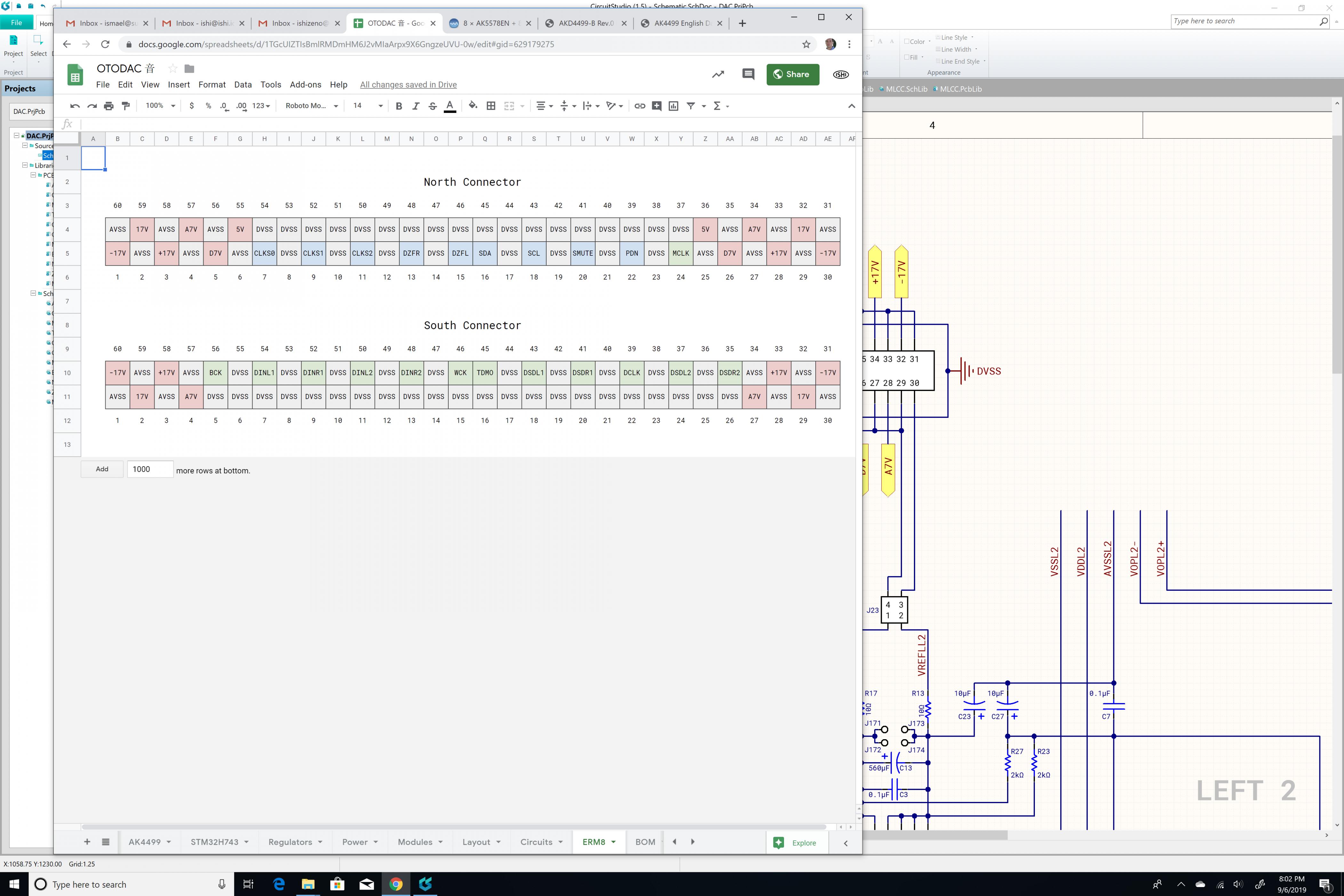

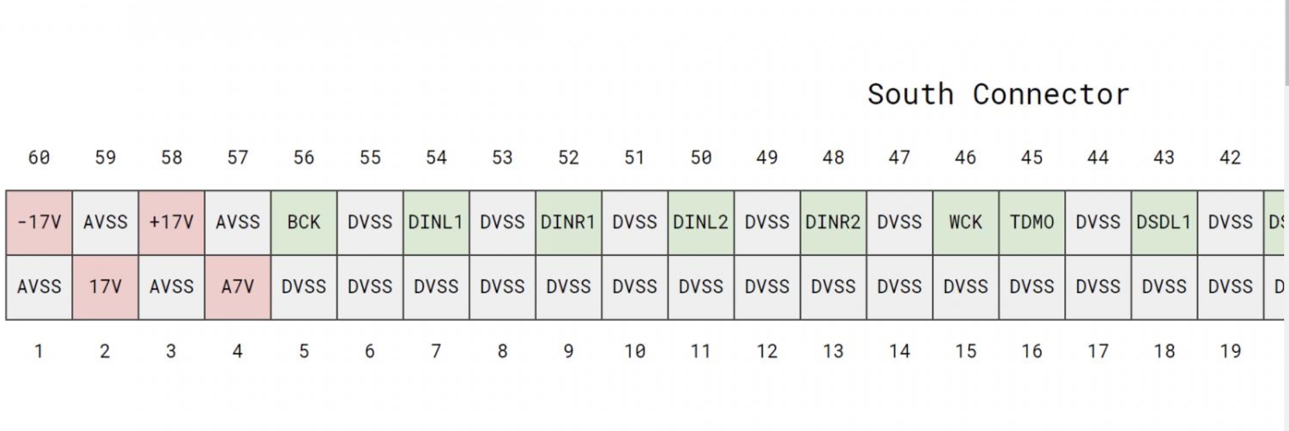

I was referring to all the green pins on the south connector. Where does that go?
If you have the crystal clocks there, that doesn't mean all those other signals come from there, they don't. They come from your USB interface.
You will need at least one signal to wherever the crystal clocks are to select the one to use. The number of signals depends on the number of clock frequency choices. The signal(s) will come from the USB interface. What have you named that signal or those signals?
Green pins? I see a lot of blue and yellow. But I might be color blind. Can you send an annotated screenshot by any chance? This would help clear any confusion. Thanks!
All the clock pins are on the North side, and I have yet to put the connectors for the clock mezzanine board. I hope to do that sometime tomorrow.
No green?
Oh, I see. Yes, these come from the PSU board, which has pass-through pins/circuits for USB circuits.
So, what about these?
I get it now!
CLKS0..2
CLKS0 to select the crystal.
CLKS1 to select division.
CLKS2 to select external clock.
All these come from the USB board (aka Plate), through the PSU board, then are sent to the Clock board.
The USB board connects to the power supply board before the dac board?
Hmmm. Where else to those clock lines go, to every possible module location on the plate?
That is a really good question!
My poor answer is "yes". And I realize that it might mean that we have an antenna problem.
Hmmm... I'll have to think about that one.
Thank you for bringing that one up Mark. This is really good stuff...
