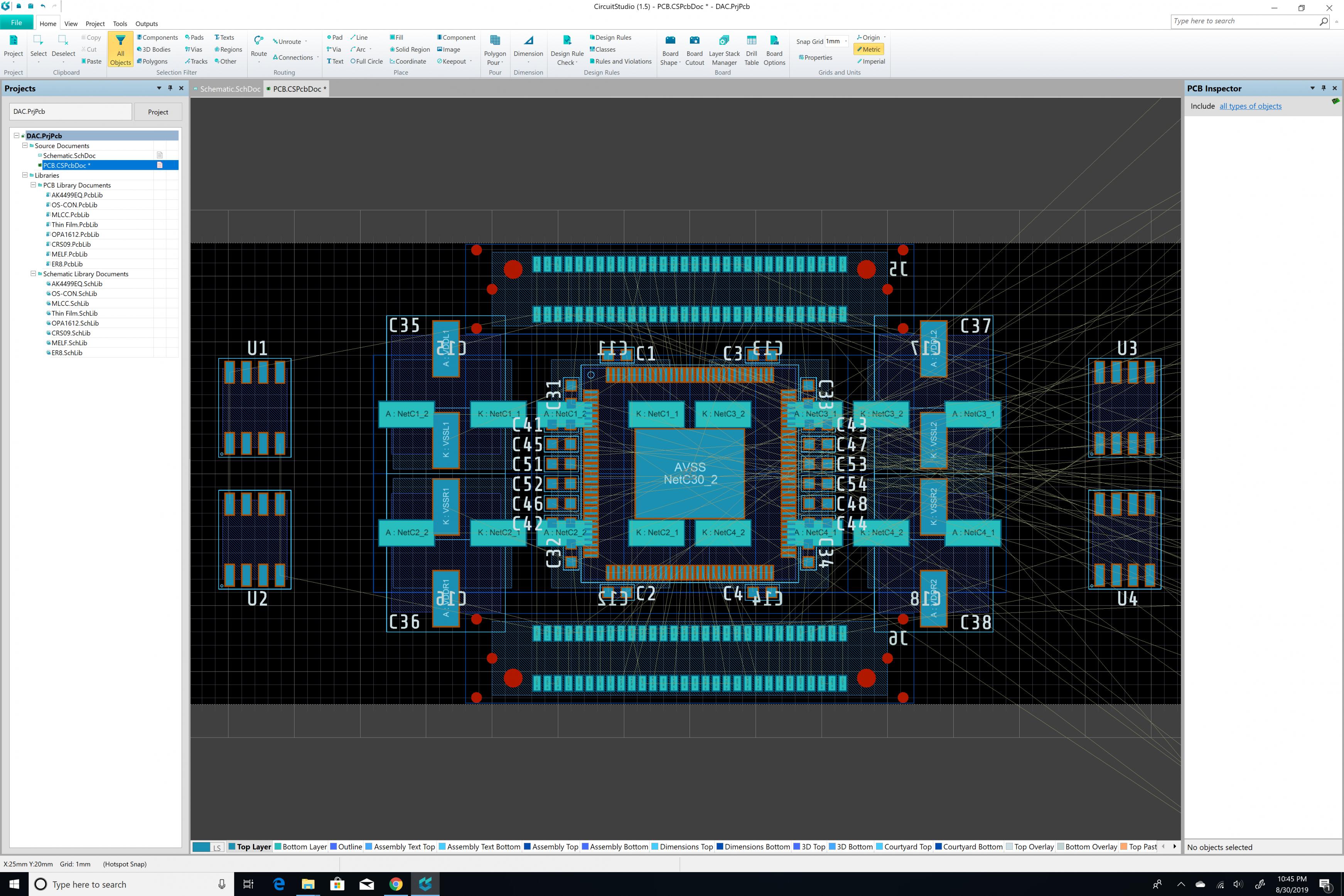

I don't think it's going to fit on a 2 × 1 board...
Here is what a 3 × 1 (110mm × 35mm) board looks like. This is probably a more realistic starting point...

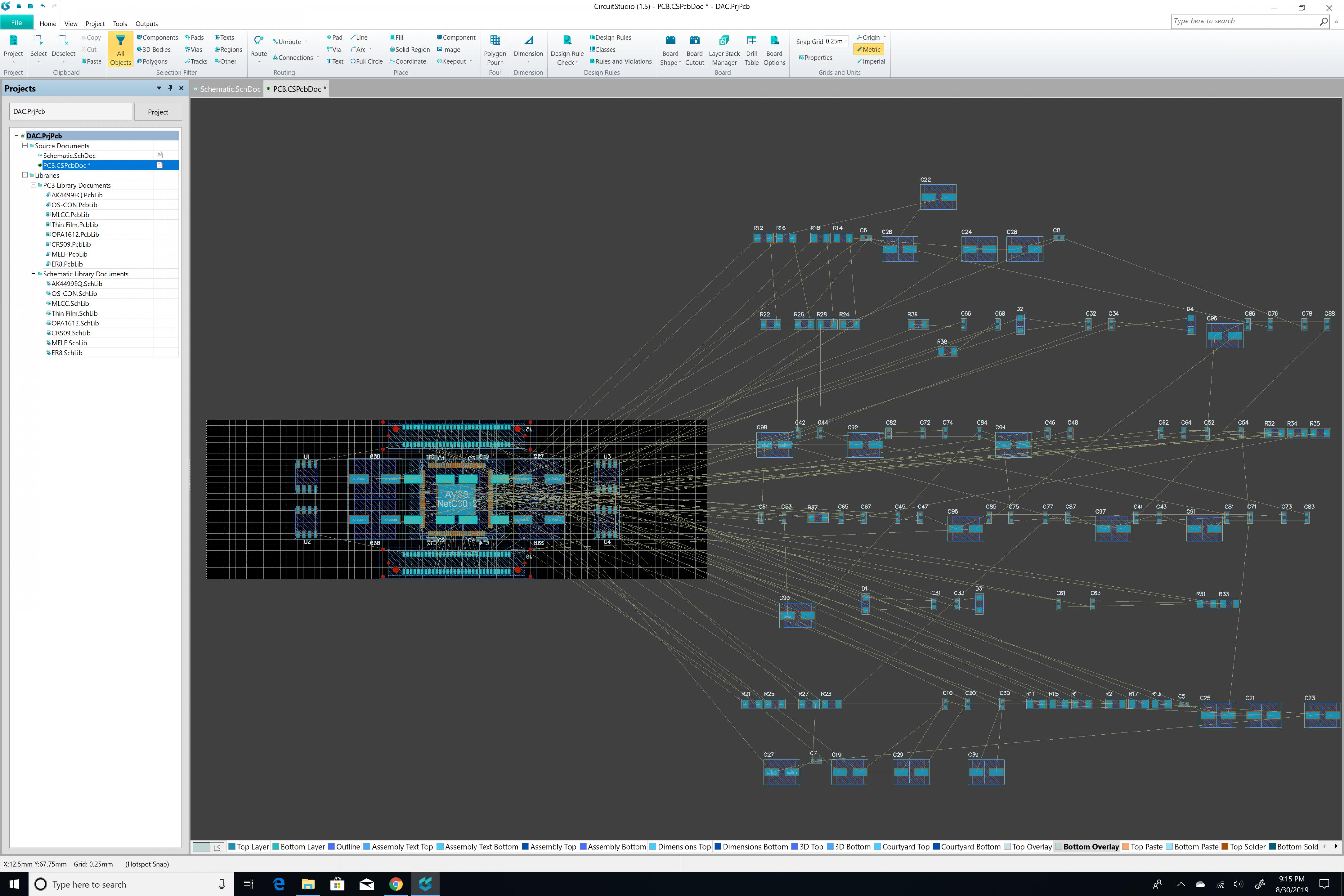

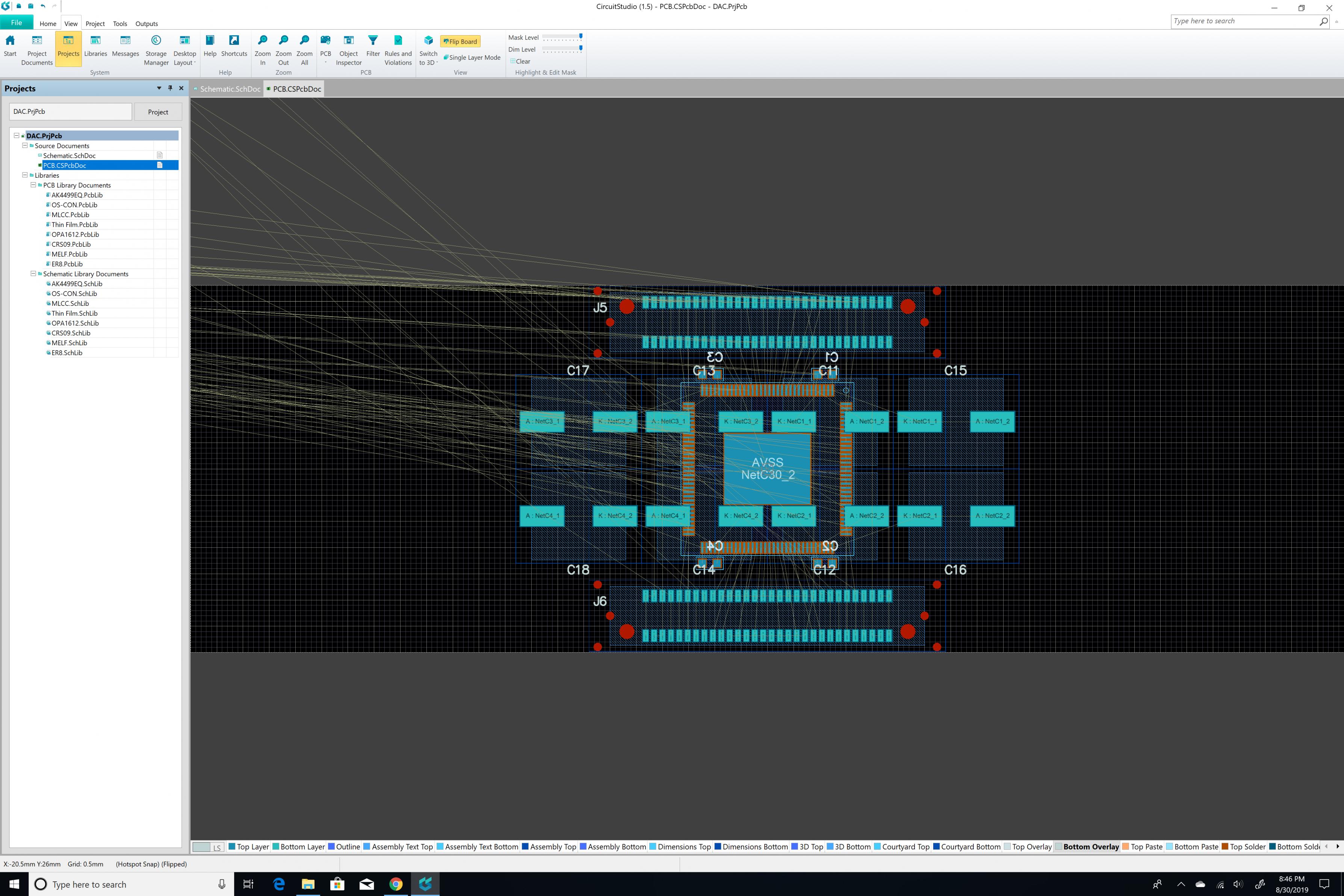

Monospace Font
Trying different monospace fonts for the overlay markings.
So far, Share Tech Mono is the best I could find.
Also, trying to keep all the low small capacitors as close to the DAC chip as possible...

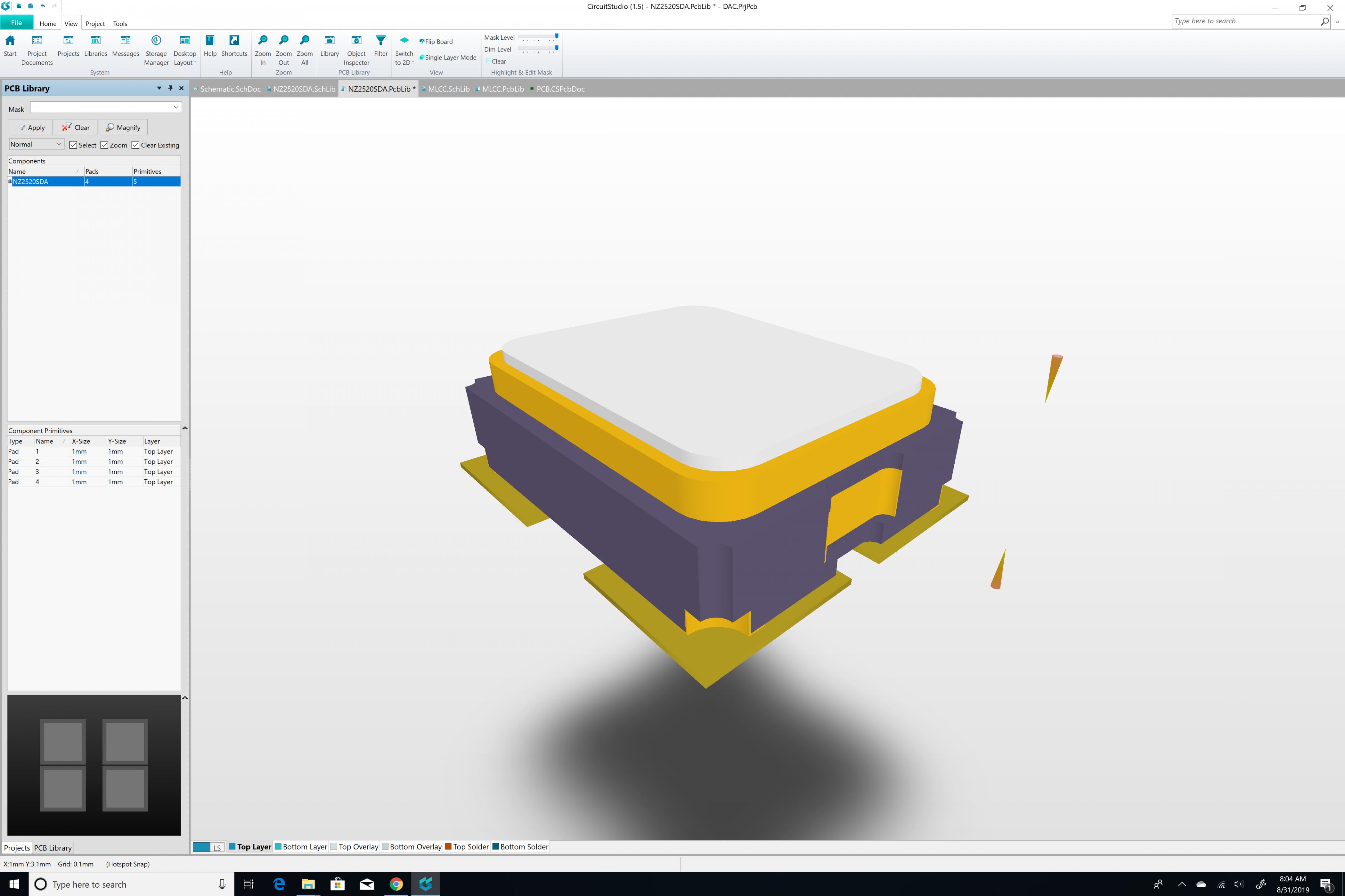

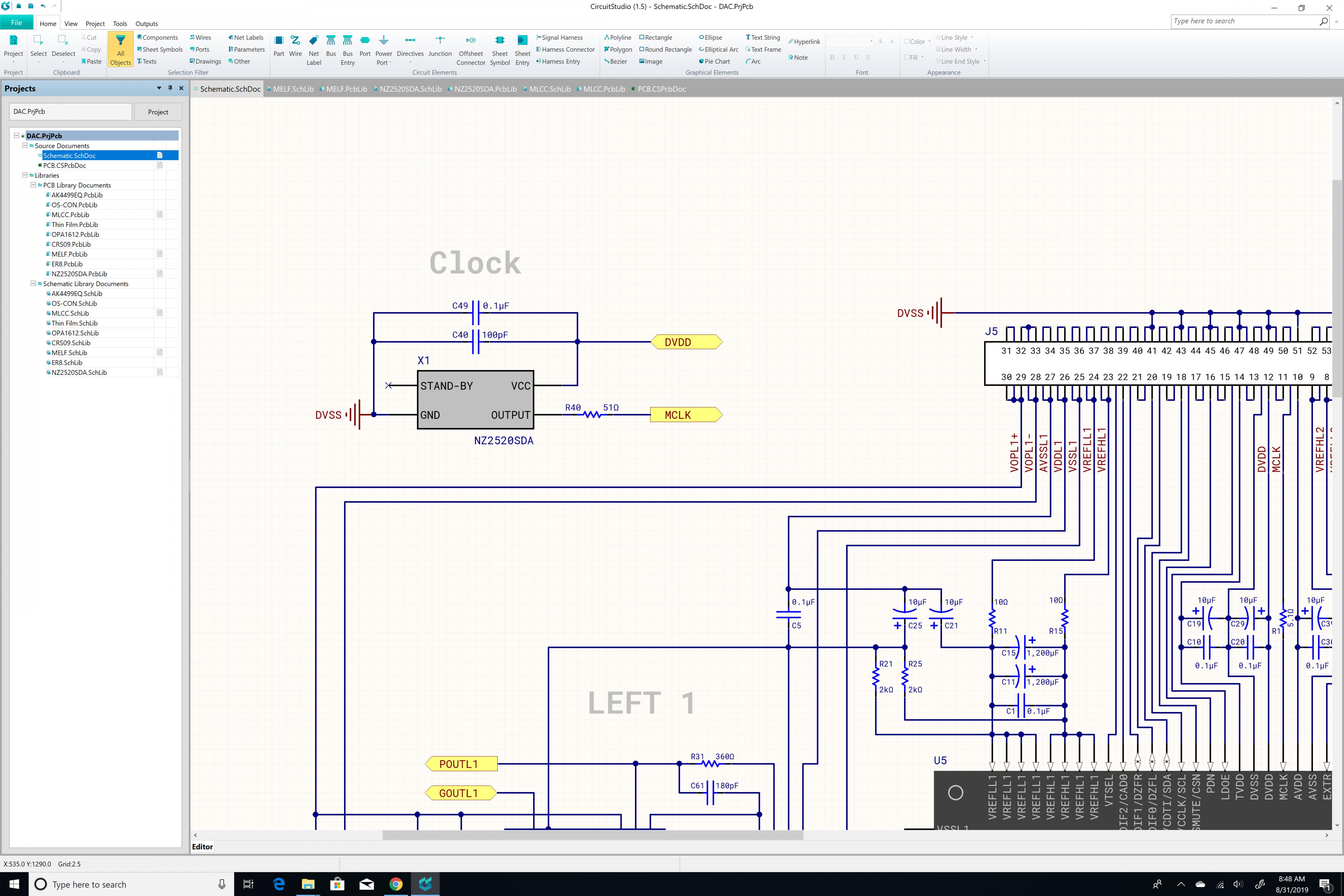

MCLK Circuit
I think I understand what the clock circuit should look like, but I am a bit confused about the output resistors. On page 55, we can see that we have a 51Ω (R1000) going from MCLK-DAC0 to MCLK, and on page 59 we have the famous 5.1Ω R1 going from the MCLK mezzanine pin to the MCLK DAC pin. Should both be mounted in series even if the clock is mounted much closer to the DAC chip than with the AKM reference board?

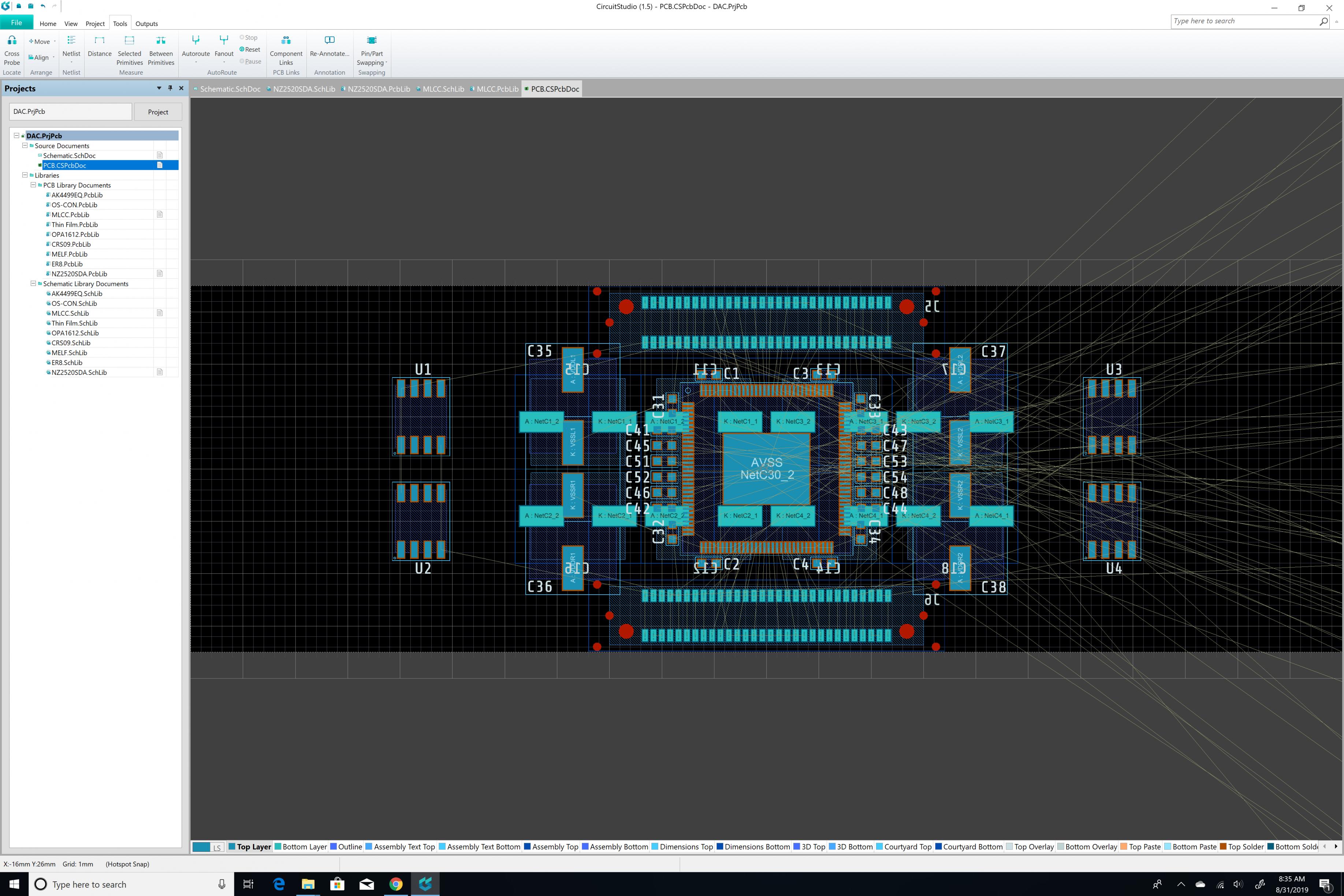

Non-Fool-Proof Connector Layout
This design for connectors is bad, because it does not prevent the incorrect mounting of the DAC board on the PSU board. Instead, we need to flip one of the connectors in order to get an asymmetrical layout. We will do that in the next revision.

I think I understand what the clock circuit should look like, but I am a bit confused about the output resistors...
The series resistors are chosen to dampen any ringing on the high speed digital signals. The best value depends on the particulars of the implementation. The resistor values can be determined empirically by looking at the waveforms with a good, high-bandwidth scope and adjusting resistor values to maintain nice, square waveforms without ringing or with minimal ringing at the edge transitions.
...the AKM reference board, which uses the same crystal clock oscillator, uses a pair of 100pF and 0.1μF. We will go with the reference design.
The clock pads are unpopulated on the eval board. With a good ground plane and distributed bypass caps, a single decoupling cap is usually preferred. However, the square edges of a clock oscillator involve frequencies at odd harmonics of the fundamental. In the can of the dac clocks clock edges frequencies would go up to several hundred MHz and perhaps above 1 GHz. In that case, very low series inductance of decoupling caps is very important. The idea is to keep the resonant frequency of the capacitance and the series inductance very high, while keeping decoupling impedance low. The book you have, Ott, describes and explains the factors you should be considering.
Here is the schematic for the clock circuit.
If you are going to drive a remote USB board from local clocking on the dac board, you will almost certainly have to use a buffer chip to drive the lines. One line to the dac chip, and one to the USB board. Also you need two clocks, 49.152Mhz and 45.1584Mhz. The NDK SDA clocks have an enable pin to chose which one is in use. The signal telling you which clock should be enabled will come from the USB board. Each clock will need its own bypassing. There should be a dedicated 3.3v regulator for the clock modules. I would recommend to use ADM7150. The caps required for use with it are described in the applications section of the ADM7150 data sheet. For a clock buffer chip, would suggest NB3L553. Its data sheet describes what it needs in the way of bypass caps. Also, you will need a logic inverter chip to select one clock or the other based on a single signal from the USB board. The logic inverter will need power bypassing too. One example of some circuitry that shows much of what you might use can be found at: The ο1 precision master clock
