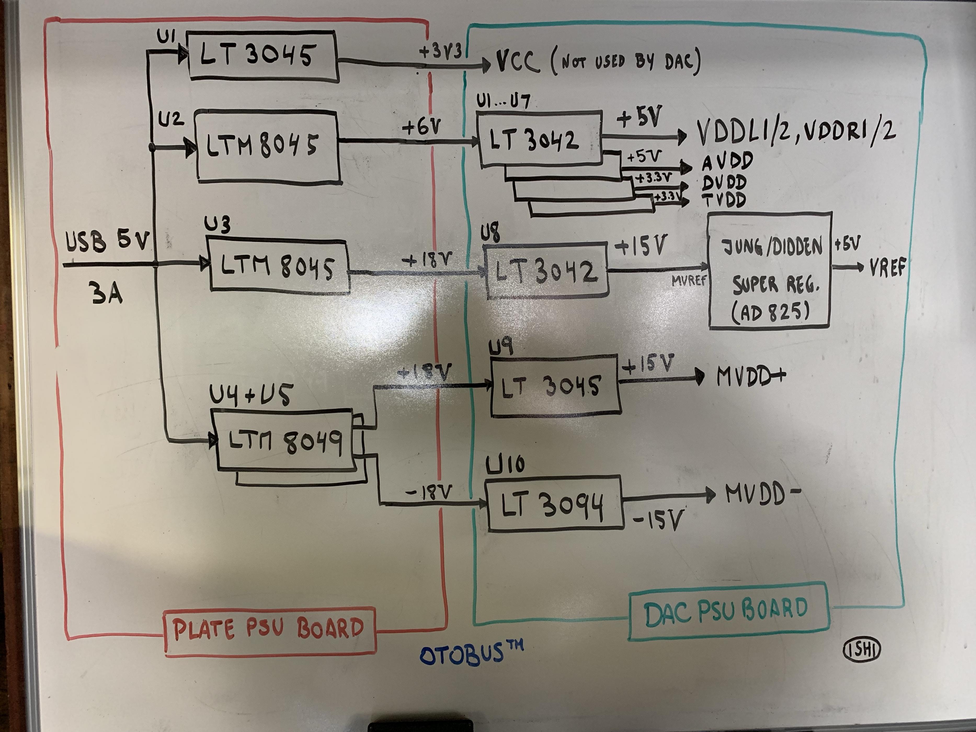

I reckon that it must be positively impossible to follow all this without proper schematics and CAD models. I wish I could produce them faster, but I really can't (I have a full-time job in parallel to all this). They'll come in due time though...
Where does the USB board go, and where to clean power supplies dedicated to dac functions come from? The plate/backplane? How do you prevent noise/corruption from affecting critical signals and voltages? Can someone else's module design plugged in anywhere cause destruction of the dac chip or other components?
Maybe it would help if you would draw up a block diagram sufficient to show where things are located physically and which signals/supply-rails get routed where at the plate/backplane level.
I can try. Please take a look at this week-old block diagram. It is still valid (as far as I can tell).
The MCU will be mounted on the Plate PSU Board, or on a mezzanine board attached to it. The Plate PSU Board will carry all the analog and digital signals coming from the MCU and required by the DAC board. The DAC PSU Board will then carry these signals up to the DAC board that is mounted on top of it. So, to recap (from top to bottom):
4. DAC Board
3. DAC PSU Board
2. Plate PSU Board
1. MCU Board
How everything gets properly isolated remains to be designed. I'm still not sure where the digital isolators will be installed for example.
And to be perfectly honest, I have not given much thoughts to what would happen if a random brick starts doing funky things on its own, and whether it could destroy a nearby DAC brick.
And yes indeed, this is a very, very complex project... 😉
