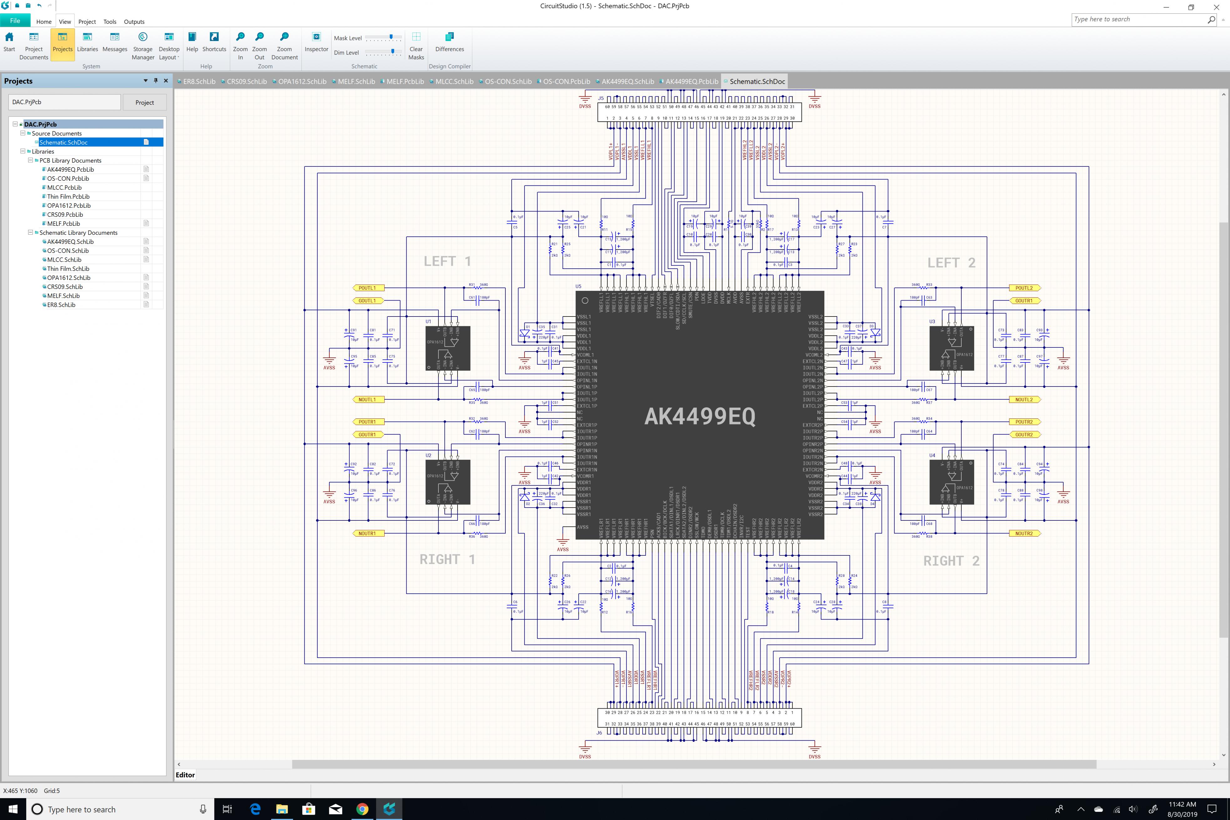

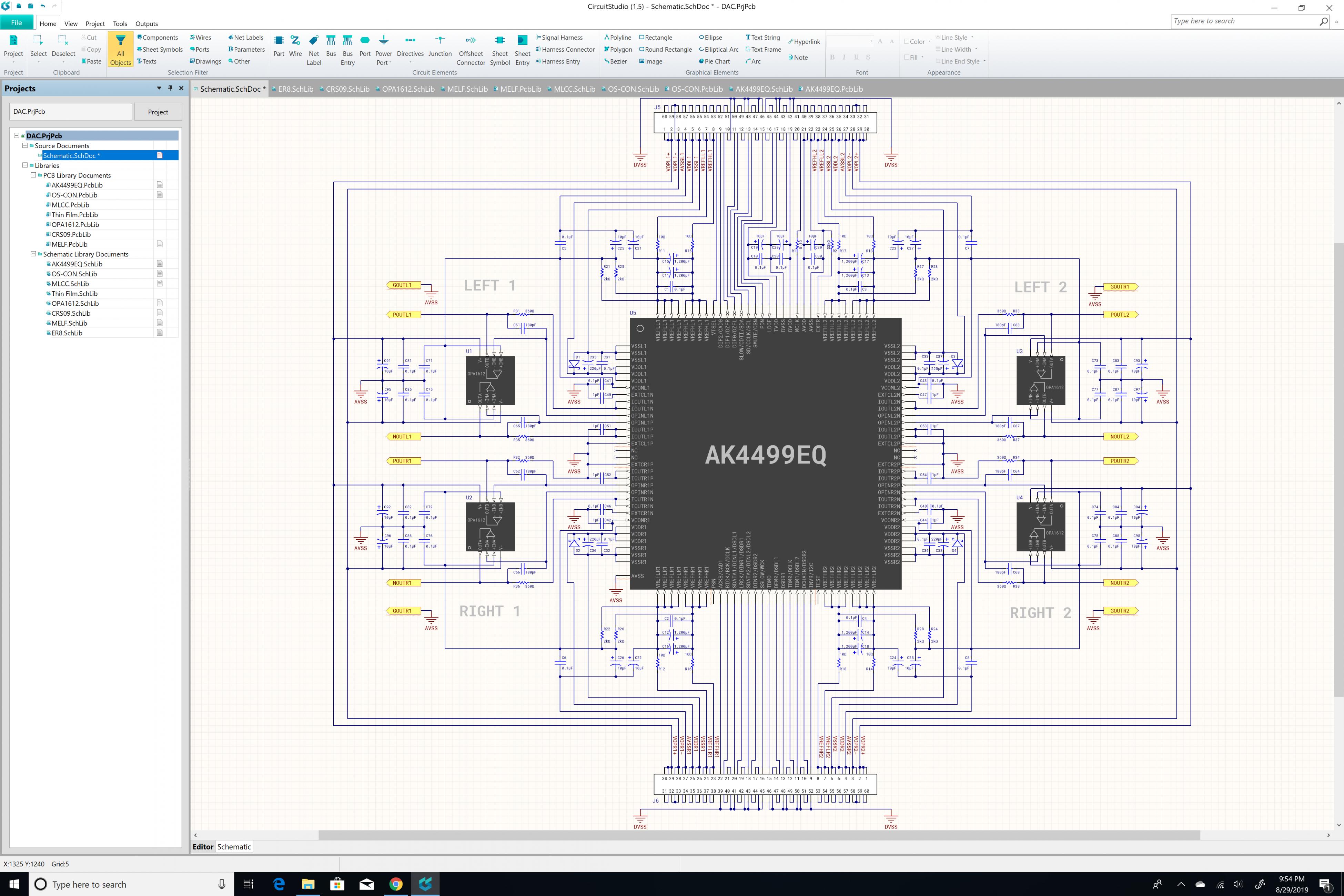

Complete Schematic
Here is the complete schematic with both connectors.
Here, PSN and TEST will have to be hardwired on the board.
Tomorrow, I'll work on MCLK.

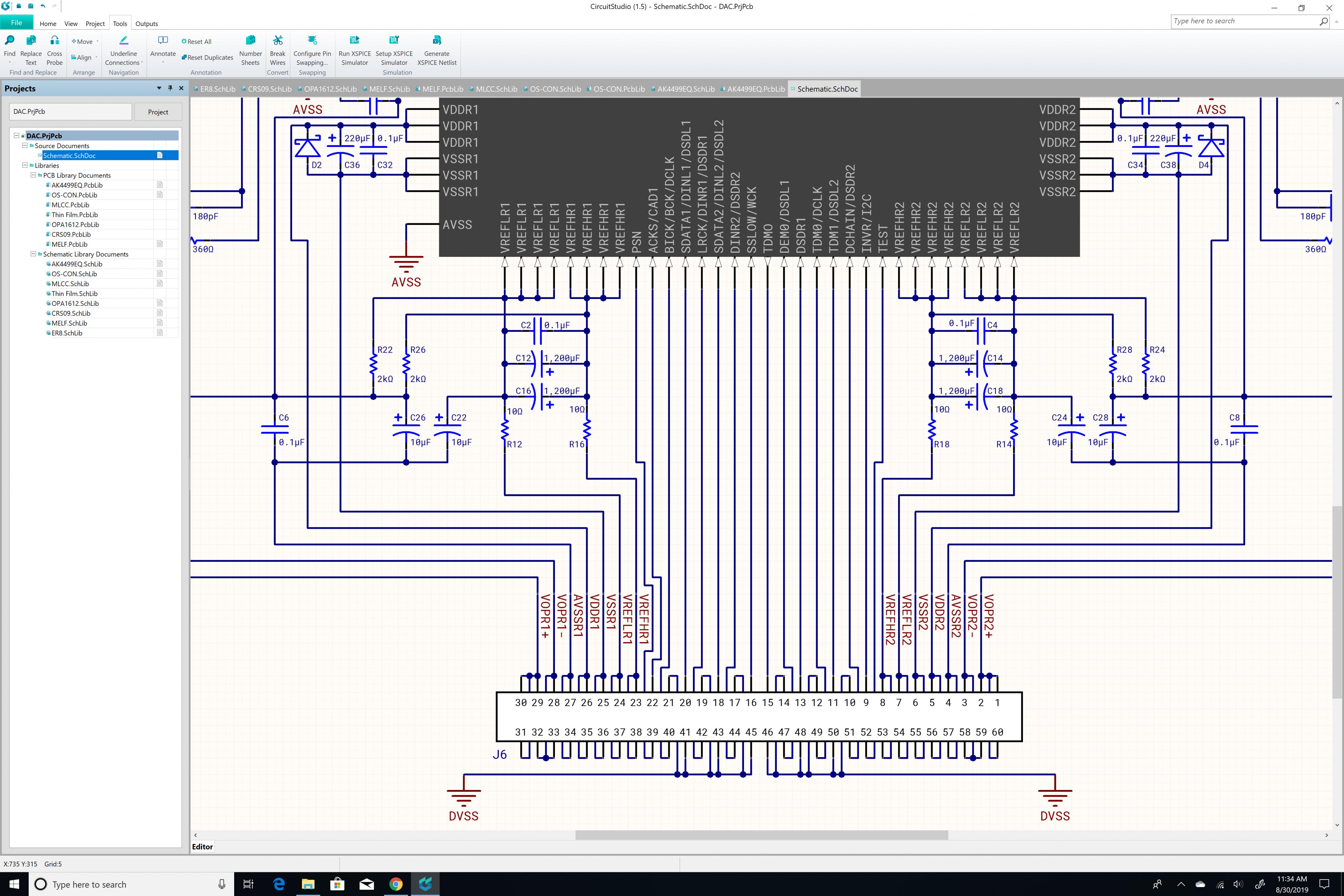

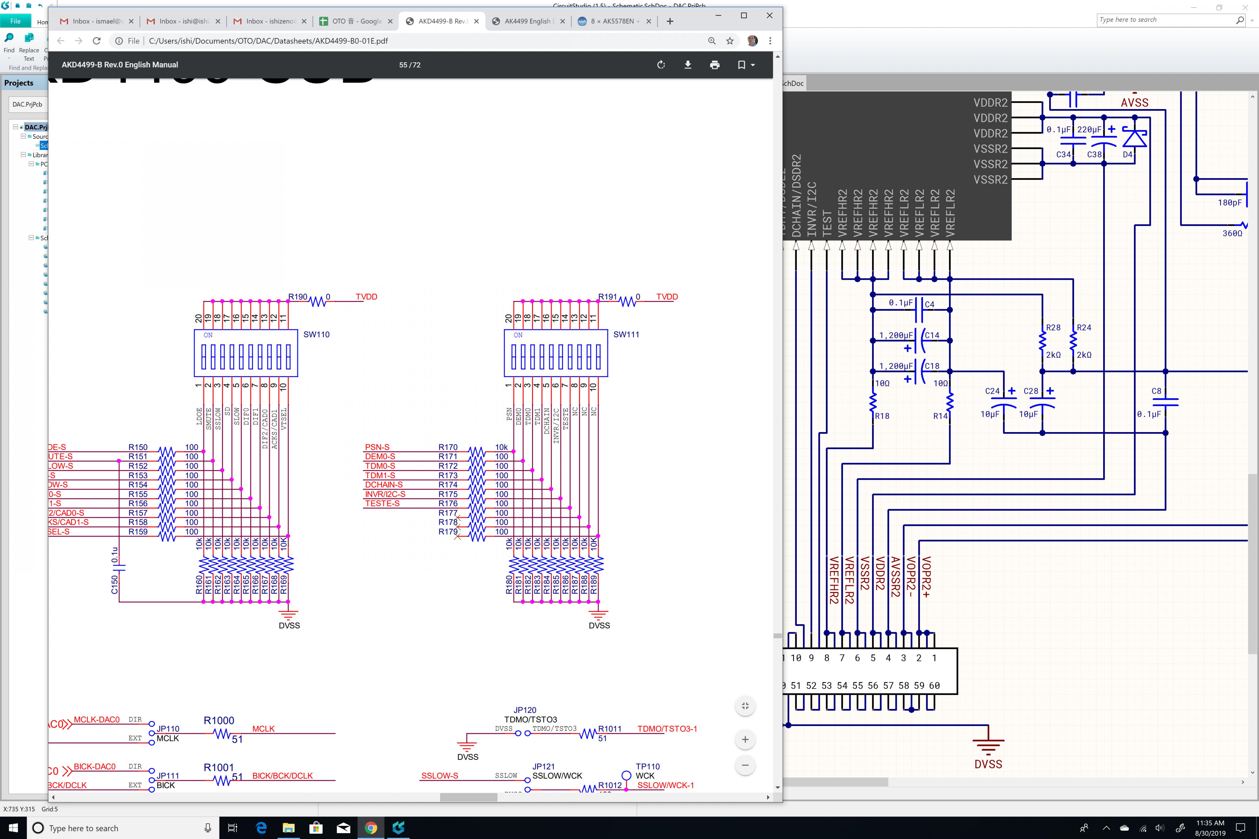

No Hardwired Pins
The AKM evaluation board does not hardwire pins like TEST (56), and I am a bit concerned that we might regret the decision of hardwiring PSN (41) as well. Therefore, we've added both to the J6 ERM8 connector. This cost us two ground return signal, yet every single digital circuit pin keeps an adjacent ground return signal pin, so we should be fine.
Better safe than sorry...

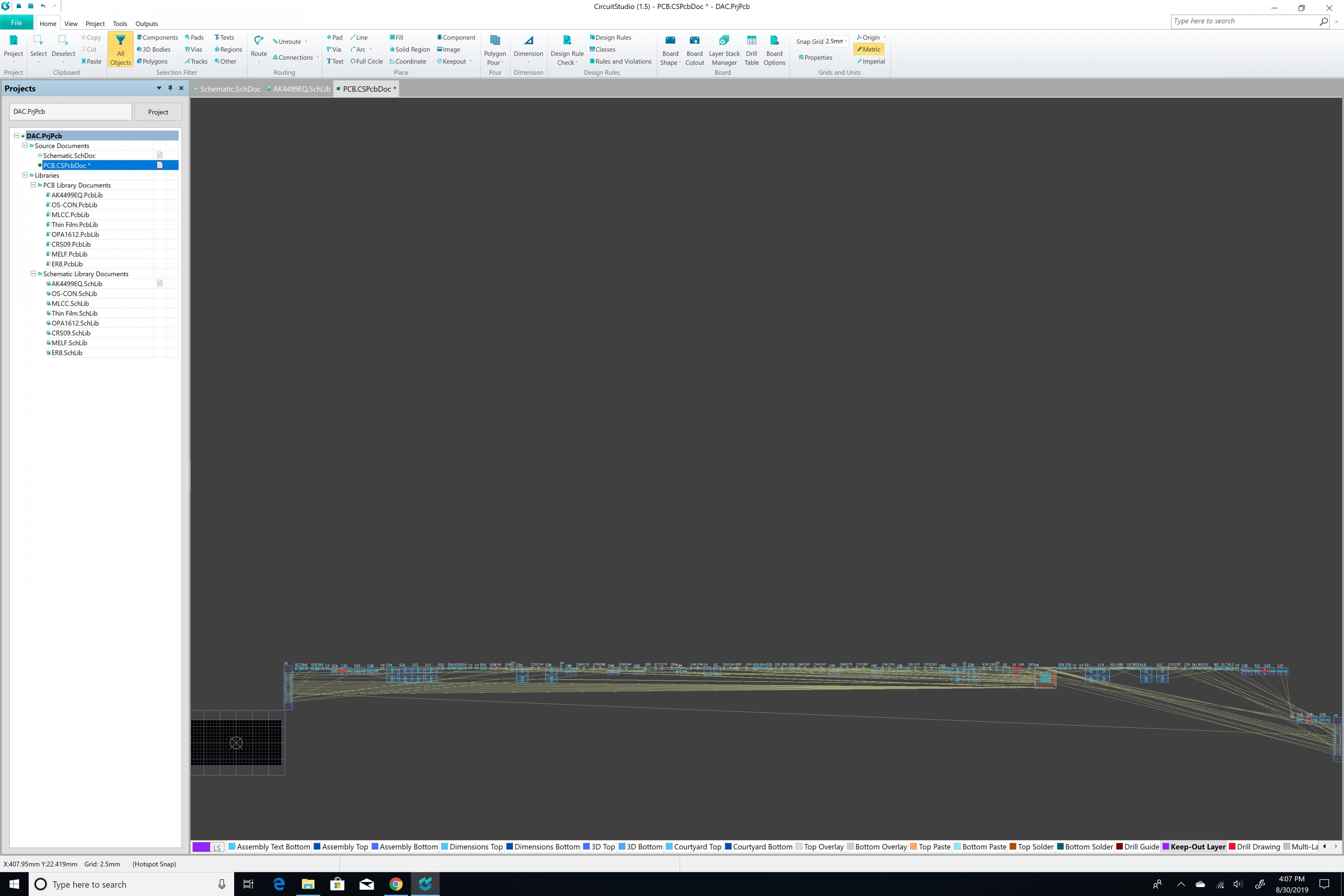

Updated Schematic
Here is an updated schematic with fixes for all known errors. It compiles with no errors.
The next step is to quickly lay out a first PCB, just to see how much space we have left for additional components like the clock and some LDOs, and whether everything will fit within a 2 × 1 brick, or whether we have to go to a 3 × 1 layout. My hunch is that 2 × 1 will be tight, and 3 × 1 should leave us plenty of space for some on-board LDOs. The latter option is probably best, but we'll start with a 2 × 1 layout just to force ourselves to keep things as tight as they can be in a first iteration.

Currently, the thinking is that the core DAC board (the one for which we now have a full schematic) will be independent of that. In other words, you could use the same DAC board in 4-channel mode, in stereo mode, or in mono mode. All that will be required is different XLR boards. These will be really simple, and we'll provide schematics for all three. And the kits will come with all three boards so that comparative tests can be performed relatively easily.

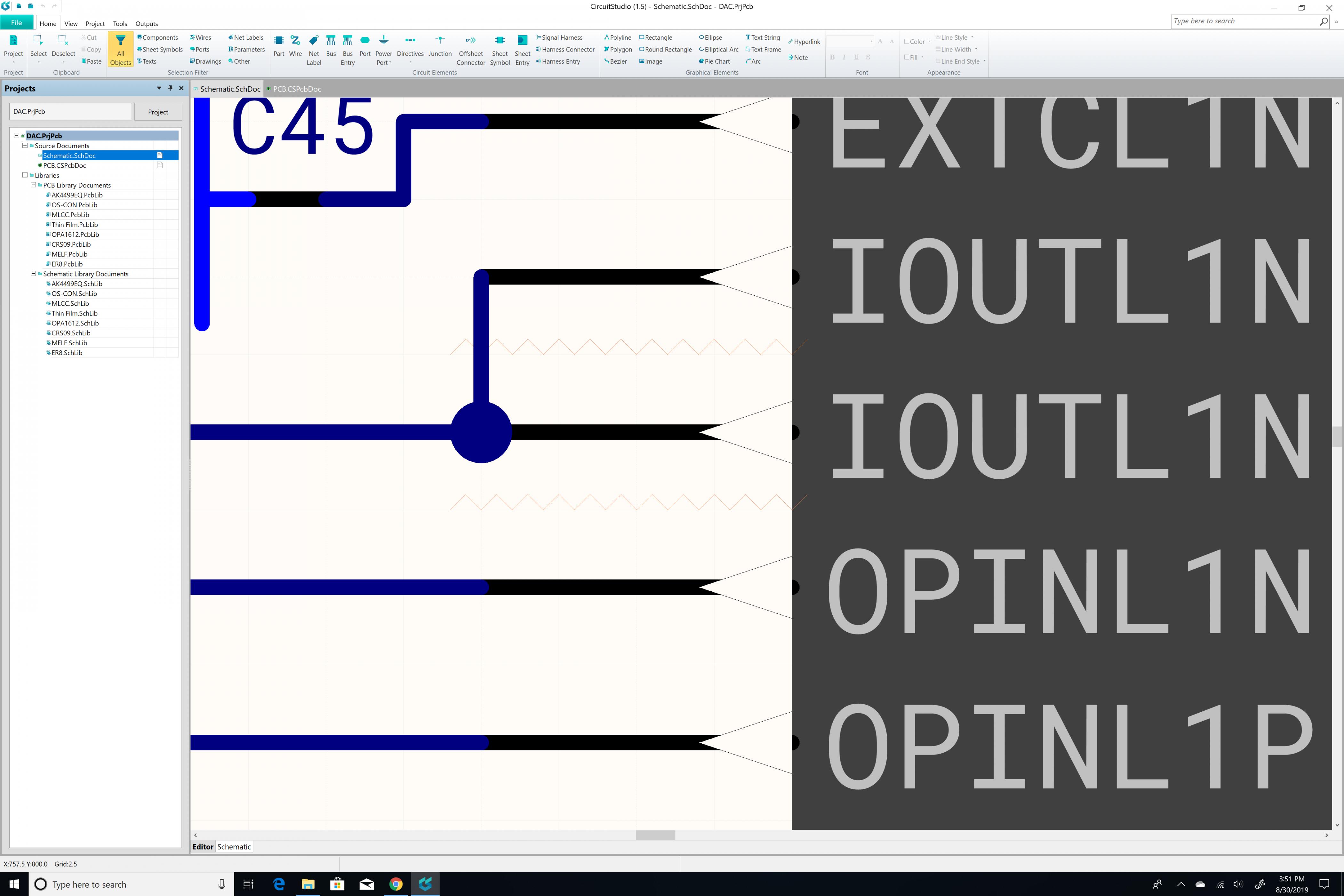

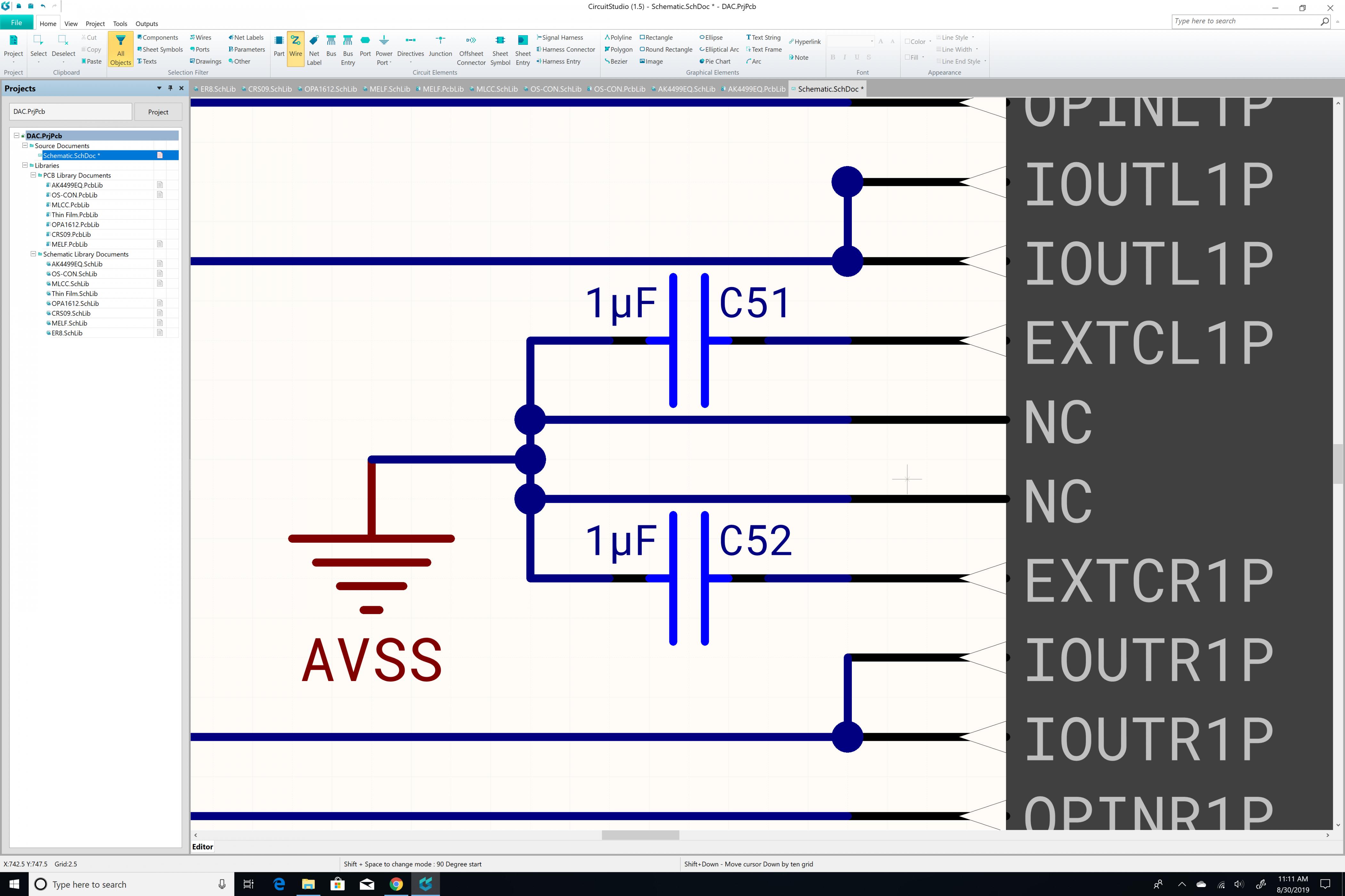

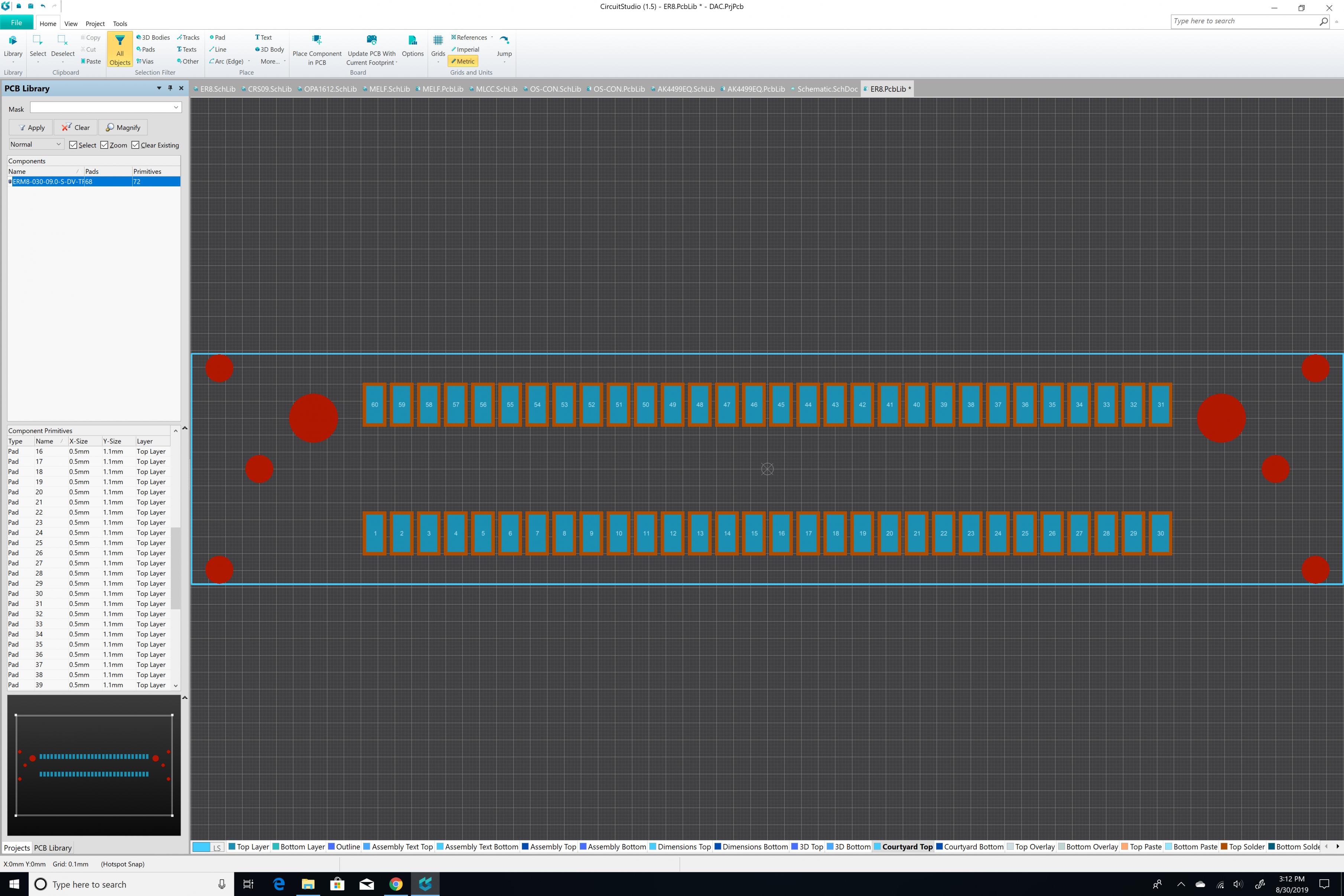

Nets Containing Multiple Similar Objects
This one is for the Altium Designer/CircuitStudio experts: the attached schematic generates the following PCB compilation error:
It is described on this article.
I'm sure that I could get rid of the error by changing the pin type for the two IOUTL1N pins, but I'd like to avoid that. Any other way to work around the problem?
Or should I just edit the Connection Matrix? I don't really like this kind of hardcore solution either because it defeats the purpose of using proper pin types, but I can't think of anything else.
You should hardwire PSN. You will never want or be able to run the dac in pin control mode anyway. You don't have near enough connectors for all the dual-use pins, for starters. And what the dac can playback in pin control mode is very limited.
I think I'm starting to understand what you're saying. It might take a while for it to sink in though...
