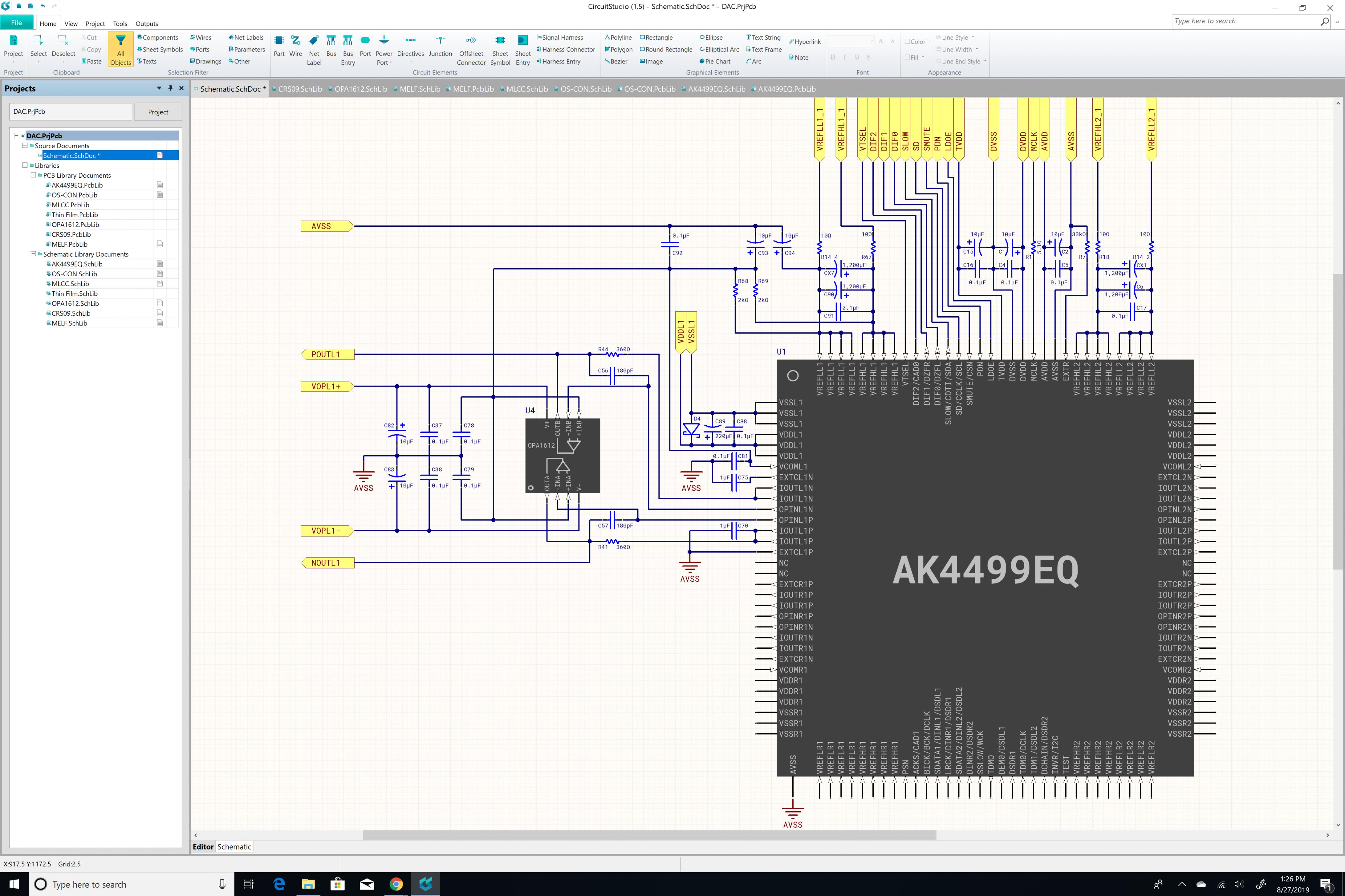

Here is the North-West side of the schematic. I am using ports for the time being, but most of them will be replaced by proper connectors once the full schematic is laid out. Unless I missed something, the rest is nothing more than a repeat of what we have right now, with the South side being a bit simpler than the North side. I hope to have it completed by tomorrow. I'm sure that it can be improved quite a bit, but it's already a lot more readable than AKM's. I just hope that I positioned the polarized capacitors the right way... Please let me know if you can spot any mistakes (assuming that you have access to the evaluation board's manual). After that, I'll probably need some help laying out the circuit for the clock, but we can discuss that once the baseline schematic is complete.

Haven't had a chance to look closely but noticed an aesthetic thing. I would definitely redraw your op-amp symbol as an op-amp, not a box. Makes it much easier to read.
I can certainly do that. Will post an updated version tomorrow.
Thank you Chris.

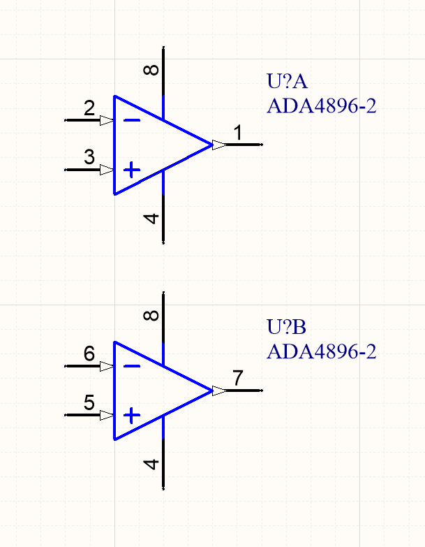

Here is the best that I could come up with. Please let me know if you had something else in mind.
That's better, although normally I see them like this. Multipart A/B for duals.
Unless it's only a few pins, normally I don't even use 4-sided schematic symbols. I just use two and break it up into parts. I usually group the pins according to function as well. This is all optional, but I find it makes the resulting schematic easier to read.
I think I get your point. I like to do that as well, but in this particular instance the chip is so very symmetrical across two axes that preserving the physical layout is quite conducive to a clean schematic, and provides a good first step toward the PCB. I also wanted something that is not too far away from the original schematic, so that we have a clear point of reference.

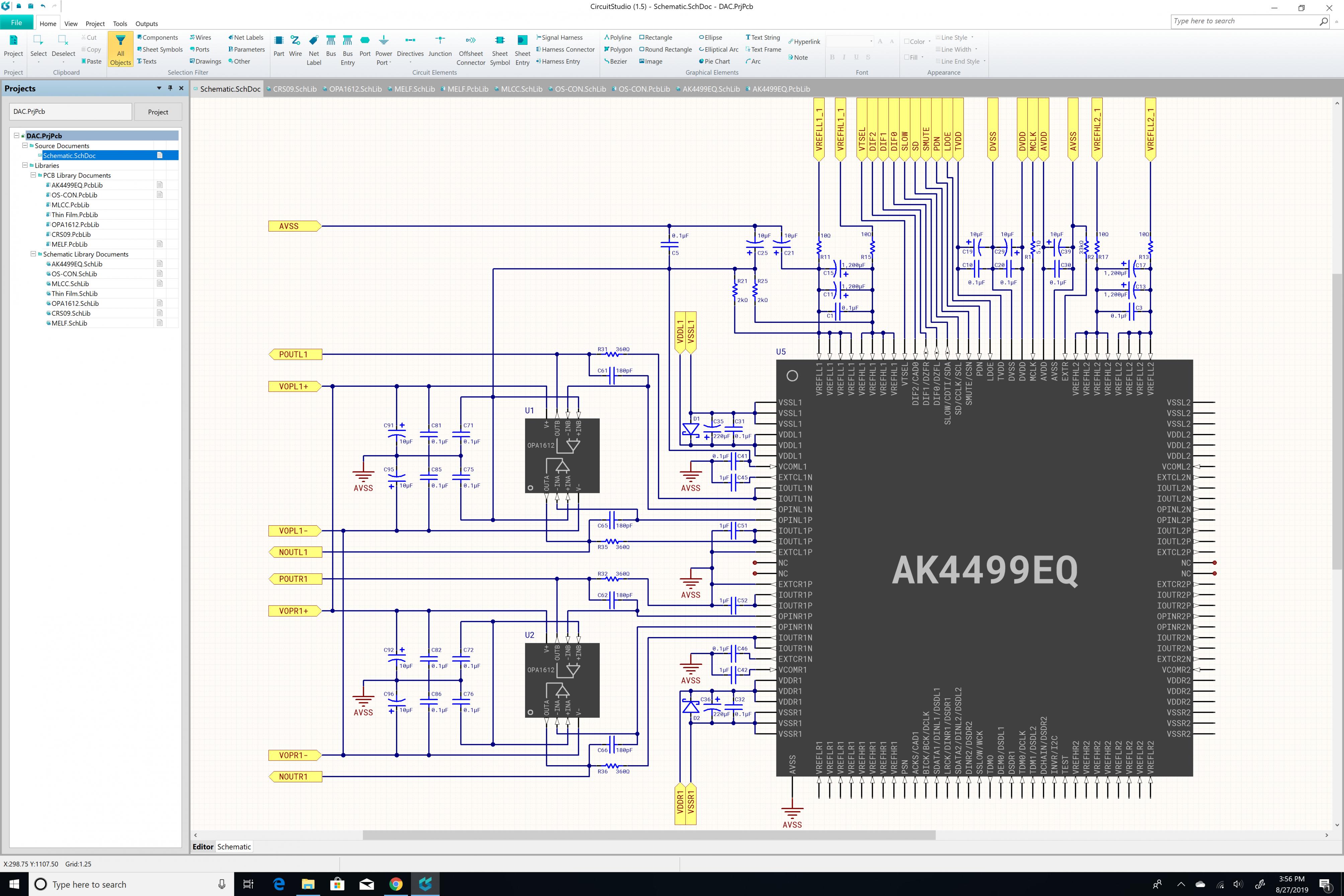

The application example in the AK4499 data sheet show the opamps in conventional form and layout, aside from the power terminals, that is. Sometimes those are shown separately anyway.
That's right. The schematic on the datasheet looks like a schematic, while it looks like a PCB on the evaluation board's manual. I am trying to find a happy middle ground with our schematic.
Big black blobs are not so great if one wants a printout. There goes the black ink cartridge...
That's true. I noticed the same thing this afternoon. They look good on screen, but they're stupid on paper. I'll make sure to provide both versions when I'm done.

Here is the West side (L1 & R1) fully laid out.
Note how the two operational amplifiers are aligned with each other, instead of being rotated from each other. This means that the indices of designators are in correspondance with respect to the operational amplifiers, but not with respect to the DAC chip. It's one or the other, it can't be both, so we picked one (the former), because it creates clean I-V blocks.
Also, we're now using red pads to terminate non-connected pins (like the four NC pins found on the DAC chip). This looks much cleaner than leaving some floating pins. I just hope that it won't create any problem when we lay the PCB out.
The hardest parts of the schematic are probably behind us now.
