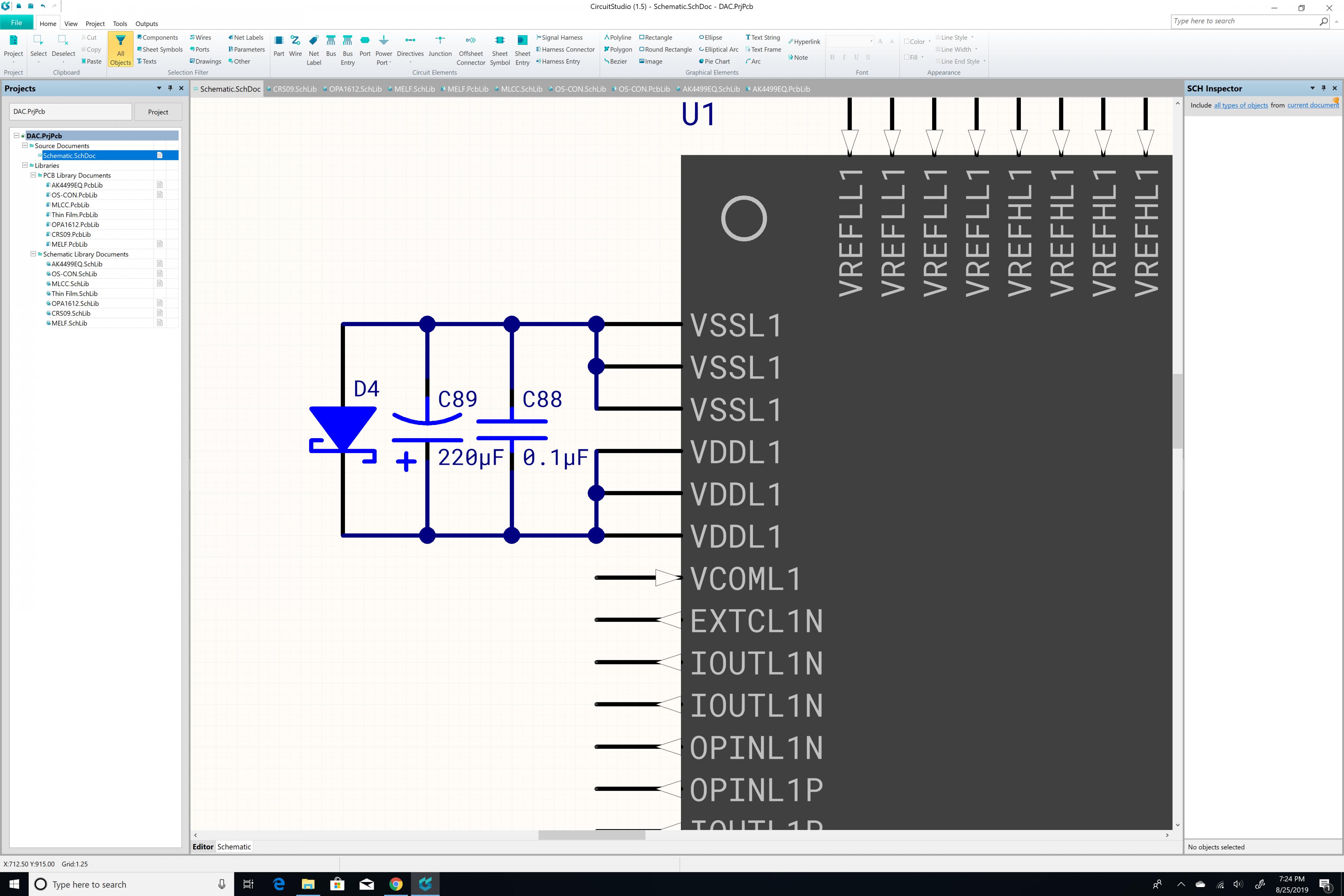

You're right, these are the diodes. But look at the mezzanine board. The D1..D4 diodes were supposed to be mounted on the edge of the board. Instead, they've mounted them where the C_X2, C_X3, C_X6, and C_X8 capacitors were supposed to go. This works because D1..D4 and C_X2, C_X3, C_X6, C_X8 are on the same traces... They might have planned to use C_X2, C_X3, C_X6, and C_X8 to get more capacitance, then realized that they did not need it, and they might have figured that mounting the diodes closer to the DAC chip would be better, or that mounting these SMD components so close to the mezzanine headers could create some problems during assembly... Not sure...

And so far, I was trusting the schematic. But no more...
I'll treat the board as the source of truth moving forward.
And I'll work as diligently as I can for us to get a trustworthy schematic.
If anything, this should be useful to anyone planning to use the AK4499EQ...
Diodes
Here is where the diode goes.
For reference purposes, I've picked the CRS09(TE85L,Q,M), because it was smaller than the other option recommended by Chris (thanks again Chris). The order of components on the PCB will match the one shown on the schematic (small capacitor closest to the DAC chip, diode furthest away, large capacitor in between).
