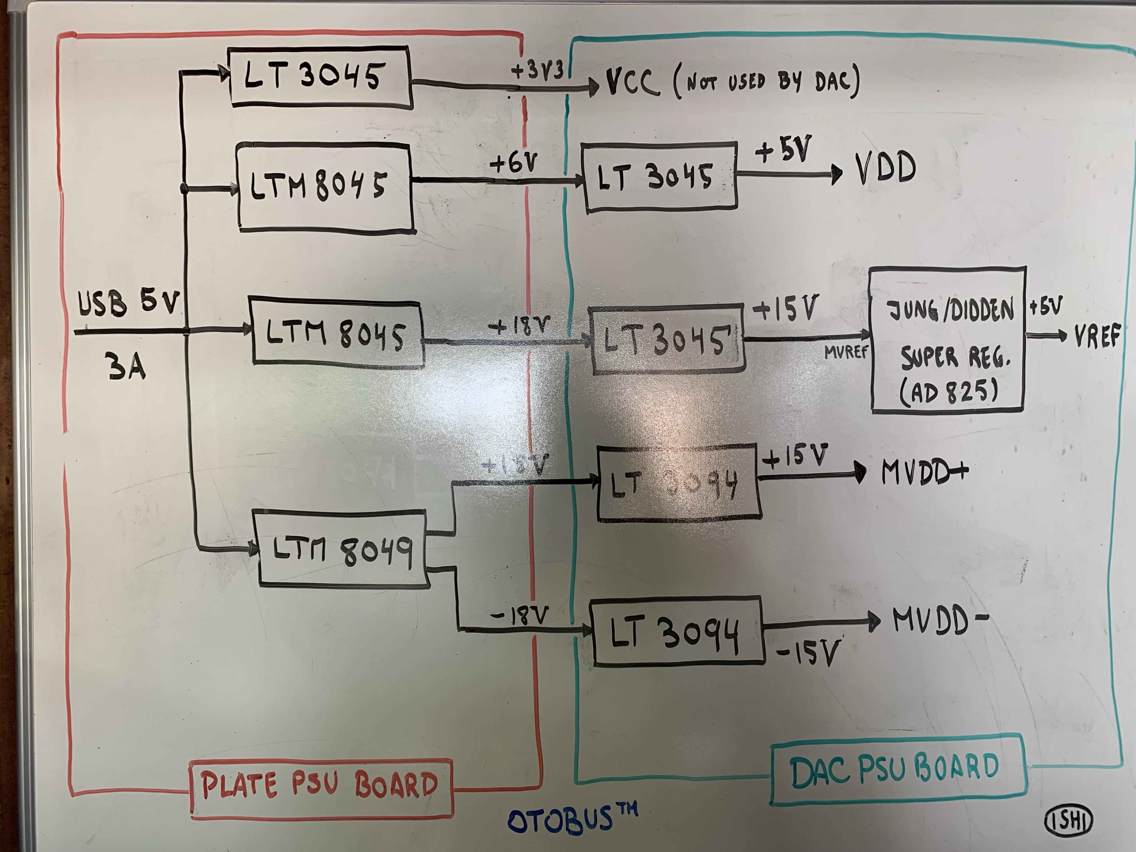

Improvement to Power Supply Architecture
Here is a new refinement of the power supply architecture.
This time, the +15 V line that we need for VREF is totally decoupled from the rest of the power supply system, with a dedicated LTM8045. Doing so, it should reduce the temperature of the regulator, and avoid some level of cross-feeding. With that change, the architecture feels really balanced. Overkill maybe, but balanced.
Also, the more I am reading the documentation for the LTM8045 and LTM8049, the safer the µModule form factor makes me feel (Chris had a great point there). In order to better understand this, one might look at this manual for the DC2244A evaluation board of the LMT8049. Figure 7 on page 6 shows the Radiated EMI CISPR25- Class 5 Peak Limit, which is never crossed, no matter which frequency is being used. If we ever try to get the DAC brick certified, this would certainly help.
Note: This sheet analyzes all the regulators we are planning to use for this power supply system (both boards).

Going with Linear
Unless there is any major objection, I'll go with this list of regulators for a first set of prototype power supplies, because they're all made by Linear, and they're perfectly matched with each other. Also, in my opinion, Linear produces the very best documentations and evaluation boards, with highly detailed explanations of the PCB layout, super cool Jedi tricks like Kelvin connections, and affordable evaluation boards for all their components (at least all the ones that I care about).

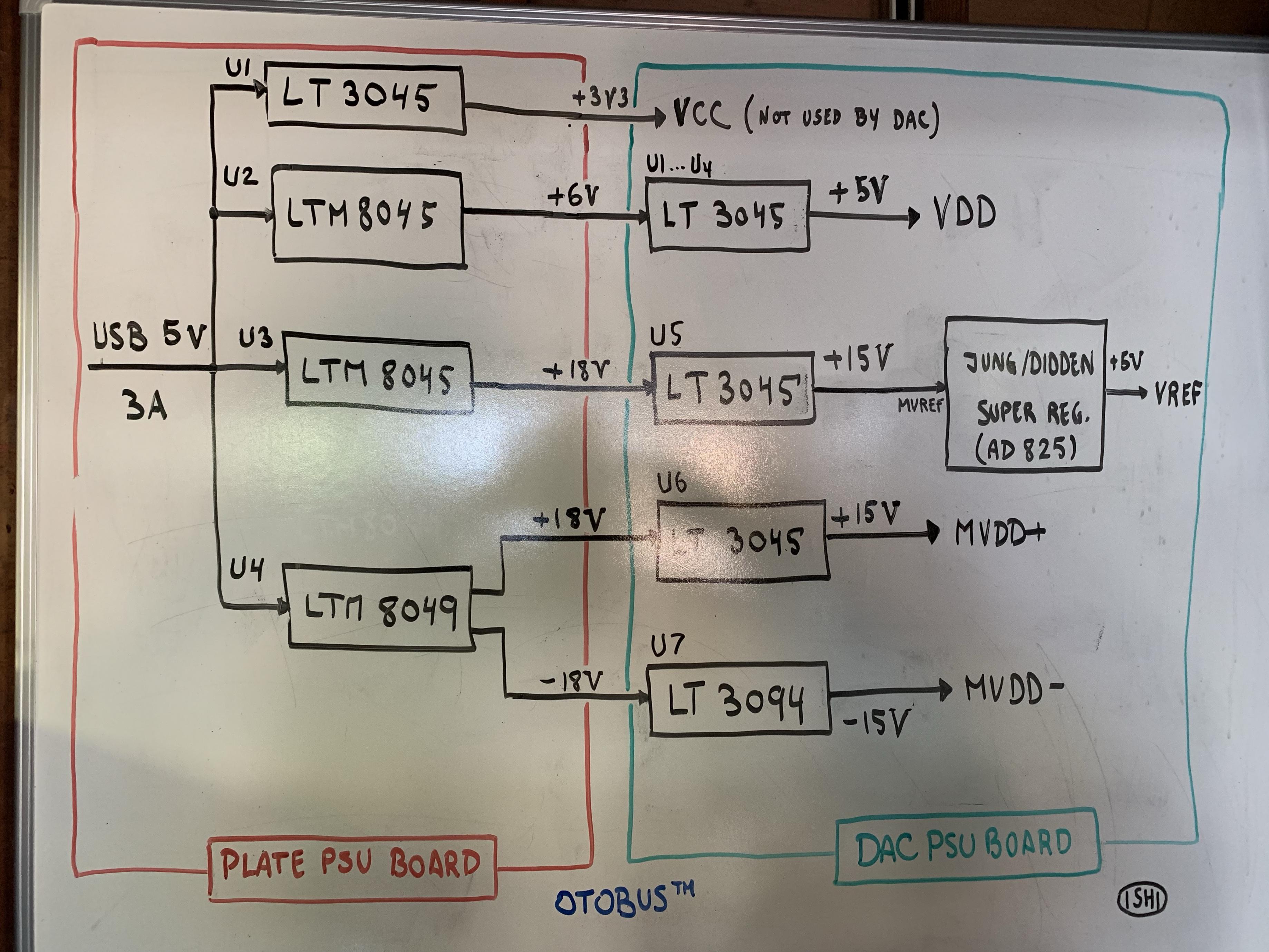

Streamlined 3V3 Line
Here is a small change to the power supply architecture that streamlines the +3.3 V line. Clearly, there is no point going from 5 V to 6 V then back down to 3.3 V. Instead, we're better off going straight from 5 V down to 3.3 V. Somehow, I missed that when I made the architecture more balanced in the previous revision...
Also, the OTOBUS™ has been revised in order to provide both ±18V (for MVDD) and 18V (for MVREF). With this latest change, we have as many GND pins as we have non-ground power pins (5 of each).
Component Designators
I fixed a typo for U6 on the DAC PSU Board. It's an LT3045, not an LT3094... Also, the component designators are used in reference to this new sheet, where we will analyze the load requirements for each part of the circuit. This will help us ensure that the components we have selected are suitable, and that we won't have too many problems with heat dissipation.

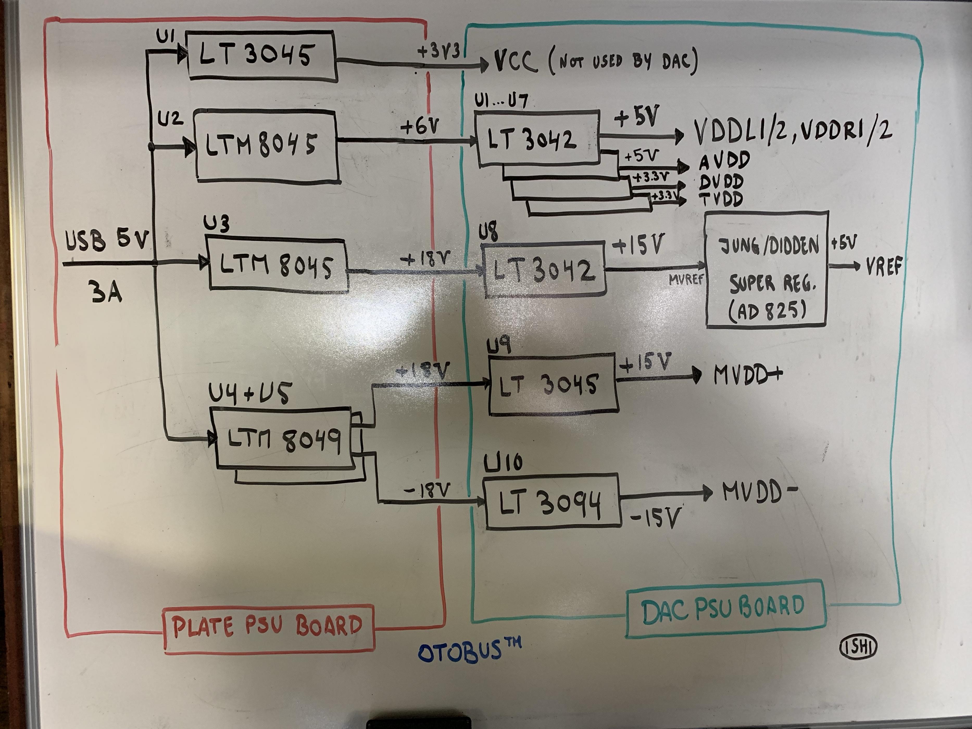

Power Supply Requirements
Here is a first analysis of our power supply requirements for the DAC brick. I decided to play it safe, therefore I have dedicated one regulator for each of the following supplies:
- VDDL1
- VDDL2
- VDDR1
- VDDR2
- AVDD
- DVDD
- TVDD
This brings the total number of regulators on the DAC PSU board to 10. That being said, some regulators might move onto the DAC board itself in order to get closer to whatever they need to feed (but it's too early to tell whether this is possible or not, because we also have to fit a lot of capacitors there).
Most of the data populated on the "Requirement" column of the spreadsheet comes straight out of the AK4499 datasheet. But there is one thing that I'm really not sure about: how to evaluate current requirements for the four OPA1612 operational amplifiers used for the audio outputs. There, I played it safe and used the short circuit currents for the OPA1612, which are +55mA and -62mA. This meant that the U9 LT3045 needs 220mA, while the U10 LT3094 needs 248mA.
Unfortunately, if that is the case, it means that we need two LTM8049 regulators on the plate PSU board, because each regulator can only handle 400mA. And I am not even sure that two of these μModules can be mounted in parallel in order to increase current output and reduce noise, like is the case with the LT3045 or LT3094.
Other than that, things seem to be okay, and we're able to move from the 500mA LT3045 down to the 200mA LT3042 for seven regulators on the DAC PSU board, which is great.
Bottomline: we need to find a way to use the LTM8049 in parallel, or we'll have to add four more power circuits to the OTOBUS™ (+18V, -18V and two GND circuits), which means that we would lose either the I²S or the SAI interface. If possible, I would really like to avoid that...
Or maybe we do not need so much power on the output stage...
Thoughts?

I think I found an acceptable solution to that problem: the OTOBUS™ is mirrored through the two sets of ERF8/ERM8 connectors that go from the plate to the brick. Therefore, we could have one set feeding ±18V from one LTM8049, and another set feeding ±18V from a second LTM8049. From there, two of the OPA1612 would feed from one set, and the other two would feed from the other set. Of course, doing that would make us lose the redundancy that our two mirrored OTOBUS™ interfaces give us with respect to the ±18V supply, but this is probably better than maxing out a regulator. And this will keep the amount of current flowing on any ERF8/ERM8 pin under 250mA, which is probably a good thing.
Note: The BOM for all these regulators is now at a respectable $91.31, but this is pretty much in line with the AK4499EQ DAC chip, which costs a cool $77.22... What that tells us though is that some plate might not come with the fancy pair of LTM8049 for every socket, because that would make the cost of a plate go through the roof, and these components won't be used in most instances. In fact, it makes me wonder whether we will want to mount them on standalone PCBs...
I think I found an acceptable solution to that problem...
There is an even better solution: the DAC brick is a multi-unit brick (two at least, possibly three if all the components don't fit within two). Therefore, it will have access to 2 pairs of ERF8/ERM8 connectors, not just one. As a result, while signals should be fetched from a single pair (or the MCU will be totally confused), power supplies could be fetched from both. And that means that we can keep our sets perfectly mirrored, hence fully redundant.
I like that...
