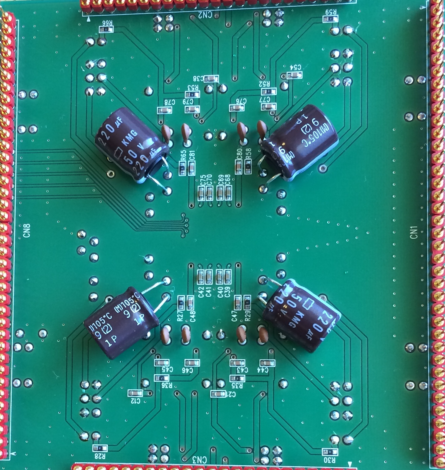

Here you go. Nothing on the motherboard to show.
You rock!

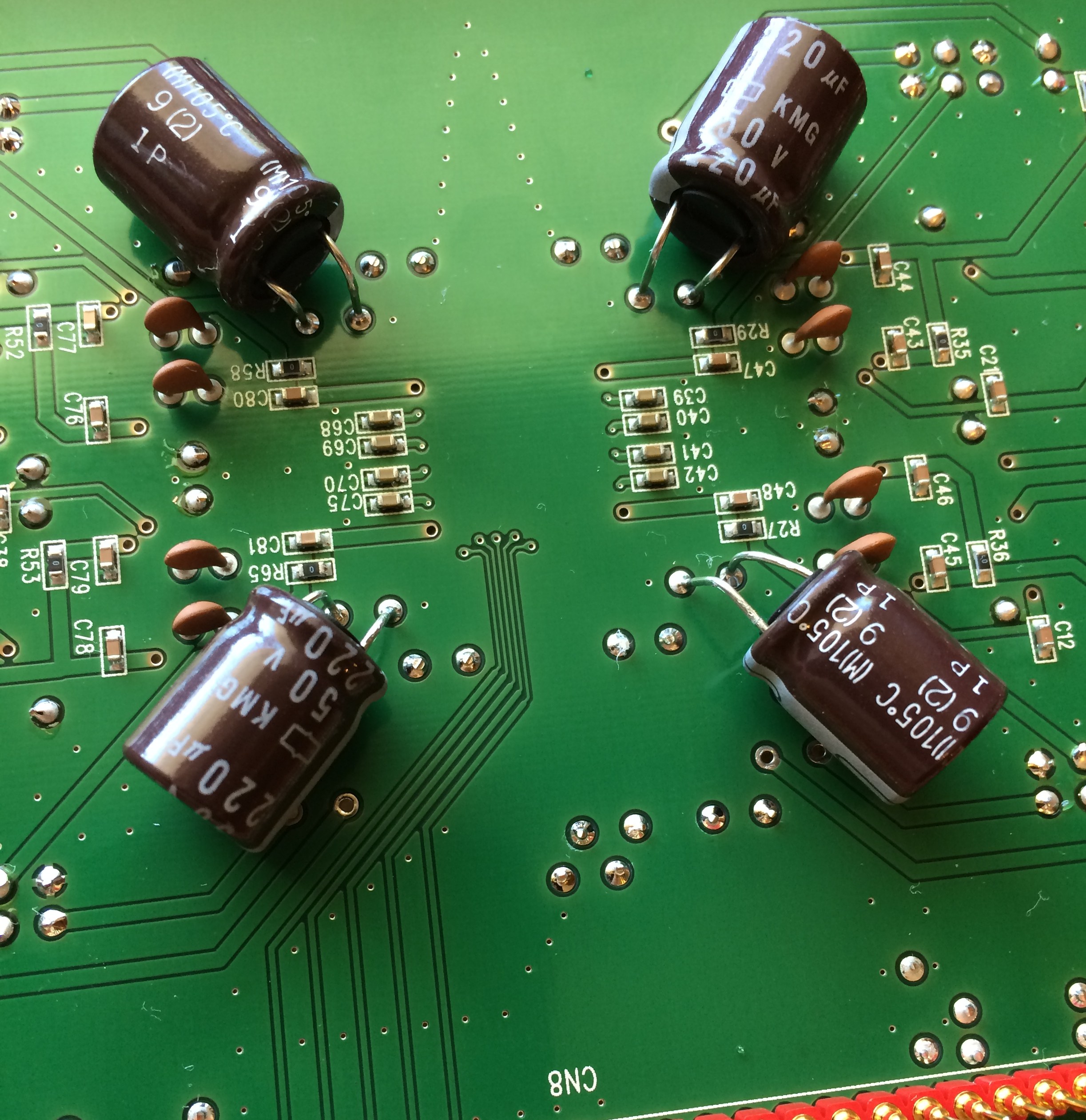

And this is consistent with the manual: only 4 of the capacitors are larger than 220µF (the four 470µF found on the top side).
This is super helpful (I was too scared to do it on my board yet).
The small disk ceramics have the number 8 printed on them, presumably 8pf.
They're not on the original schematics, are they?
Sneaky...
We'll have to look at the top side's traces to see what they connect to... Or the Gerber printouts (which are really hard to read). This promises to be quite entertaining...

Reading this post, it seems that the use of the D44H11 was motivated by Walt Jung's use of this pass transistor for his original 1995 article... In other words, AKM did not seem to have benefited from the work done by Didden since the original article.
Not much on this board inspires confidence that the designer chose anything carefully other than reusing blocks they have used before. There's no benefit to putting the DAC on a mezzanine here and they couldn't even be bothered to fix the board but instead decide to tack on some caps on the bottom in ugly fashion.
