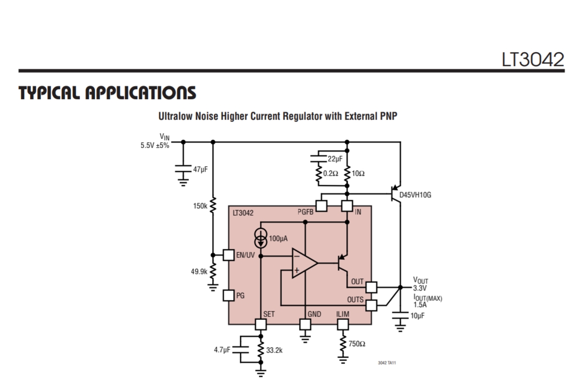

I would say there is almost no situation where a 5600 or 6800 uF cap is needed before or after a regulator in a DAC or preamp. You are probably better off with much less. As far as film caps, they don't really belong in the power supply anymore with MLCCs being around. The only thing I would use them for is in active or passive filters in the signal path. Personally, I would use C0G surface mount ceramic before I used any film caps, but they are good in those positions.
You might not need a pre-regulator before the Jung regulator, it won't hurt, but you might be able to get away with passive filtering.
Those EMI filters can be good, it depends. There are LOTS of types, but they are predominantly some form of inductance, ferrite, or common mode choke + cap. You essentially just need to make sure you have sufficiently attenuated content that is outside the working bandwidth of the linear regulators (including Jung).

No problem, I forgot to mention, watch out for huge caps on the output of circuits fed by the switchers. Some may not tolerate the inrush current. You might actually need a current limiter on the USB input. I think the USB spec itself only allows for 10 uF or something small like that.
One has to study the details to understand, and to the extent one is not at that level, maybe it would be wise to ask someone is is rather than jump to conclusions (something the human brain does automatically without being asked to by its owner, but those conclusions can be questioned by the brain's owner - please lookup dysrationalia and study kahneman when there is time).

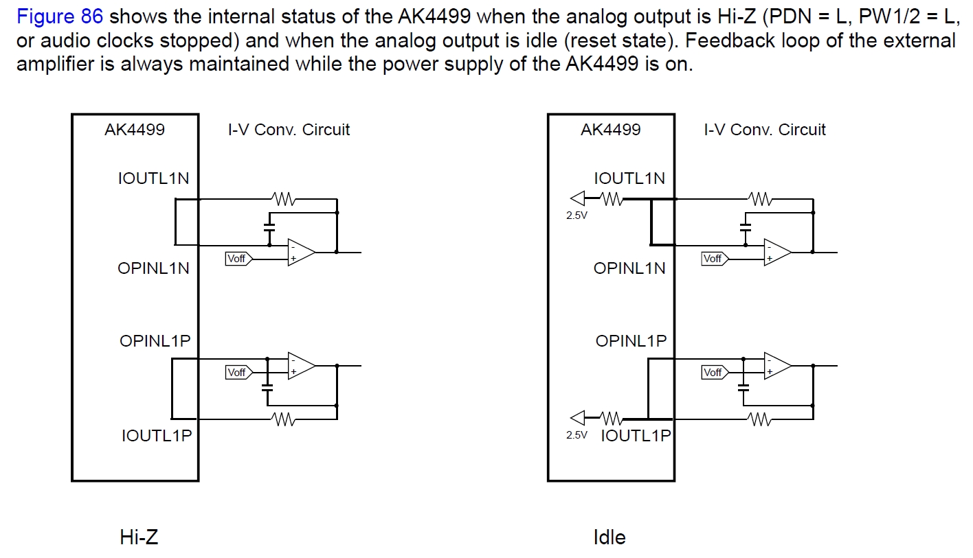

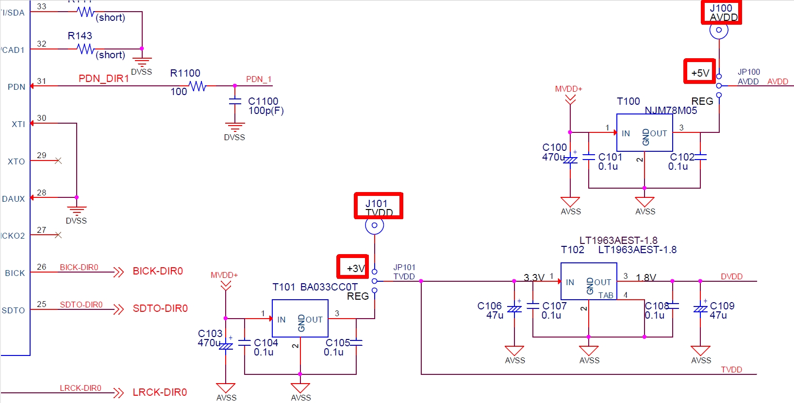

Also, please see pics below for to understand about the suggested regulators.

But I still do not understand what you are trying to communicate with these partial schematics taken out of context. A bit like 37mA with no justification. Why not 42mA while we're at it? I mean, that would work too, and it would give us a bit more headroom, and it's a much better looking magical number.

You said you didn't know which schematics to look at. The answer is those for the eval board, and in the LT3042 data sheet. Exactly the subject matter at hand.
Now you say you don't understand what the schematics mean in terms of being able to figure out how the recommended regulators could be proper to use with the dac? If so, why don't you take your best guess and let's hear it?

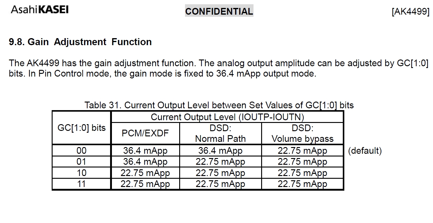

.. A bit like 37mA with no justification.
You know AK4499 data sheet is a pdf, right? And you know Acrobat reader has a search function, right? Didn't I already tell you its in the data sheet? Do I need to say the '37' you are looking for is the one that says 'ma' after it?
I assumed that part, but these schematic do not help me understand why the designers of all these regulator boards felt the need to put very large capacitors there, and why I might not need them (per Chris' comment).

Two things, first an apology. Sorry for saying 37ma, that's how I remembered it. The actual number is 36.4ma as it turns out. Of course, I had to go through the data sheet searching for it since I didn't remember exactly where it was. Pic below.
Part of what may not have become evident yet is that one has to go searching through the data sheet at times. Who has to do it then, me? That's why I want you to start getting in the habit of doing it yourself, it is your project after all, but I am happy to help.

The AK4499 has a totally different design that might make it impossible (Mark knows more about why that might be the case). But if we could make it work, that would be my preferred choice.
I/V opamp feedback loop routes through the dac chip. There is very high gain in the loop and it needs to be kept short. See pic below.
That makes sense. Probably best kept on the same board, as you already indicated.
And I am of the opinion that we should stick to the high-level layout of the AKM evaluation board as much as possible. So, until further notice, the I-V stage is on the same board as the DAC chip.
