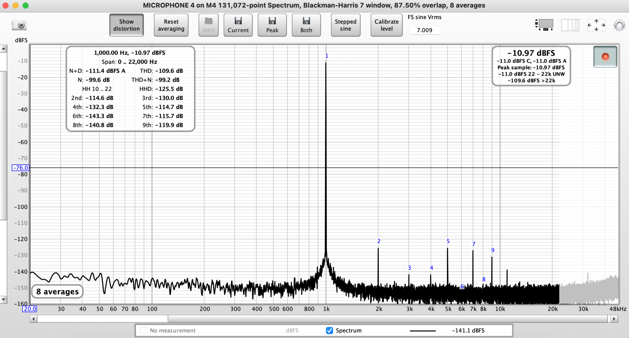

Hooked up the Ian Canada I/V stage on my spare ES9016 and definitely got improved THD performance. Originally tried with the stock op amps and was getting around -106 dB THD, swapped those out for some OPA1612s I had planned to use with Ian's I/V and got the limits of my measurement rig at around -109 dB to -110 dB. For reference I was getting around -104 dB on the stock I/V stage. It also seems like the turn on / off pops are lower than I remember based on measurements but did not want to risk actually listening to the turn on / off pop, will need to investigate this further.

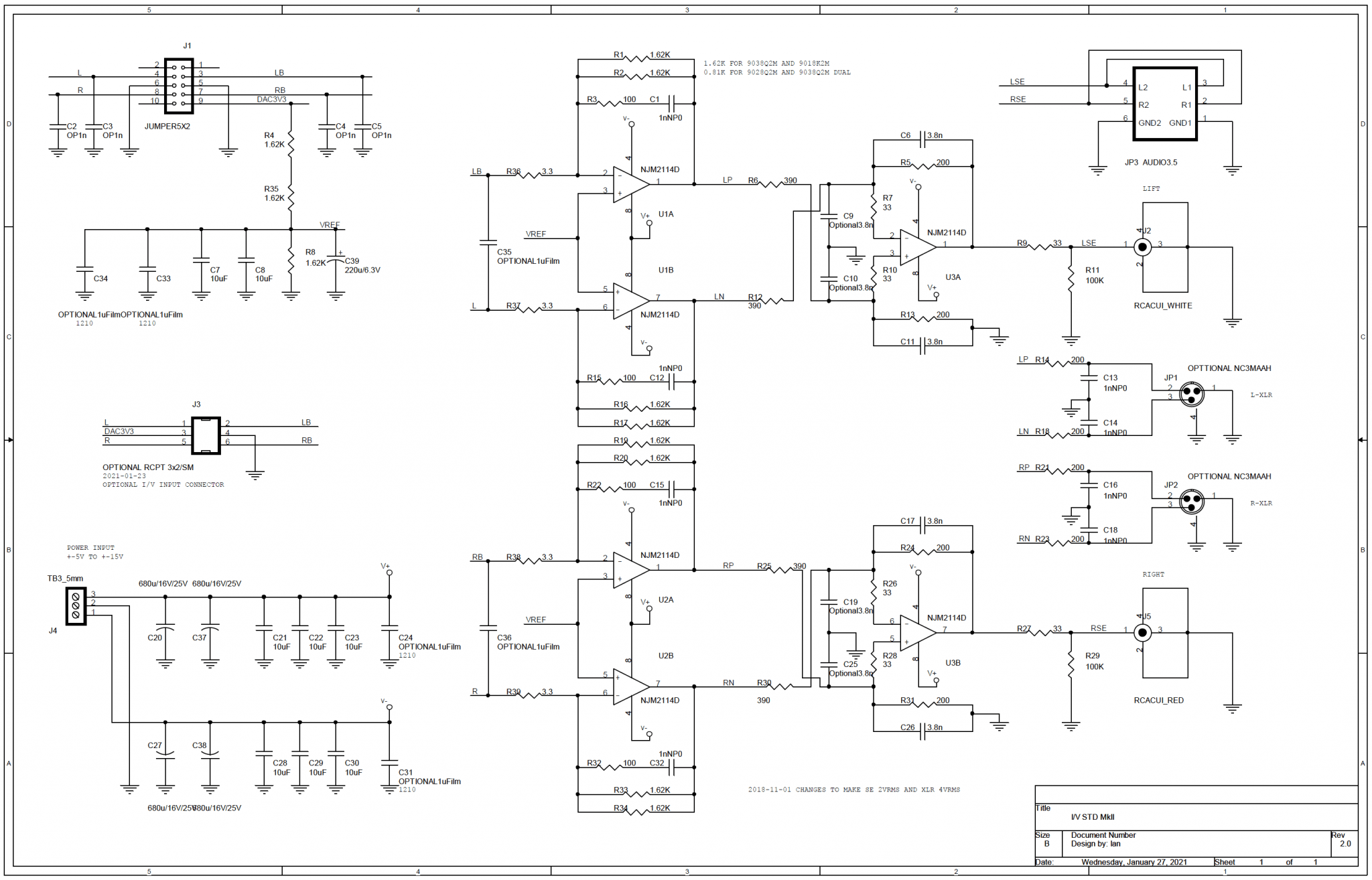

My only complaint is full scale output voltage from the balanced outputs is 1.99 V. I'm very much a noob on I/V stages but I believe this means I need to raise the value of the feedback resistors. I believe in Ian's design these are the 1.62K resistors at positions R1/R2, R16/R17, R19/R20, R33/R34, as these resistors are in parallel any reason I couldn't just remove one resistor from each pair to increase the output voltage? I've re-attached the schematic for reference.
I've attached a screenshot of the FFT from my MOTU M4 with OPA1612s. I have a Cosmos ADC on the way which should allow for more meaningful comparisons of noise and THD.
Are R36-39 fitted? these should not be there at all ... not for ESS anyway. So THD+N is still pretty bad, but definitely better. I guess thats noise still limited by your MOTU as disussed.
I wouldnt just remove R1/R2/R16/R17, or R19/20/33/34 although you certainly could, that would result in a little bit hot output. around 5.9Vpp, or ~4.2VRMS. I presume by 2V you mean RMS? not peak to peak?
R36 to R39 were added along with input film caps at some point to help filter out dac noise from producing EMI effects in the I/V opamps. Caps are for the noise, resistors are to limit resultant gain peaking in the I/V circuit that would otherwise occur due to the input capacitance. Downside is an increase is measured distortion, while audible EMI-related noise/distortion may be reduced. Allo similarly found that opamp EMI sensitivity in both I/V and differential summing stages produced audible effects that at least in part tend to show up as noise on FFTs. Minimizing measured noise is one approach that does not require reliance on listening tests. Allo also found that reducing measured distortion to numbers lower than ESS datasheet values was possible but doing so had an adverse subjective effect on SQ. Note: Some or all of the above is not published information.
EDIT: Regarding I/V gain setting feedback resistors. Changing their value is an easy way to adjust voltage gain. However, measured noise and or distortion may be affected by using non-optimal values. Also, in theory if I/V feedback resistors are changed then changing feedback caps to maintain filter time constant may be worth considering.

Regarding output voltage, I am getting 1.99 vrms and would prefer to get something closer to 4 vrms. It sounds like there are two options being discussed to accomplish this, 1) remove and short R36-R39 (input resistors) or 2) remove R1/R16/R19/R33 (feedback resistors), is this correct?
Michael
Hey mate. nah, 1) will have no effect on the output voltage, or very little anyway. 2) will give you what you want. as its just an experiment you can probably safely ignore 1) distortion performance will be slightly worse with them in place and I personally would remove them, but its not a huge deal. with 2) you will need to adjust C1/12/15/22 for matching filter response, but that also can be safely ignored if just as an experiment.

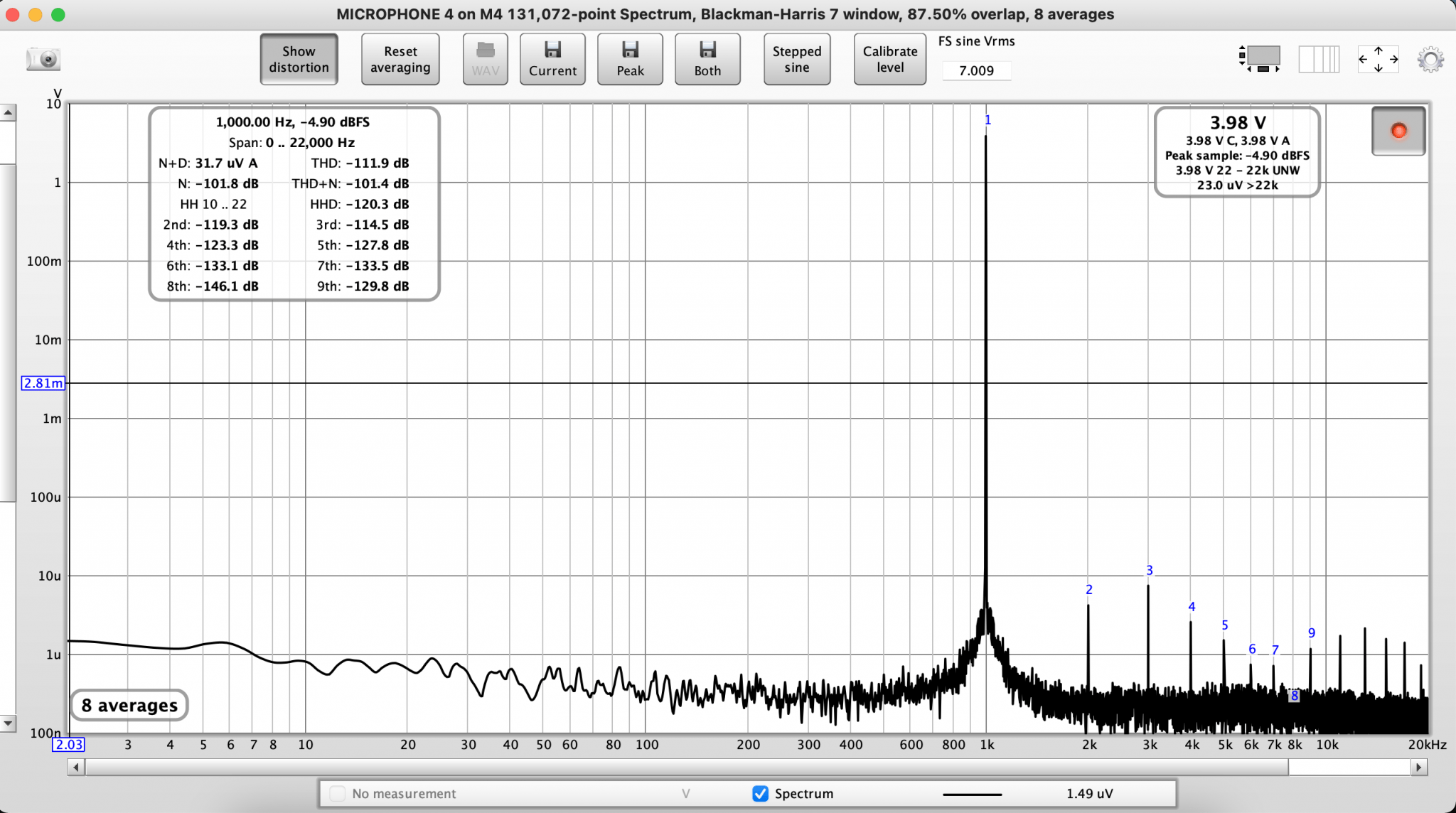

Thanks again, popped off the feedback resistors and now sitting at 4 V 🙂. 3rd harmonic increased quite a bit but overall THD did not get worse. I also hooked up some garbage speakers to see about turn on / off pop, definitely way less than the stock I/V stage. Not pleasant but not scary.
