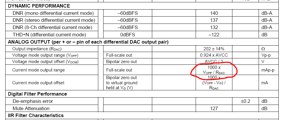

Do you know why ES9038Pro max output current is calculated from voltage mode output impedance? Same it is for ES9016.@kaameelis
the 9038 board outputs about +/-15ma, so depending on the opamp used, this, along with having to source some of the dac current too, mean that some will be operating outside their capability. with the 9016, the current is much smaller (about 4 times), so the opamps will handle it comfortably. I cant remember how profound the difference in performance was with driving a virtual GND at 0V vs biased, but it was significant. its unknown quantity makes it difficult to describe the whole theoretically.
that would be how I came up with +/-15ma per channel (its 202Ω per phase)... output impedance of 202Ω. AVCC voltage is 3v3 x 0.924 = 3.0492, or 3049 mV / 202 = ... drumroll +/-15.095mA
its plain ohms law, of course thats how you figure it out. shouldn't need a datasheet to tell you thats how you calculate it.

how do I know? at its heart, the ESS dacs are really voltage out dacs. thats how they were initially designed and specified. they just found that if set up in this rather specific way, they behave like a current out dac and this makes them perform quite a bit better. they were already good, but this made them the best objective performance parts around for quite some time, until the AK4499. very low impedance for a current out dac really. typically a current source is much higher impedance. there is no 'current mode' and 'voltage mode' the VOUT is basically just AVCC minus losses (an oversimplification, i'm sure someone will chime in
it is easier to think of the output as a voltage source in series with its output impedance rather than a 'voltage dac, or a 'current dac. they really need babying to make them act like a current out dac. the AKM and ROHM dacs are similarly specified though really. just seems to be the way manufacturing goes these days, because to get the performance and keep on improving it, they are doing so by adding more and more dacs in parallel on the die. thats why the current keeps on going up with each model and the output impedance keeps going down. You can think of the 9038PRO as 4 x 9018S in parallel and the 9018S was already made by running a number of dacs in parallel.

but really its just a simple application of ohms law. how else would you calculate the current out than dividing the voltage out by the resistance/impedance? you can calculate backwards in the same way. Ohms law really is a marvel; you should read up on it. It sounds like this is the first thing you should do, before you do/build anything else; it is essential knowledge.
No difference in the voltage, no, as ive already mentioned. the voltage and the VGND point are the same either way. running in 'current mode' just allows cancellation of some of the internal distortion mechanisms/non-linearities, so you end up with lower distortion. Without insider knowledge I cant give more detail than that on exactly what distortion mechanisms, or exactly how they are cancelled, but it is easily objectively verified.
I hate these terms 'voltage mode' and 'current mode' and really wish they hadnt entered the DIYA lexicon. they lead to quite a bit of confusion. its the same dac; it doesnt have a switch. there would be no reason to expect ohms law to fail, or for the numbers not to 'add up' the same way.
*well hmm, not totally true. its true if just talking passive IV, but if you set the dac up as 'current mode' and that current is buffered by an active stage, depending on the resistor value you choose for RIV, you can swing a lot more voltage than 3V. if just running 'voltage mode' with passive IV, or a voltage buffer, the dacs power supply rails limit the amplitude of the voltage it can put out before clipping. with active IV, you are limited by the voltage rails of THAT stage before clipping.
