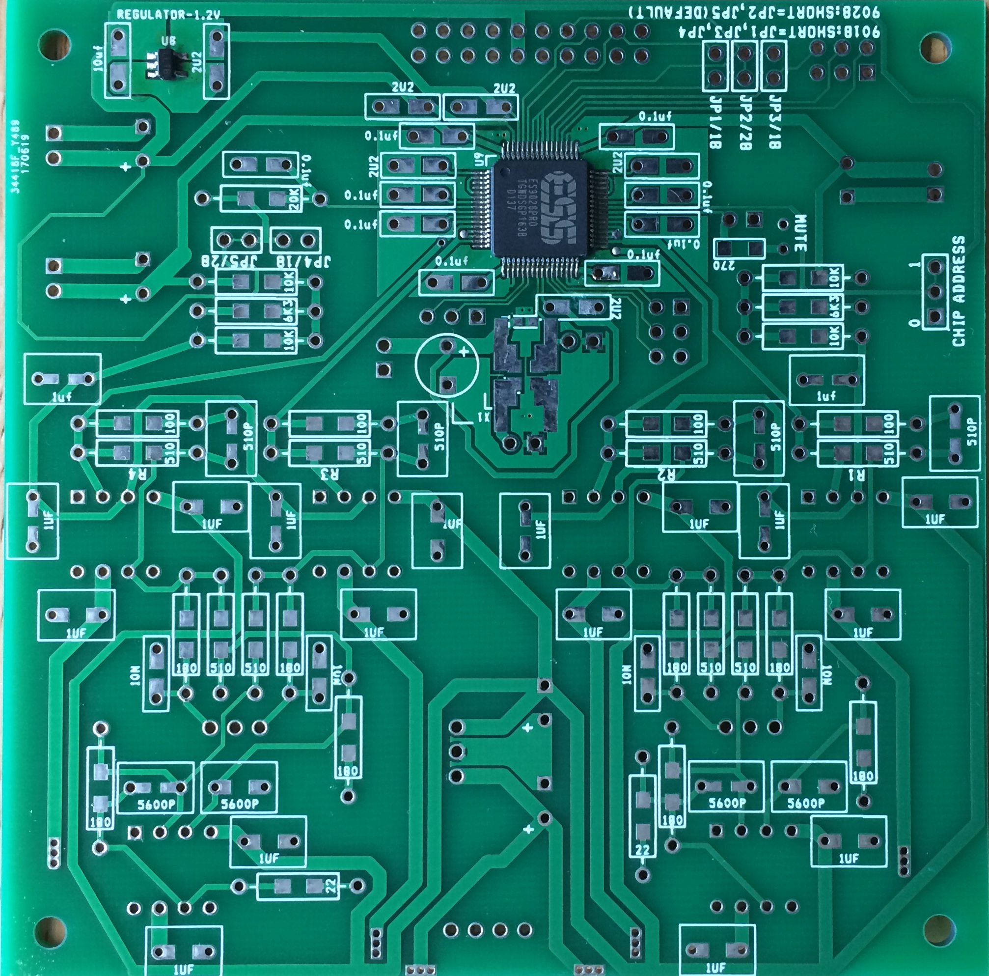

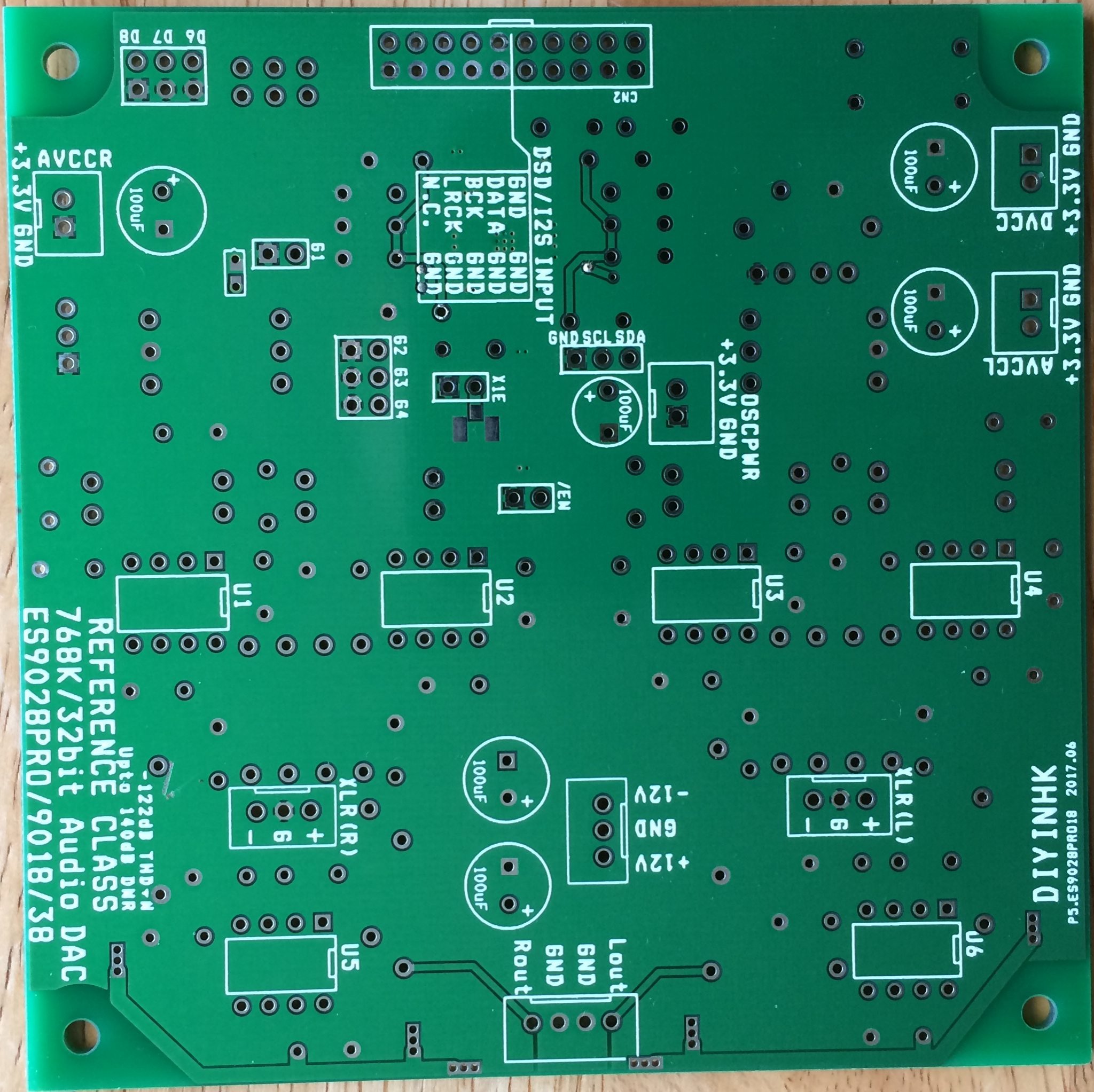

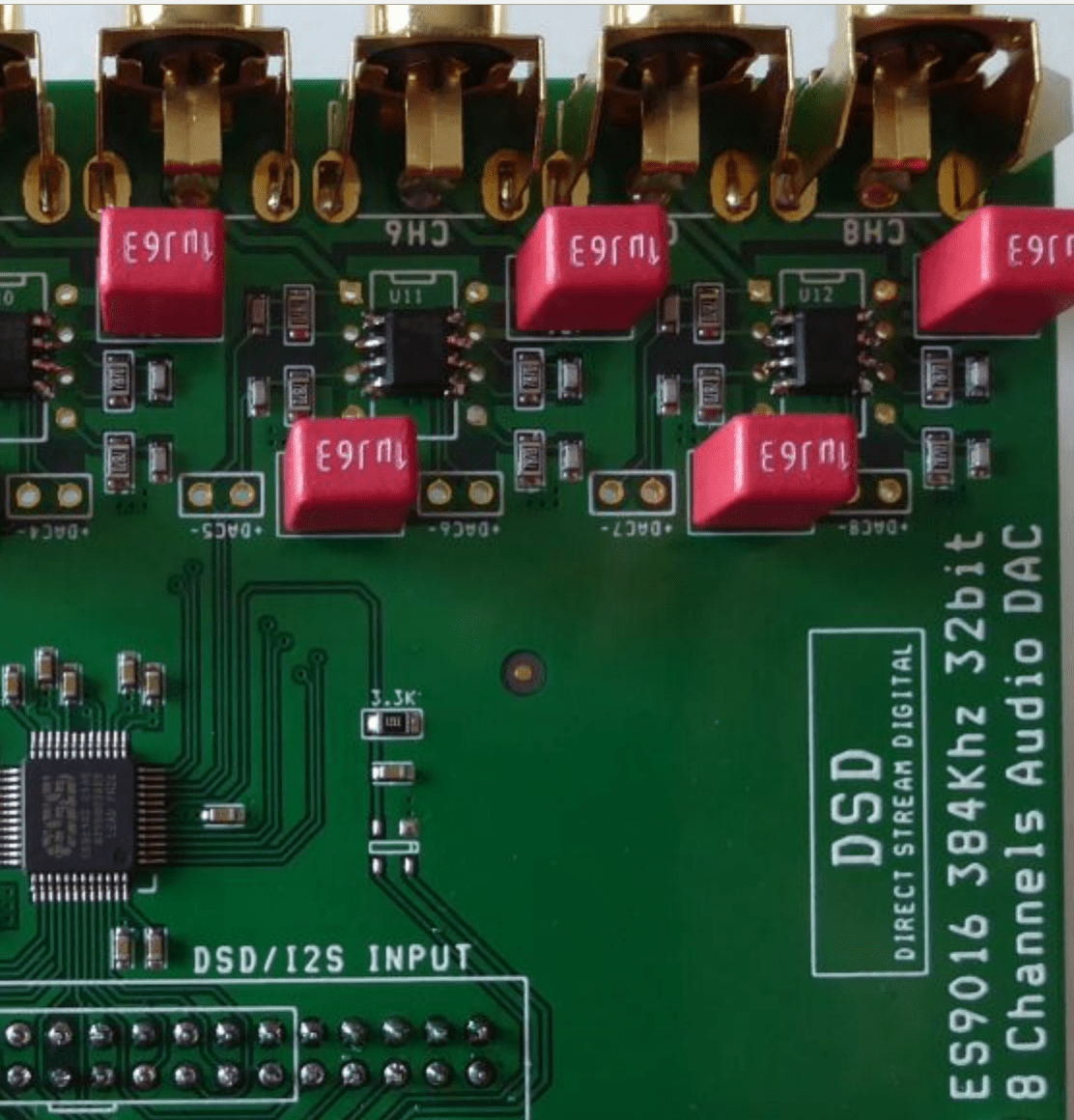

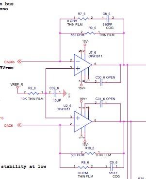

...it is not the IV stage used for the DIYINHK ES9016 DAC...
Agreed. The diyinhk board used something more or less like ESS datasheet I/V conversion and differential summing. Nonetheless, the boards themselves are poorly designed and IME they sound like it.
@InspectorGadget: The time I spent with cheap ESS dac boards was to find out if there was an easy way to make them sound better for low cost hobbyist projects. After a lot of effort it turned out there was not an easy way, although there is a hard way. Not worth the trouble, would be my conclusion at this point.
for anyone trying to go of this schematic: it is not the IV stage used for the DIYINHK ES9016 DAC. Can't find my notes, but certainly no AVCC connection, no coupling cap and resistors on the output. Just 780 ohm and a parallel cap in the feedback loop (inv), resp to ground (non inv).
Youre right, cant see any output caps. So still not really going to be truly an IV stage if its driving the non inverting input with the +out, is it?. I cant think of a way to do a 8 ch BAL->SE summed IV stage for ESS with only 4 x dual opamps. So, looking closer at the 'IV' stage. and with your description to match, it looks like the inverting side is an IV stage, but the non-inverting is not. non-inverting inputs are typically high impedance, the ESS requires to be driving a virtual ground (non-inverting, preferably biased to some fraction of AVCC. the exact voltage will depend on the dac, they are all different) so all in all a bit odd. its late here, so maybe my thinking is scrambled.and the only pics available are pretty low res.
As I understand from this image, instead AVCC connection to opamp ininverted input, it has resistor and parallel capacitor to ground, resistors are probably 780 ohm.
Yeah, thats how I understood it. So yes, the dac driving the inverted input is running in current mode, but the dac driving the non-inverting input is driving a higher impedance node, because non-inverting inputs are much higher input impedance, as well as this phase just seeing a resistor and cap to ground. the negative feedback means the inverting input node resembles a virtual ground ie very low impedance, thats the point. so this is a very odd 'IV stage' indeed. not even sure what the DAC chip would make of having such different loads on each pin. I would think the whole thing would just run as a voltage buffer, with the dac outputting voltage, but i'm not sure. Here i've just done up a scheme of what it looks like. Following is a snip of the first stage in the es9038PRO app note. obviously the AVCC isnt relevant, as they didnt add that, but you can see both phases feed the inverting node and then there is a following summing stage for the SE outputs, or just take the balanced outs directly after this (well, after the output filter)

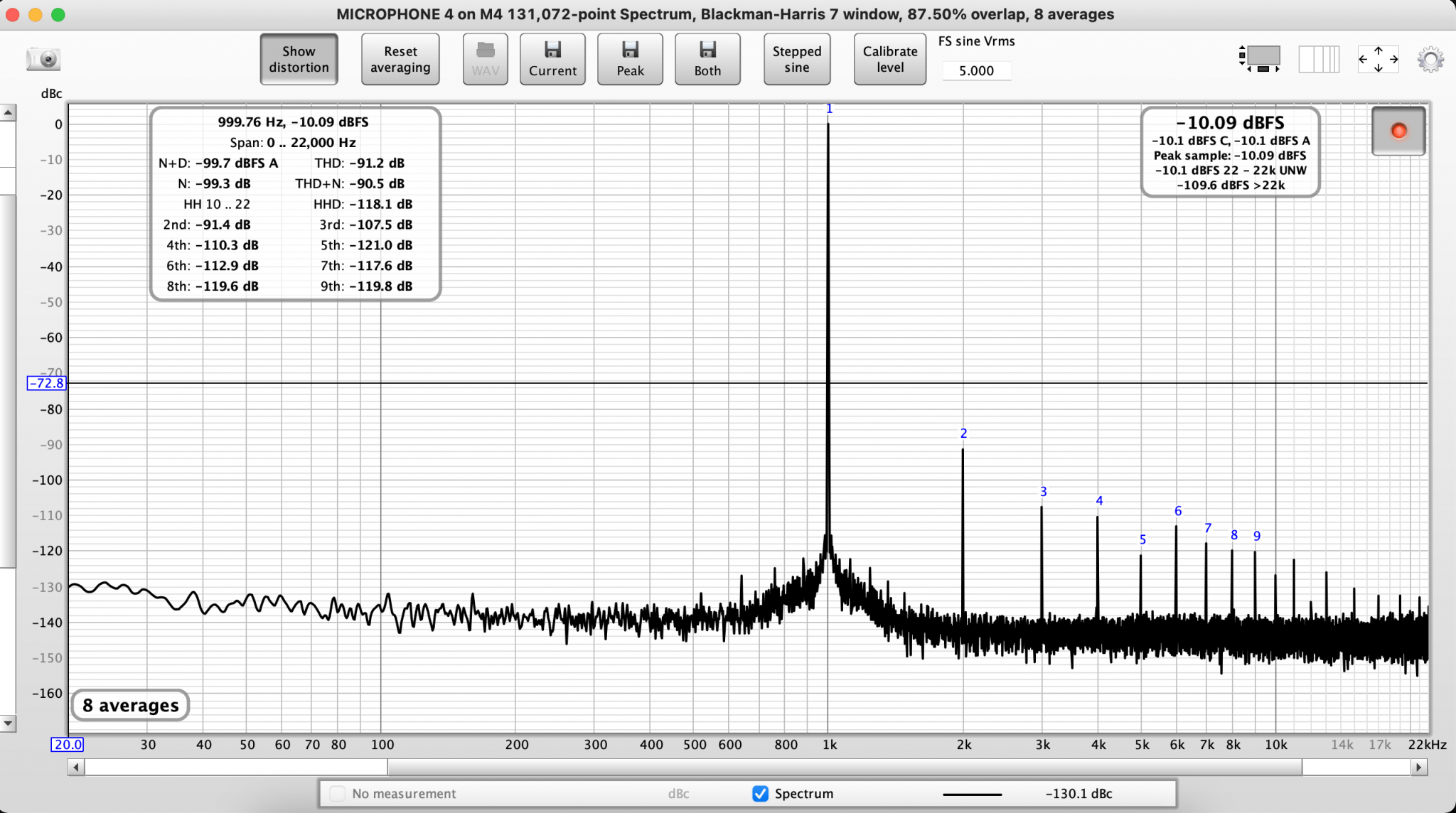

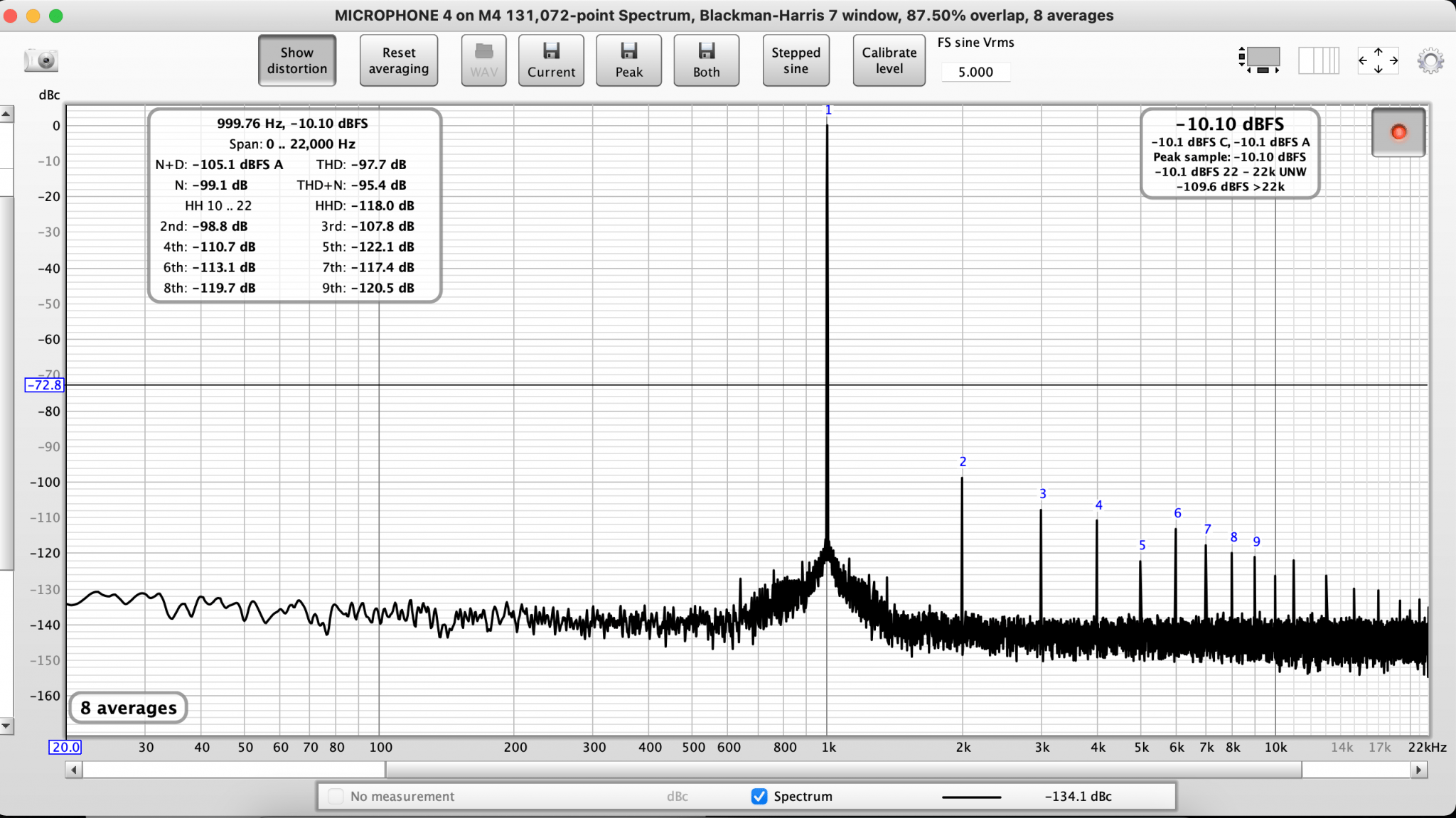

Just to clarify I did NOT say the ES9038 had better measuring SN than the ES9016. I said that the noise performance was as good as the ES9016 (of course this is limited by the MOTU M4 ADC noise) but the distortion performance was worse and well within the bounds of what the MOTU M4 can measure. In addition as discussed previously there is significant variation between the channels.
For reference here are some quick measurements of the ES9038 with the MOTU M4 with one channel driven. These measurements use the standard I/V stage and a linear power supply. Power supply wiring is directly soldered to the DAC board. Output level is full output (2 V).
Channel 1 (outer board position).
Channel 3 (inner board position).
I really do not see any reason to go with these DIYINHK DACs. By the time you add power supplies, case and I/V stages you are probably approaching the cost of a well engineered multichannel DAC like the MOTU Ultralite Mk5 and even then you have no guarantee on how it will perform.
From datasheets can be find ES9016 analog output impedance is 834 ohms, ES9038pro is 202. Maybe this is cause why with this IV stage give with ES9016 board better results, DAC chip + and - output current difference is smaller with ES9016 chip.
In this IV stage noninverted input is not grounded and inverted input will had no ground potential but even less (in opposit phase with inverted signal), in way that current from ES chip inverted output will be bigger than with grounded noinverted opamp input.

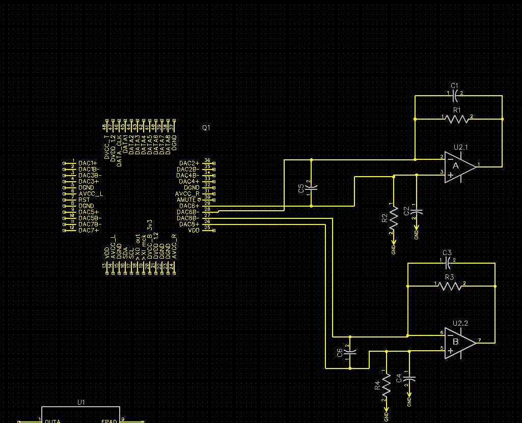

they are completely different distortion mechanisms in 9016 and 9038. 9038 board outputs much higher current than 9016 ( havent checked to see what they do with AVCC bias if anything in the 9038 board. dont know if its exactly the same as this or not).
9016 was more accepting of higher AVCC bias (none on the board though) indirectly yes, but not for the reasons you state. the 9038 wants about AVCC/3 bias on inverting inputs to avoid the IMD hump being visible above the noise, but the output still swings around AVCC/2 (close) the remaining current is then supplied from the IV stage opamp negative rail. 9016 is the same, but it wants closer to AVCC/2, for different reasons.
When running in 'current mode' and 'voltage mode' its not so much that the DAC puts out more current, its that more of the same current is converted to voltage in the DAC, depending on how high the resistance to ground it sees is at its output. As a trans-impedance stage neg feedback node acts as a virtual ground, or maybe better explained as a virtual short to it (it has nothing to do with being connected to ground), this resistance is made effectively very small compared to the dac output impedance, so current flows and the opamp measures the voltage difference between its inverting input (virtual ground) and its output across the resistor. on the non-inverting rail; the dac sees a resistor to ground in parallel to a very high impedance, thus effectively just sees the resistor to ground and this voltage is what the opamp sees and compares/adds voltage across its negative feedback loop. so its the distortion that will be different on each phase and therefor not cancel much, including the distortion and noise from the AVCC regulator; as the loading on each side is different. That is but one (the main) mechanism, I suspect.
the 9038 board outputs about +/-15ma, so depending on the opamp used, this, along with having to source some of the dac current too, mean that some will be operating outside their capability. with the 9016, the current is much smaller (about 4 times), so the opamps will handle it comfortably. I cant remember how profound the difference in performance was with driving a virtual GND at 0V vs biased, but it was significant. its unknown quantity makes it difficult to describe the whole theoretically.
both halves of the DAC are swinging around the same AVCC/2 mid point (this is simplified, the equation is a touch more complicated than that) there will at least not be a DC offset. both + and - dac output swing around a middle point between AVCC and GND, usually 1.65VDC. this has no effect on the voltage at the inverting input node of the opamp, its negative feedback is constantly adjusting to the center voltage of its own rails, unless you bias it with positive feedback of a fraction of AVCC. So for best results, it is better if the DAC sees a virtual ground biased to the same potential as its own internal virtual ground. ~1.65VDC, vs 0vdc virtual ground we see on the 9016 dac (I havent worked with this part specifically, just 9018/9012/9028/9038q2m they all want slightly different bias for best performance)

please read these 2. it will see these 2 circuit types on each input.
https://ultimateelectronicsbook.com/op-amp-transimpedance-amplifier/
https://ultimateelectronicsbook.com/op-amp-voltage-buffer/

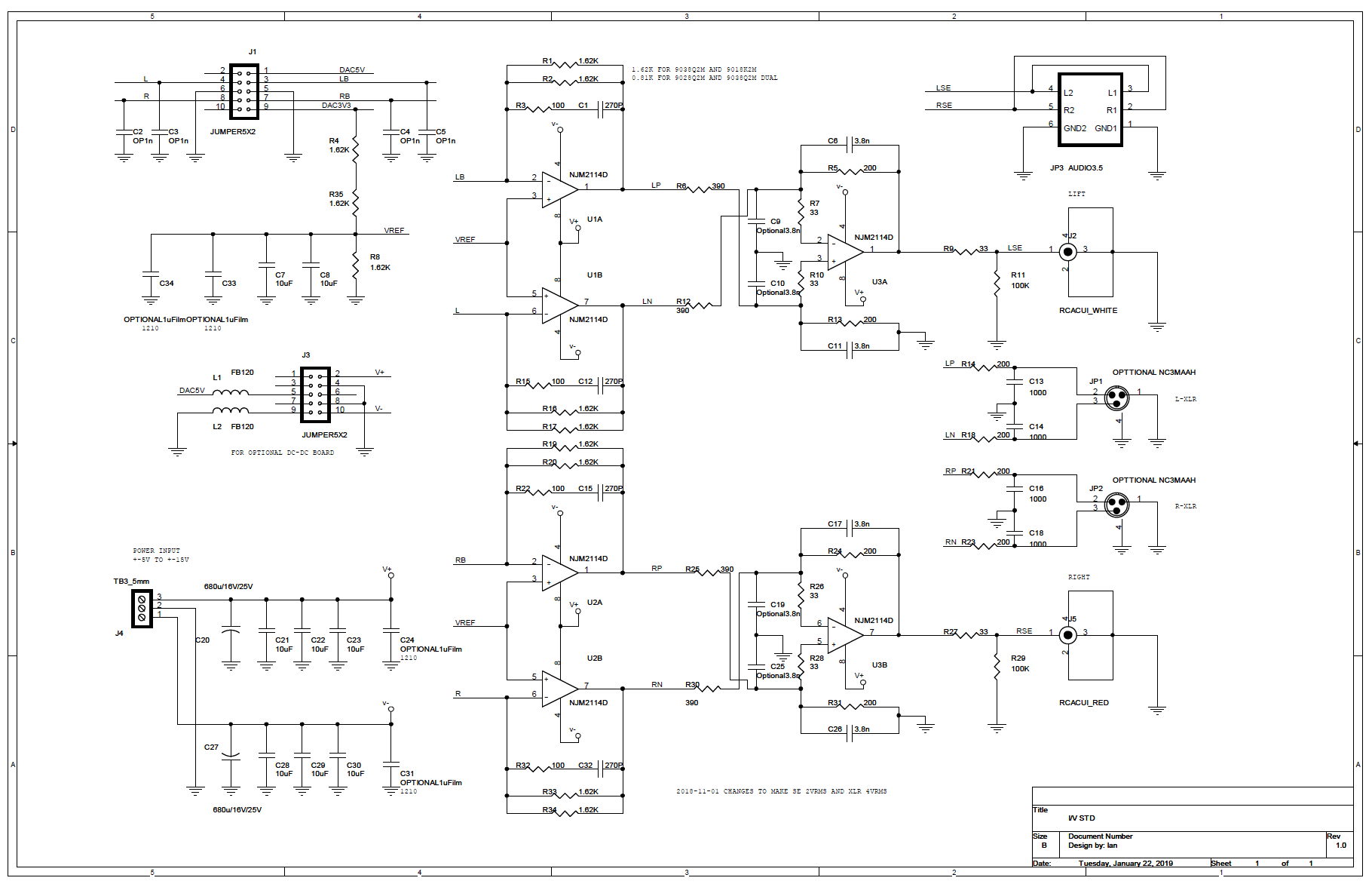

Iancanada output stage schematic attached.
Links not workinig, so some more pics below about dealing with noise problems when connecting Ian's dac stack. Basically there was noise coupling between the boards that was easily audible. Even with a ribbon cable to add some distance between the dac board and the output stage board, I found that folding over and taping the ribbon cable in a certain way canceled out some more noise. The other pics shows the dac board being separated from the FIFO_Pi by a right angle adapter. Some of these discoveries preceded Ian's development of some shielding solutions that are available now.
EDIT: Rotated schematic for easier readability.

cool, so the connection is there at least, with enough opamp channels to manage it properly.
just glanced, so sorry no feedback and havent read any links. its bedtime for me, so I probably wont, either. 😛
Mark will sort you out, but as I said, feel free to PM me. i'll have a squizz tomorrow night

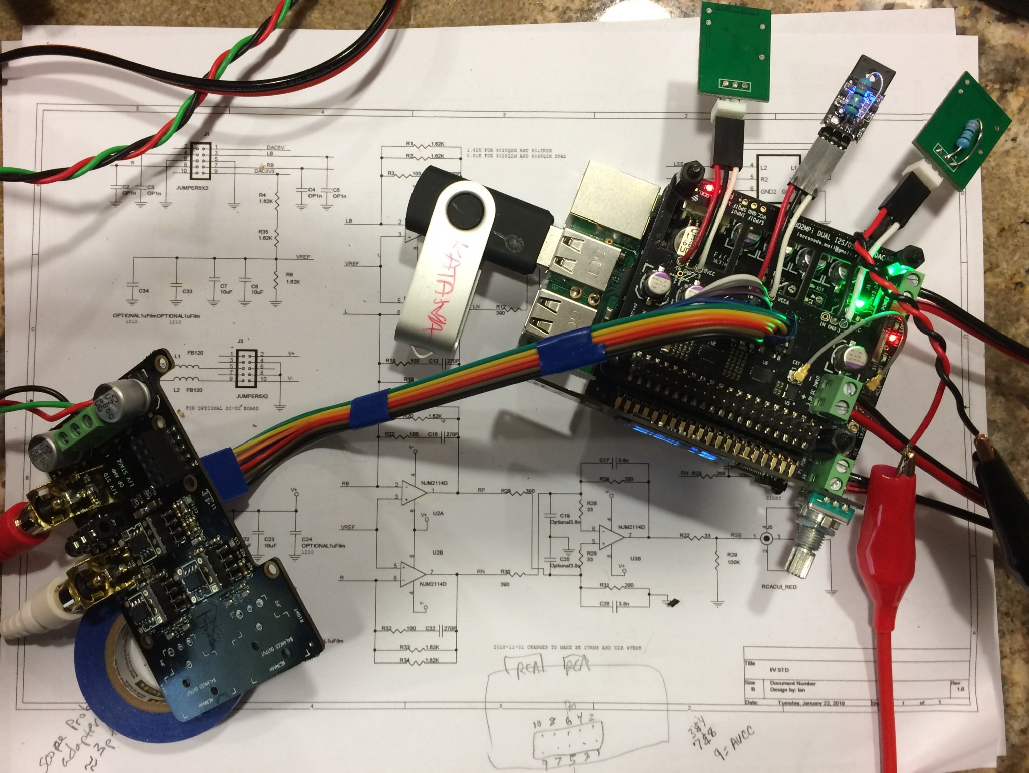

Thanks for the info guys, I have a slightly newer version of the I/V, the schematic for which can be found here -> https://github.com/iancanada/Docume...acHAT/IVboards/IVSTD/IvStdMkII_ManualV2.0.pdf.
I assume Vref is the AVCC bias and based on the voltage divider looks like it is set to AVCC / 3.
So in terms of supplying AVCC to Ian's board and the DAC I assume that I just split it at the regulator output?
I'll give it a try this weekend and see how it goes.
