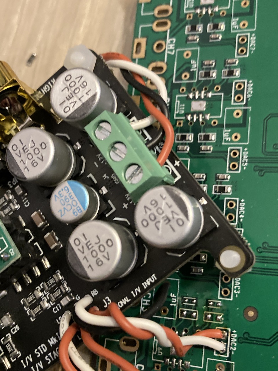

8-channel DAC + board for low-power application
All connections were made with solid 20 awg, I connected the ground from the nearest 1 uF film capacitor hole as you suggested. 3.3 V is ran from the AVCC regulator. AVCC bias left at the stock AVCC/3. Connections are definitely rather short but I think if I was going to do something final with a board I would mount the I/V boards above the DAC board to keep all the connections as short as possible.

Yes, the COSMOS ADCs are very impressive, but Ali only has the B's in stock. Will be great for AP level measurements anyway.
The opa1612 seem to be really great, I had replaced the LM4562 with these for the SE ouputs.
Good to hear Michael!
@marcelooms not that its not necessary with opa1632, its that its not a straight forward option, as they dont have an exposed non-inverting input to achieve it easily. it is doable with them, but TP probably just left it out.
I would not say that -101dB is exactly close to -110dB, but it is much better. I dont have info (for 9016) on what the pure 2nd H THD (without noise) of -119 is close either, but I wouldnt think so. typically these would also all be minimum 10dB better and those will not be so limited, without noise.
actually no, its not that much better is it Michael? its about the same total, just with a more suitable output voltage and some harmonics higher, some lower and a lower pop on turn on/off. it is much better than the 9038 board, but it always was.
OK went back and looked. ~5dB improvement, not bad. wasnt much difference between the 2V and 4V output measurements.

Yeah, I would have said 5-6 dB THD improvement which in my books isn't a huge improvement. I think that elevated 3rd harmonic after the removal of the feedback resistors may have been the result of the ADC and the higher input voltage, when I reduce the level in REW by 6 dB to get a 2 vrms output I still end up with a -130 dB 3rd harmonic and the overall THD is just a tad better.
Will be interesting to see if / how the noise performance changes. I also popped in some op amps I had laying around and measured THD at 1 kHz at 2 V (-6 dB) and 4 V, here are the results.
OPA1612
4V: -111
2V: -110
NJM2114D
4V: -113
2V: -107
LM4562
4V: -110
2V: -109
NE5532:
4V: -108
2V: -105
NJM2068DD
4V: -106
2V: -107
Michael

InspectorGadget did describe Syn08 findings about ESS dac output stage bias earlier in this thread.
To summarize, if left floating ESS dac outputs are ramped up to AVCC/2 by the dac chip. ESS uses op-amp I/V to hold the dac outputs at that voltage. Other people have found that hump distortion changes and can be improved by reducing Vref. Doing so introduces a DC offset current in the dac output that the I/V amp must supply. For such reasons some ESS dac designs set Vref to AVCC/3. For ES9038PRO, Syn08 found that going a bit lower offered some further improvement in measurements. I have not seen any discussions at to whether or not SQ is at all affected.
With a DIYINHK 9016 board on its way to me I have been doing some digging on the subject. Yes, I realise that, justifiably, its not seen as a well implemented multi-channel DAC here, but its certainly the cheapest (I already everything else other than the DAC/XMOS boards) if not the only option available to me at the moment. Maybe a Motu Ultralite in my future but not for a while.
So regarding the output stage (I won't call it an I/V stage), from what I have read I believe that DIYINHK is treating the DAC as voltage output and the output stage is intended simply to convert the differential voltage into a single-ended output. Whether or not this is achieved in the best manner with this implementation is another matter. I have found circuits for such a stage and they pretty much match what is being done here, won't bore you with the circuits I found.
