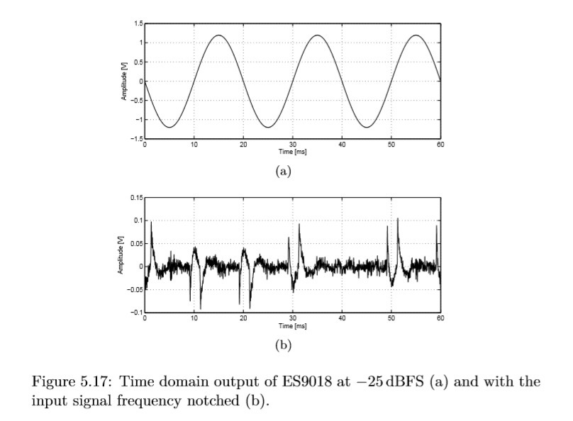

IME Gadget is quite right about ESS recommendations, AVCC regulators, and PCB design. Unfortunately, some of the audible effects are not so easy to measure; not every problem shows up as spurs on an FFT, nor in other common 'figure of merit' tests that an AP machine can do with the push of a button. IIRC non other than Scott Wurcer pointed out there is a problem of over-reliance on 'figure of merit' AP test results. He posted the pic below as an example of a useful but non-standard 'measurement.' I put the word measurement in quotes because there are no studies of correlation between the type of artifact shown and human auditory perception. So we don't know how to interpret the measurement's importance other than by subjective listening tests. Should probably also mention the particular problem shown in the pic is one that does happen to show up on an FFT, but it obviously is not due to static nonlinearity of a voltage transfer function, the type of distortion mechanism that has been correlated with human perception for sine wave test signals (a whole different problem BTW).
Indeed Mark. I hadnt even gotten into the IMD hump, which clearly isnt addressed. Not going to be able to do that when you dont know what regulator, layout, exact AVCC voltage and IV opamps people are using. the 9016 doesnt have the feed-forward THD compensation the newer parts do either (which is a bit of a controversial feature anyway, but its not available regardless)

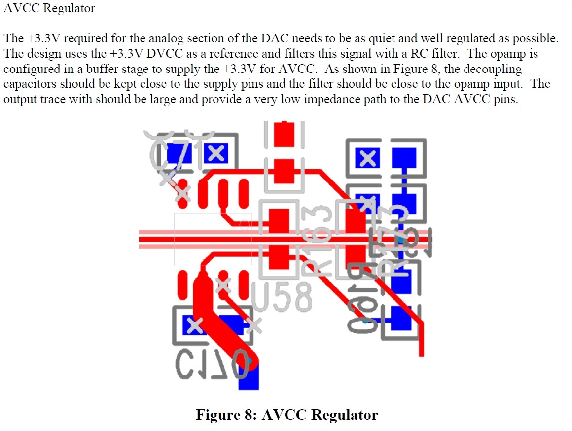

Just to help refresh memories, the document from ESS includes the content copied below about AVCC layout....Nothing about power supplies.
Hint, the current for the DAC output comes from AVCC (and, depending, the IV stage opamps). pretty sure they assume they dont need to tell you putting the regs for the most sensitive pins on the board, on another board, on the end of some wires is a bad idea.
aha, yes, there you go, they did mention it explicitly. Thanks Mark.
with reference to ground planesJust to help refresh memories, the document from ESS includes the content copied below about AVCC layout.
Yes, but that doesnt change all the recommendations (or the schematic for) for the AVCC regulator, all that remains the same. That is the current topic and that is the image Mark posted. Well, they recommend their own es9311 regulator these days, but layout recommendations should remain consistent. Detail of AVCC circuit is omitted in all 3 examples (its figure 4 in that app note, but since its not on the same board .... plus quite a lot has changed wrt our knowledge of these chips since the es9008).

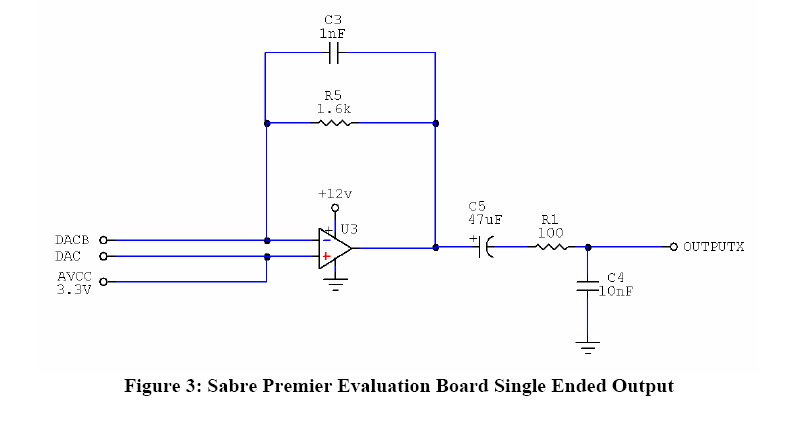

Regarding the graph you posted about the hump distortion of the 9018:IME Gadget is quite right about ESS recommendations, AVCC regulators, and PCB design. Unfortunately, some of the audible effects are not so easy to measure; not every problem shows up as spurs on an FFT, nor in other common 'figure of merit' tests that an AP machine can do with the push of a button. IIRC non other than Scott Wurcer pointed out there is a problem of over-reliance on 'figure of merit' AP test results. He posted the pic below as an example of a useful but non-standard 'measurement.' I put the word measurement in quotes because there are no studies of correlation between the type of artifact shown and human auditory perception. So we don't know how to interpret the measurement's importance other than by subjective listening tests. Should probably also mention the particular problem shown in the pic is one that does happen to show up on an FFT, but it obviously is not due to static nonlinearity of a voltage transfer function, the type of distortion mechanism that has been correlated with human perception for sine wave test signals (a whole different problem BTW).
This graph comes up from time to time - I never was sure what this should show and TBH I highly doubt that this is a real measuremen.
Top graph has a resolution of 0.5(Volts?)/div. Bottom graph shows a resolution of 10x that, 0.05/div. The noise there should be clearly visible on the top graph as well. Also the bottom graph shows spikes with a distance of ~2ms - I would not call that HF noise, rather 500Hz which is smack bang in the middle of the audio frequency range. So what's going on there?
for anyone trying to go of this schematic: it is not the IV stage used for the DIYINHK ES9016 DAC. Can't find my notes, but certainly no AVCC connection, no coupling cap and resistors on the output. Just 780 ohm and a parallel cap in the feedback loop (inv), resp to ground (non inv).Had you noticed that both DIYINHK 9016 and 9038Pro boards had only one opamp per cahnnel, so probalby analog part schematic is like this
@Tfive Oh its definitely real. I believe the actual measurement was made by Samuel Groner @scott wurcer has more detail on the setup; I believe it was a time domain measurement and perhaps he may send it privately. He is not only very competent; he has no reason to make this stuff up, as he may have even copped a little professional flack for posting it, so I wouldnt ask him to comment or post publicly. Its not the same as the IMD hump we experience with the newer models. He does discuss it in more detail somewhere here and also on ASR, but perhaps he can chime in here, or perhaps PM myself or you. Not so relevant now anyway, more of an academic interest.
