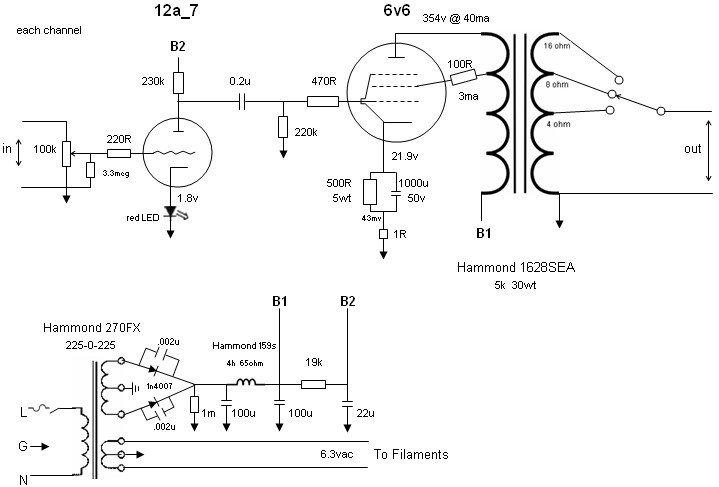

My audio amp is similar to the OP's Plan A. Haven't measured it's output but I should now that I have a signal generator. Sounds like about 5 watts. I had to add the choke as hum was audible without it. The goal was to keep it very basic.

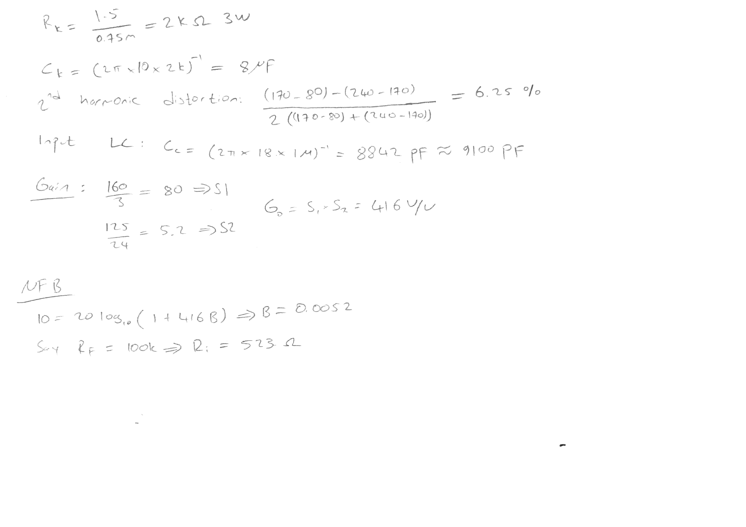

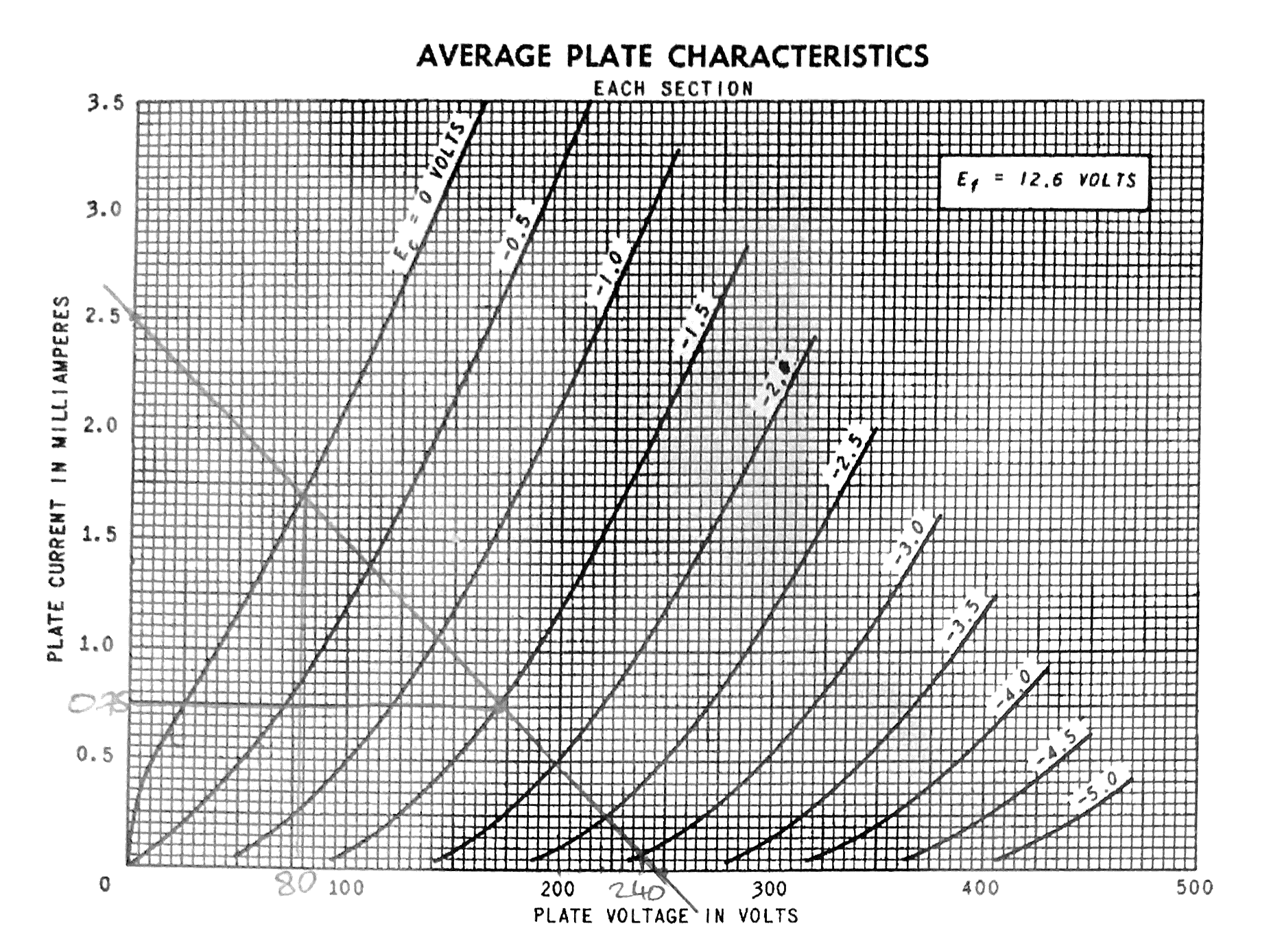

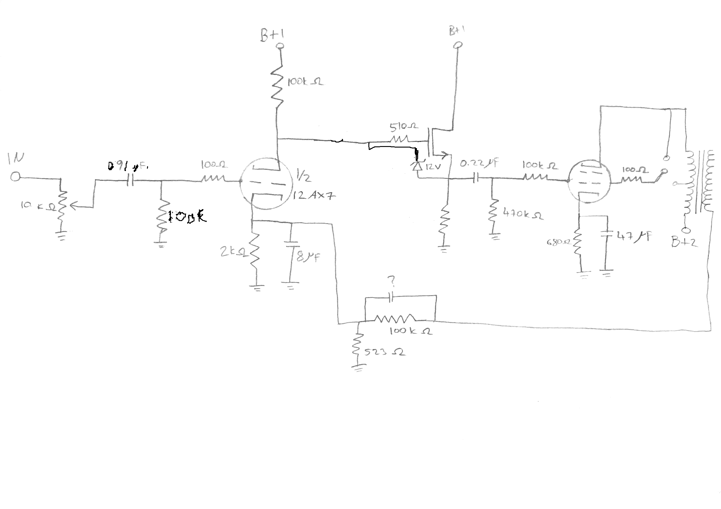

Today, I've tried to design the rest of the amplifier (except the PS). I'm attaching my loadline for 12AX7, calculations and overall schematic. I've removed the grid potentiometer at the output. I'm not sure whether to leave it or not. I've recalculated the NFB attenuation for current gain. I'd be happy to hear any feedbacks.
PS: In schematics, B+2 is 300V and B+1 is 250V.

I revised the signal schematic. Neaten my poor "hen scratches".
Most of the time, exceeding 100 Kohms of grid to ground resistance with the 'X7 triode is a bad idea, lest CMiller interact and cause HF info. loss. 😡 Modern, commercial, digital signal sources must be capable of driving the 10 Kohm IHF "standard" load. Therefore, a 10 Kohm log. taper volume control is fine.
The source follower is DC coupled to the triode's plate, which makes the forward bias requisite for enhancement mode devices, like the ZVN0545A, automatic. 🙂 Size the FET's source load resistor to make ID = 2 mA. The calculation is easy, as the source follows the gate and the gate is at the same potential as the triode's anode. 😉
BTW, tube control grid and FET gate stopper resistors should be carbon composition (CC). CC resistors are both non-metallic and non-inductive. While CC parts can drift in value and be noisy, in this role those factors are unimportant. CC noise is current related and the current in these situations is vanishingly small. The exact value of a stopper resistor is very rarely critical, once it is at an appropriate level. "Taller" stoppers go hand in hand with increasing transconductance.

The NFB has two issues that need to be addressed:
- the 8uF cap on the input tube cathode shorts the NFB to ground. You can take it out, or put another resistor under the Rk//8uF and connect the NFB there. Recalculate the total R for the desired current.
- the 523 ohm resistor is in parallel to the 2k R giving an effective 415 ohm cathode resistor.
Thank you for mentioning that Parafeed, it's a big mistake I've missed over there. I'll try to solve it as you've suggested.

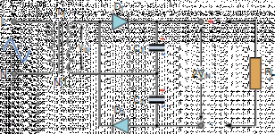

Large valued cap. I/P filters generate "hash", while suppressing the ripple fundamental. 🙁 Apply Fourier's Theorem to the "spikey" high current charging pulse waveform.
An (IMO) excellent compromise among size, weight, and cost that yields high B+ PSU performance is a well executed "full wave" voltage doubler setup. A 100 mA. supply is plenty for this project. Triad's N-68X is "perfect" for the job. 2X of this part in the doubler stack will "crush" ripple, but "hash" is present. Elephants are eaten 1 bite at a time. Follow the doubler with a LC section made from a high current RF choke and a 1000 pF. mica or C0G/NP0 ceramic cap., to suppress high order ripple overtones that could sneak into the rail via an "ordinary" filter choke's winding capacitance. Follow the "hash" filter with a LC reservoir section made from a Triad C-7X choke and a 120 μF. 'lytic.
