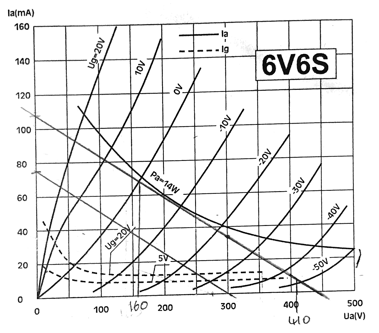

As an EE, you already know the Laws of Physics don't change to accommodate your desires. A priori, a SE 6V6 must be Class "A". The plate dissipation limit for the 6V6 is 12 W. The maximum theoretical efficiency in Class "A" is 50%. You always get less, in the real world. That 5 W. number previously mentioned is absolutely correct.
I have routinely pushed the 6v6 plate dissipation just north of 18 watts. In the last few years, I've not had any failures nor plates glowing red....Further, the first input cap I use after an EZ-81 is 100uF, not 40uF as the data sheet would suggest.....Making me believe these data sheets are like the pirates codes, "their just guidelines".
