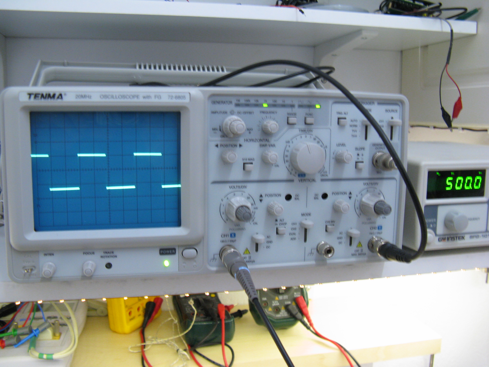

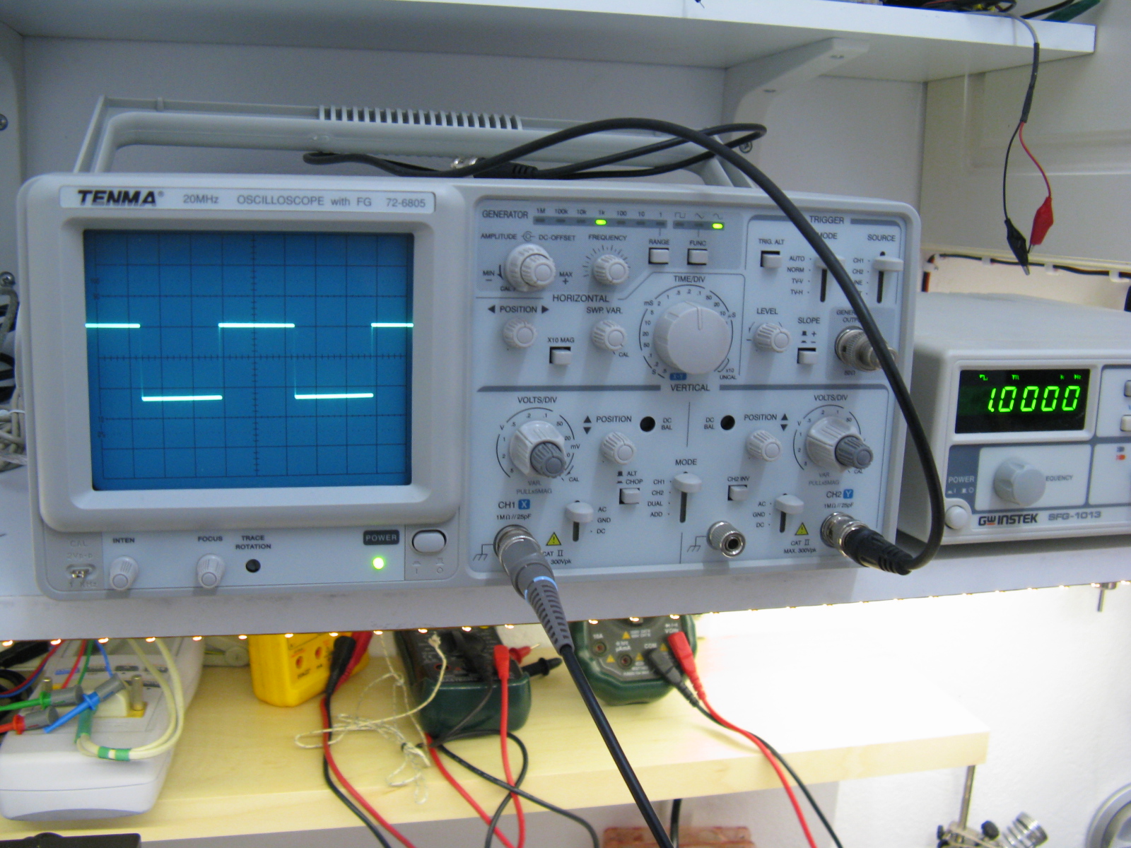

Ok, here you are.
BW more that 300kHz with resistor load.
Left photo
Right photo the..wiigglle...bliah😀

Iko, try a square with a #26 with transformer out.....not good!
Anyway, did a draft listen to it, and I think I go with resistor load. Less prone to microphony and sound is almost the same. There was an impression of more resolution with the choke, but I think it was more from the feedback of the tube and choke. With the choke, you could speak next to the tube and hear yourself through the speakers.
