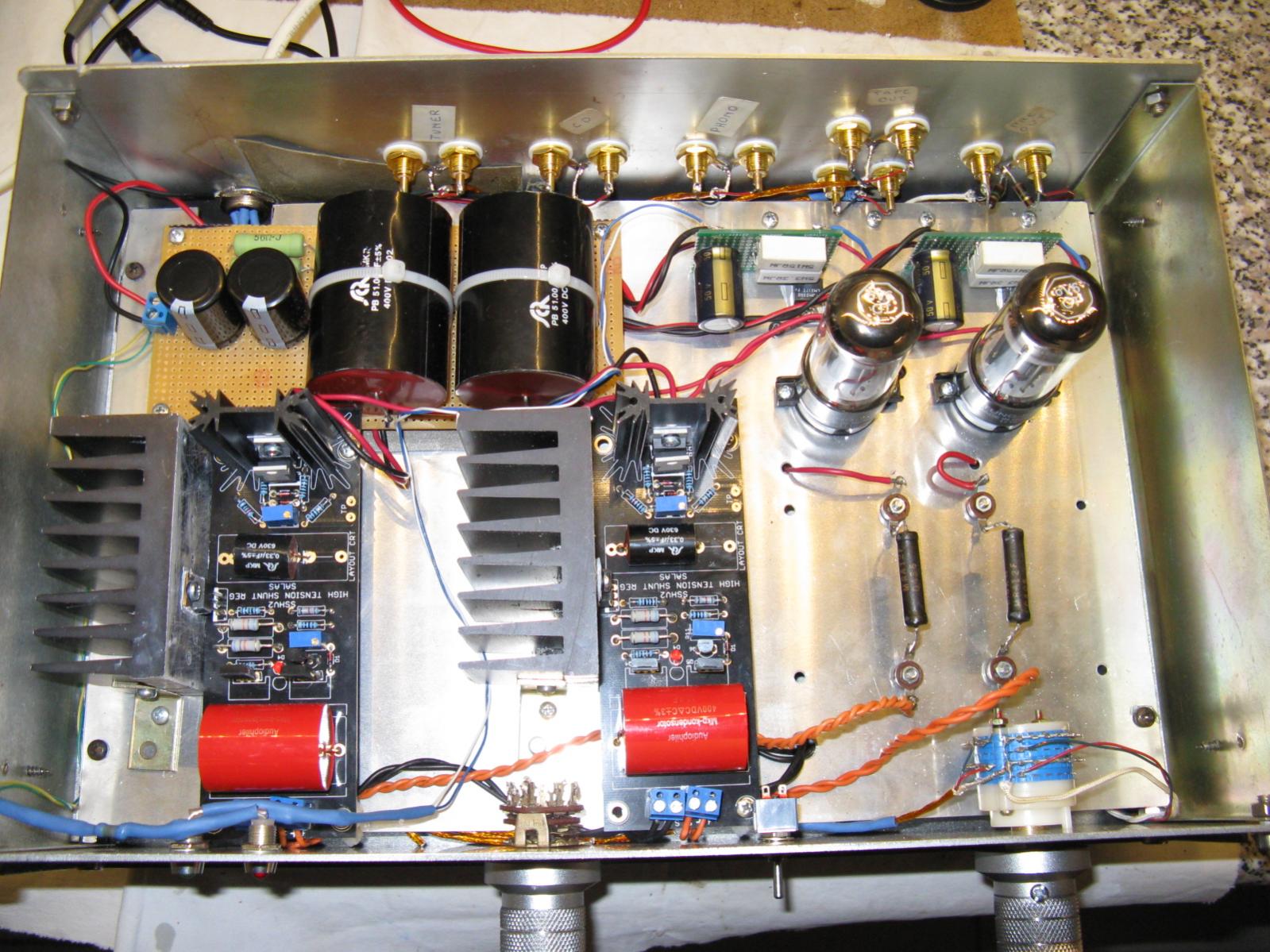

Nope, my 26 has a ixcp10m90s gyrator load and cap output. No cash for a good output transformer.

Still the wiggle was no accident, it denoted resonance that manifested in excess microphony. Choke load takes double the Ip spec and a snubber it seems so to be judged correctly. It owes to bring less THD and more gain to the plate but in a behaving manner.

Even if I solved the slight ringing on the scope, I should take extreme measures to avoid microphonies.

They were better suited to this circuit compared with the chokes I used. Maybe other chokes would perform better. Resistors were less prone to pick up vibrations mainly, that resulted in clearer sound. Still need work t do on the chassis as I said.
