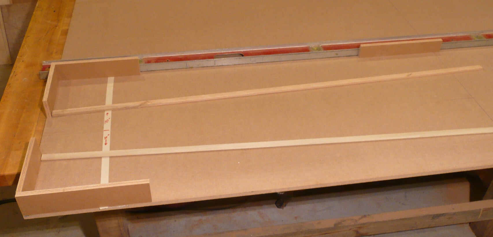

Here is my first attempt at a cut list. If another set of eyes or two could take a look and confirm that would help. 3/4 inch material.
TOP and BOTTOM
Two - 8" X 49.5" boards
Sides
Two - 11.5" X 51" Sides
S1 Endcap
7" X 9.5"
Full end cap
11.5 X 9.5"
Baffle Board
45 3/8" X 8"
Time to make some sawdust!!
I think 3/4" should be added to the width (there are 3 extra 1/4") The length of the sides would be the same, i.e. the ends go on last, but that said, you could reverse the lap joint.
I never cut both sides at the same time/exactly the same, always leave one side "big"; then I come back and router or belt sand it flush.
* The 1/2" is not bad, I'm sure you could park a car on the folded boxes; the thing is...you can't really save any $$ using 1/2", they cost about the same.
**You can come back and re-wrap a 1/2" box with another 1/4" or 1/2" layer; lap back over the joints (-; (-;

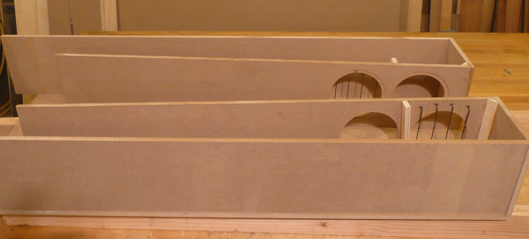

Here's and idea...save some time in the long run. I really like how 4 drivers sound together, so might as well build a "double" at the same time, sharing the bottom panel.
The OD of the box would 20-1/2" laying down on the side, using 1/2" wood
[I did run to local HD and picked up 1/2"]
The questing being...how long to make the divider piece? [shown right side of box]
The easiest way is to cut one side - 11" x 50.5". from there just lay 8" rips as shown.
I don't see this taking that long to build.
Since I'm doubling, I may run out of full length pieces for top and bottom, may have to splice a couple together.
I took one of the left over side x side 1/2" boxes in the shop....geee wizz, great bass.
So this is the direction I'm heading......:joker:

NEOREVOLIV BOX
Need some motivation? I didn't work on it that long yesterday, although I think it is over 50% finished.
Random building tips:
> Reduced the rabbit cut for the flipped woofer, for a better fit.
> I had to extend two pieces of the 8" "rips, you can see it in the pic. I used a 1/2" shiplap joint; after all MDF is 90% glue anyway.
> Used epoxy and coat hanger wire for the fish cooker grills.
> The angle cut is 3 degrees, but that might be a bit much.
Might turn the box upright and place it on 6" blocks, that would extend the "center line" (I guess)
OR...what I could have done with this double, I could have blanked the end and cut a square port on one of the sides.....OR two smaller "port holes" on both sides. The good thing here though, I can get to the woofers, with out an access door.
What do they sound like?...nothing like a 6.5 woofer :cloud9:
