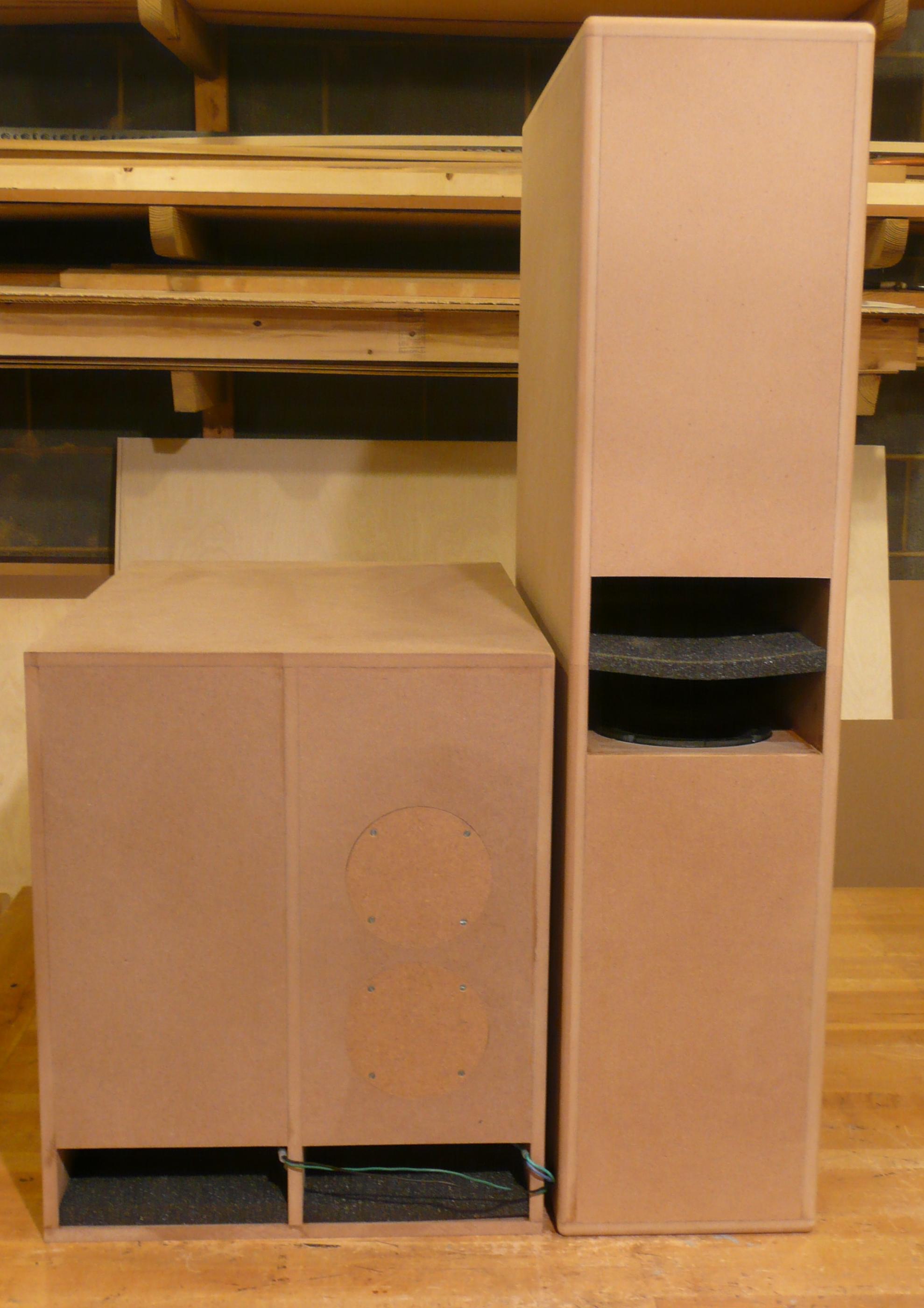

Finally got the new box installed (on right)...results?
Gesh, I think it does work better than the side-by-side.
The wood is 5/8" on the taller box, vs. 1/2" on the other.

thx for the response, i did a lil math in my head and per volume they have approx the same output.
Correct me if im wrong but would a TH have a "harder" sound that the TQWT?
It seems that a TH squeezes the driver to perform more that the taper, it that what the last T stands for, does and i think perhaps the taper has a more relaxed sound?

I guess the best way to find out what these two enclosures sound like is to build one of each, and audition both. My guess is that once you apply appropriate low-cut and high-cut filters to establish the usage bandpass they'll probably sound a lot alike.
As to the output v. cabinet volume I'll attach a quick comparison with 1ea. of the TH @ 16 W (Xmax) versus 3ea. of the T-TQWT @ 20 W ea. (Xmax). I most highly recommend Hornresp to model and compare these types of enclosures.
The whole thing becomes so much of an apples and oranges comparison, that I don't think I want to spend a lot of time on it.
Bye the way: T-TQWT Tapped-TaperedQuarterWaveTube.
Oliver...WOW!! nice surprise! Just the way permo and I envision it.
(We went to Dr.Ds build and checked it out; post #21)
http://www.diyaudio.com/forums/subwoofers/188283-fiddling-hornresp-peerless-831759-a-3.html
Thanks to you and the rest of the forum for the advice and design drawings/sims.
Btw, the taller box with the 4 woofers is crazy...what a rainmaker, just pouring out smooth, rich bass. The port at ear level worked way better than I thought it would, not a hint of mid range, etc.
