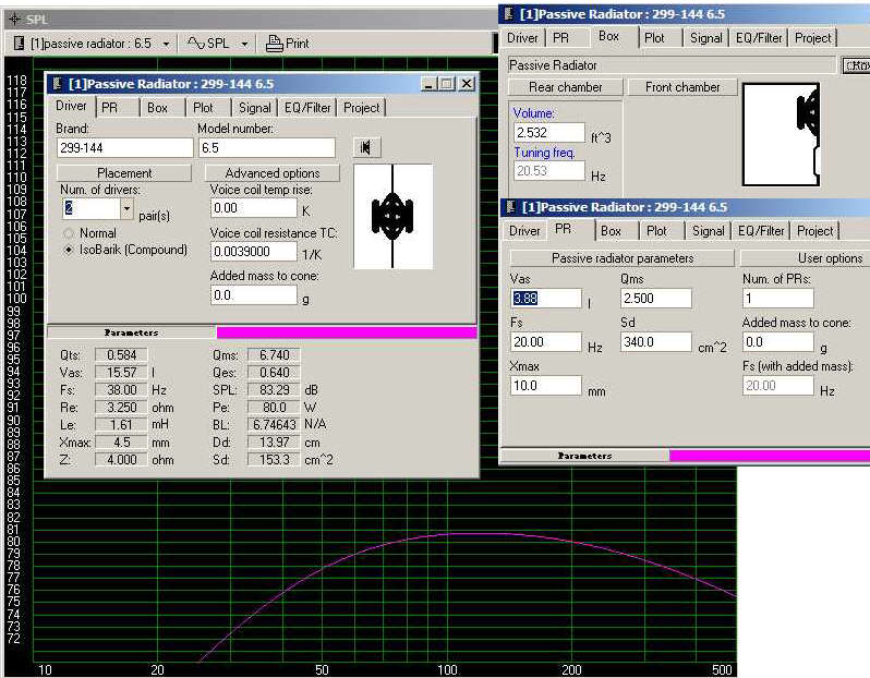

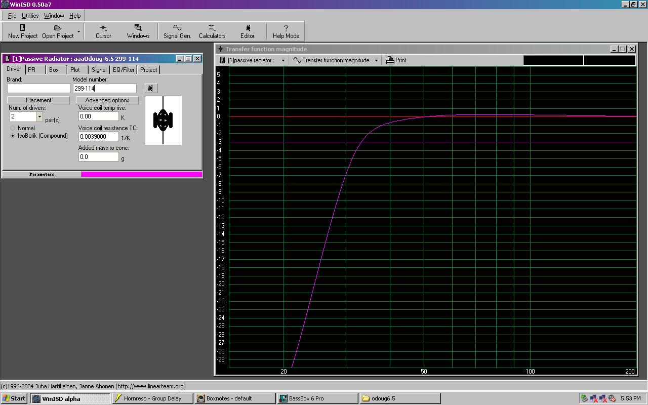

Oliver, can you check a sim please? (post #24) 4 of these drivers in a 2.5 cf box with a 10PR looks great, and no weight added to the PR.

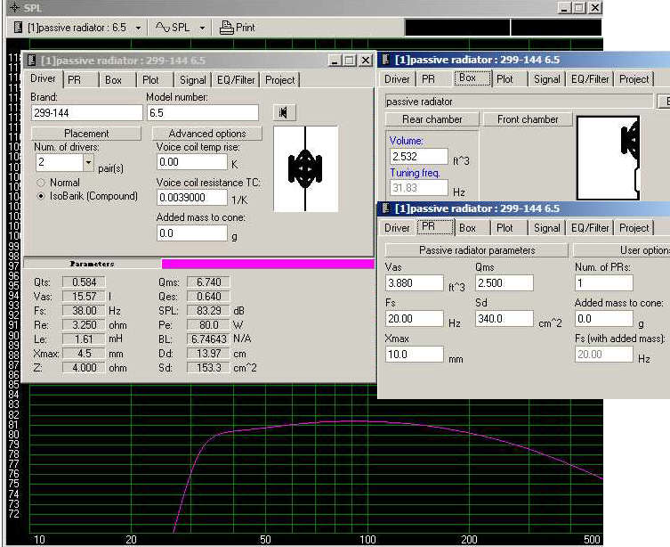

Hi ODougbo,
As a caveat, I'm not the one to ask to check WinISD simultions. I'm just trying to get comfortable with the program. Anyway, I'll attach what I came up with, and I tried to get all the entered parameters in the picture so you can compare yours and mine (I'm doing all this on the fly, and mistakes do sneak in.)
As to posting pictures: I grab whatever I need with Gandwin PrintScreen (free), arrange the individual pictures in Picture Publisher (an "ancient" copy), and post as a jpg.
Thanks for looking at that; yes there was a small error, the VAS for the PR is 3.88cf not 3.88 liters.
I should have shown the parameters also.

btw....I forgot to say Iso Box, so glad you picked up on that.

Well if i did it right...it would be a simple 2.52cf box with 2 pairs of Iso mounted woffers, and one 10" PR.

Hi ODougbo,
That litres to ft^3 think sure makes a difference. 🙂 That looks a lot better, even 2 ft^3 for the box volume would be fine. Bye the way, a single driver in the same box w/ the same PR has about 3dB more output (?). Also, when I change the Sd in the PR window it does not seem to influence the simulation (bug?).
Hi ODougbo,
The word file opens fine, and I see what you mean. As you have the box already built can you try it out with just one 299-114 (normal, not isobaric)? Would be interesting to see if that works.

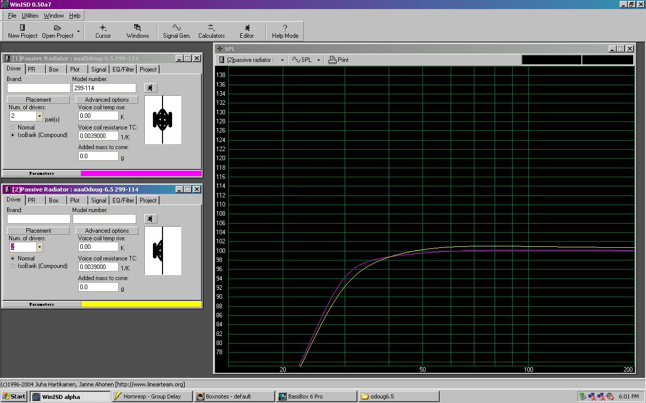

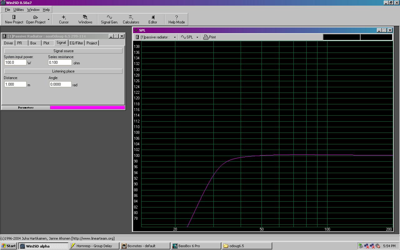

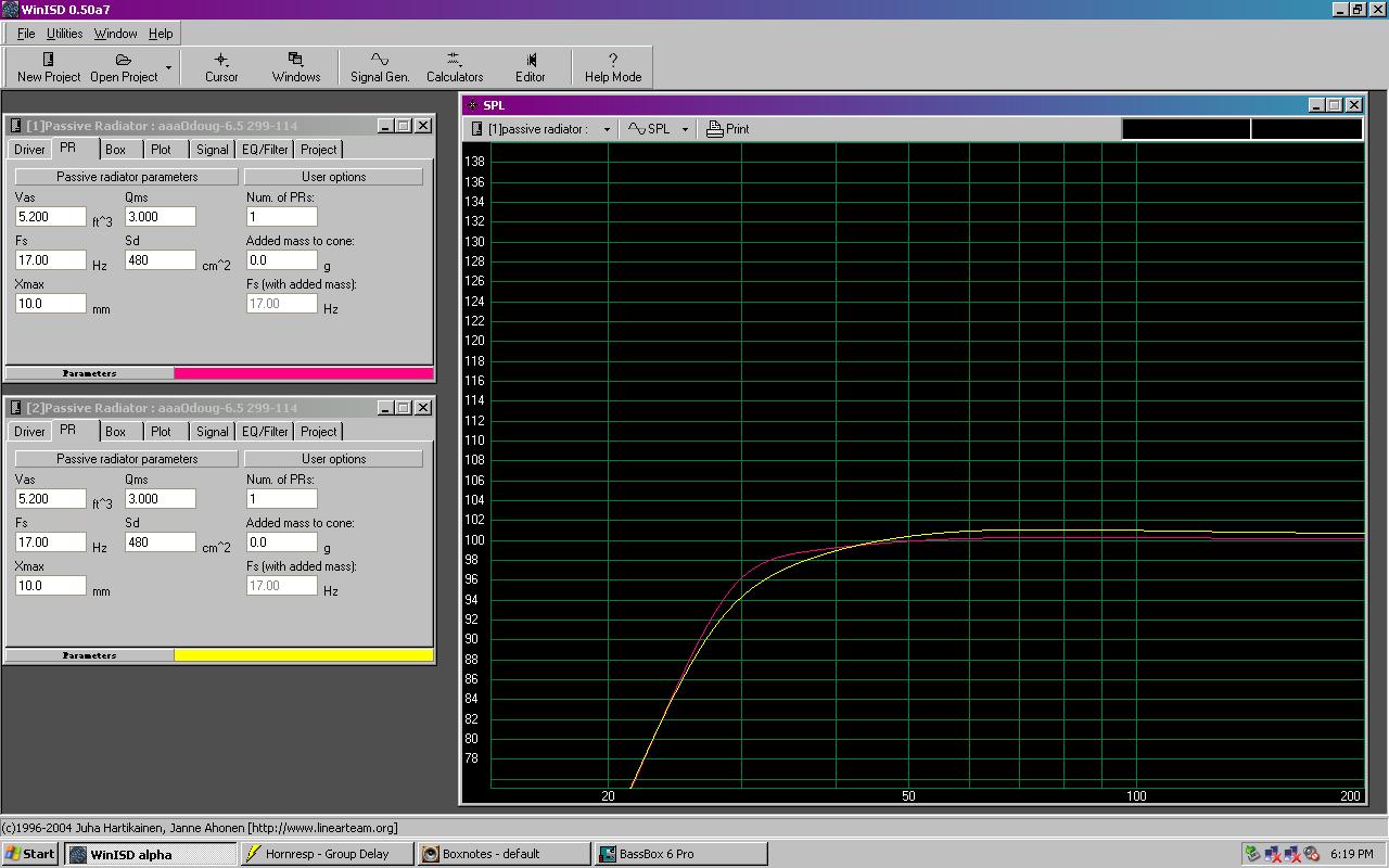

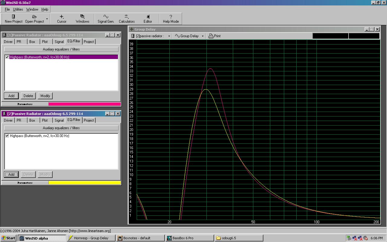

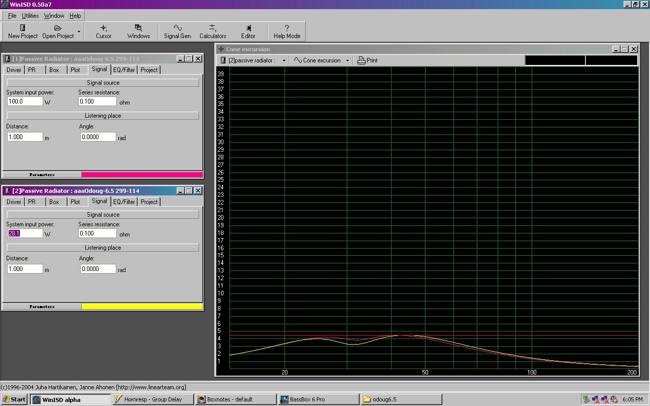

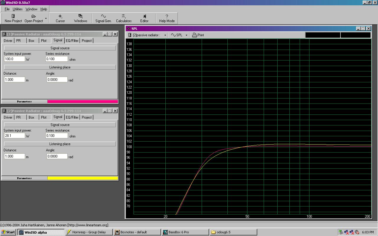

ok doug I used the 10" PR
the pink graph is the 4 driver iso
the yellow is 2 drivers normal.
If you're using windows It has a built in screen shot. Just hit the 'function' key + 'Print screen' key, then open paint and paste it, then save as a jpeg.
Thanks again Rev. Results were similar to mine. I've been toying with this idea for a while.......

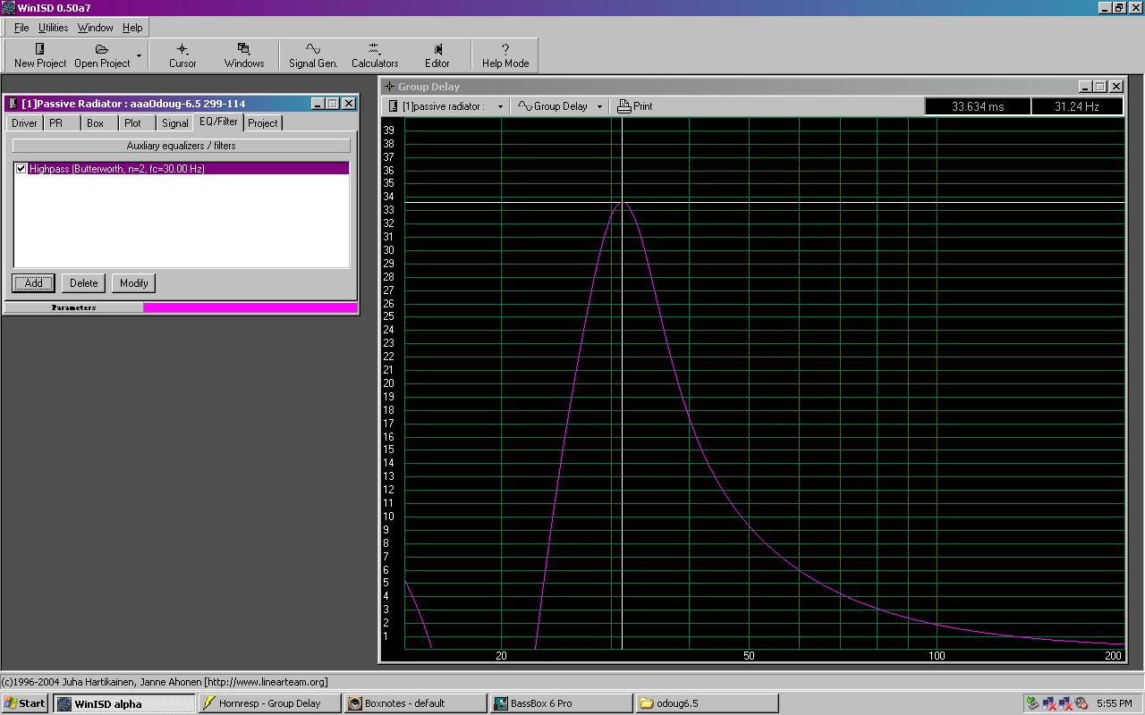

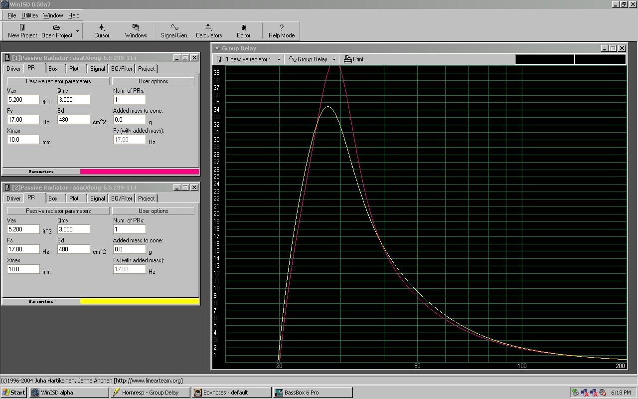

Wow that group delay is crazy.
