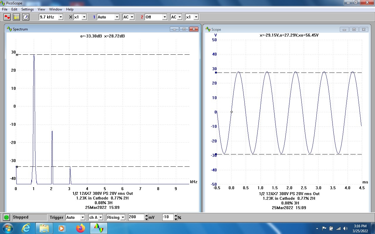

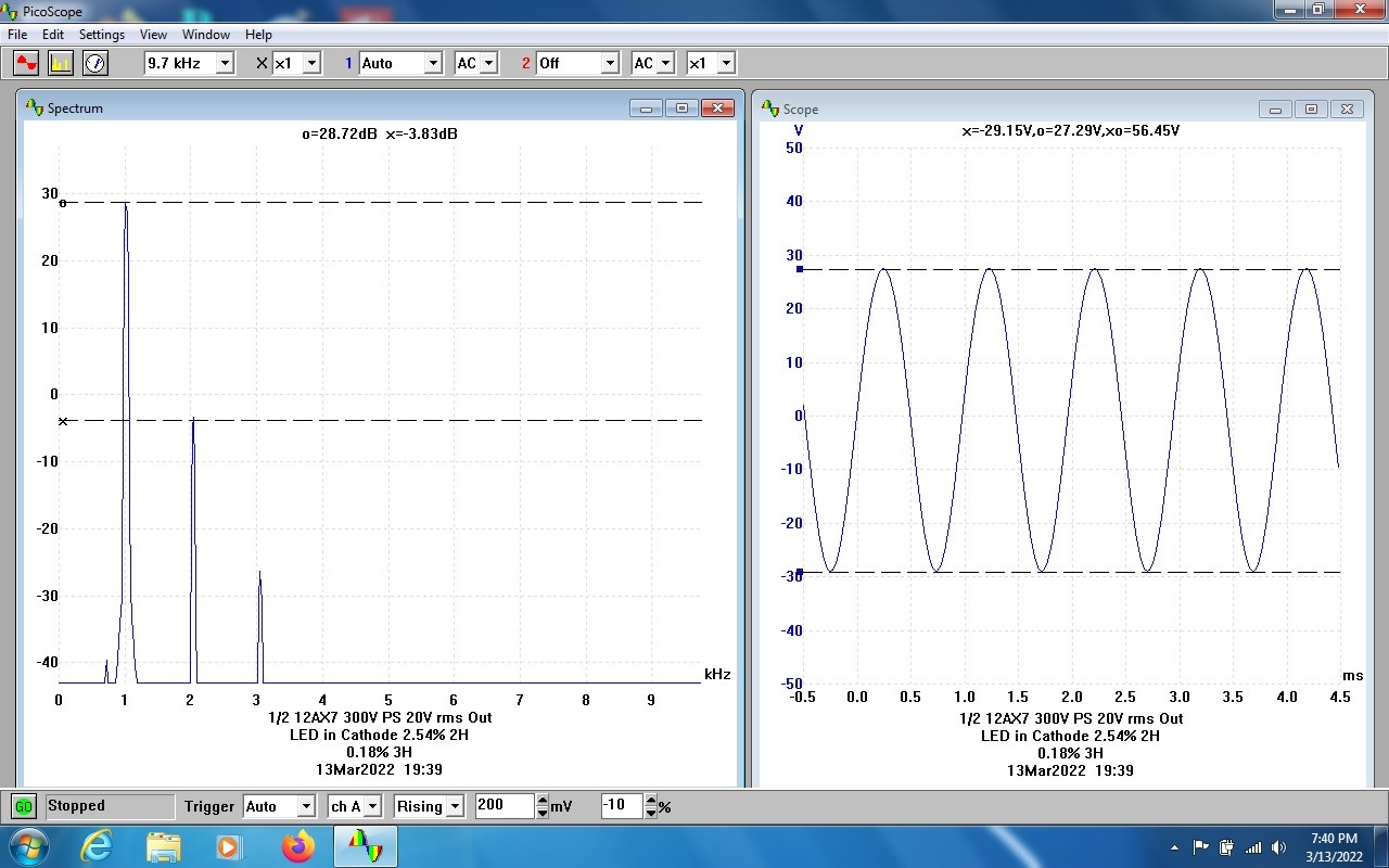

So after making so much noise regarding LED's in the cathode circuit. I guess some might say,
'OK. weise guy, what would you do'. I'd take that LED out as soon as the soldering iron got to operating temperature.
And replace it with a common resistor. Here are the results of doing just that with a 1.23K cathode resistor.
The gain is about 3db less, but still plenty to drive many common output tubes.
And the D% has dropped significantly. The Rk will also stabilize the operating point as the tube ages.
And there is plenty of room to add full NFB if needed.
The attachments shew D% results on the bench, both the cathode return as original & with the LED pulled out.

10dB difference of 2nd harmonic and over 6dB difference in 3rd for only a 3dB difference in gain? Again I worry about the valve being operated at different bias'. Assuming an improbably large cathode current of 1mA, 1K23 Ohms is a -1.23VDC bias, compared to somewhere North of 1.6VDC across the LED alone. The disparity between your results here and those in post #79 make me worry about apples-to-apples generality (although obviously applicable to the specific circuit).

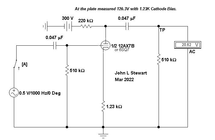

The drop across the plate resister is 174V, so Ip is 1.45 mA.
1.45 mA in Rk of 1.23K is ~1.78V.
The LED design had very little cathode resister NFB. plus the non-linearity of the LED.
Adding local NFB & dumping the LED makes quite a difference.
But I’ll take a look anyway. The soldering iron is hot & waiting for me!!

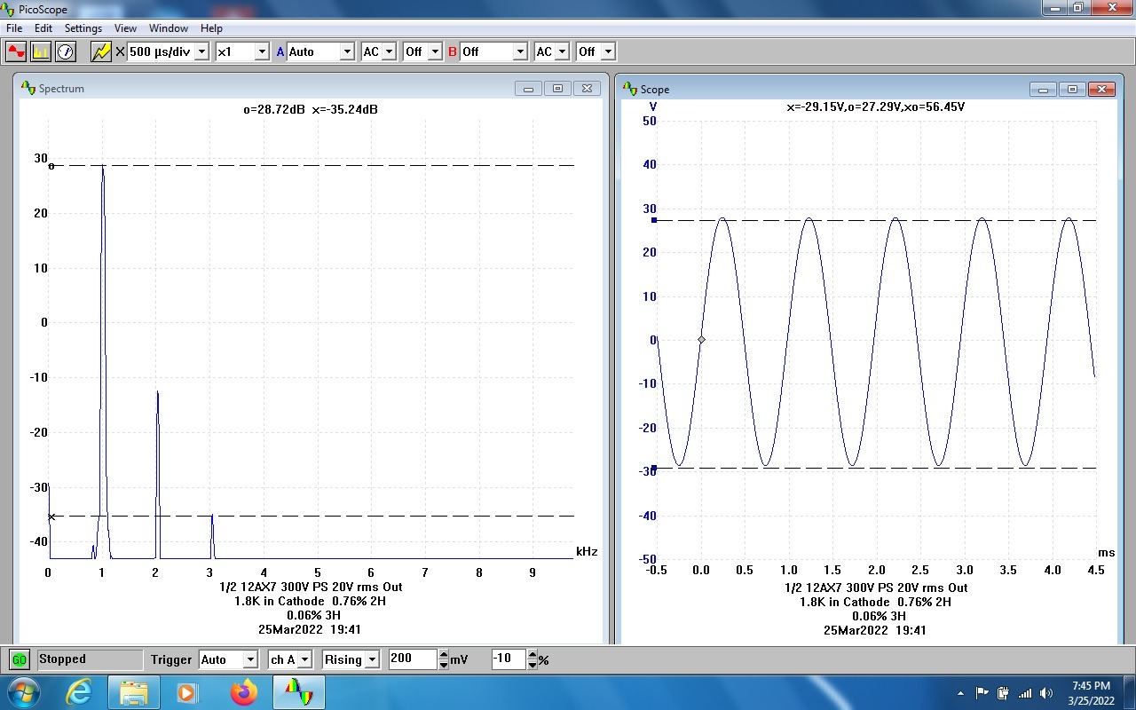

OK Chris, here are the results of the most recent episode of the 6SQ7 bare bones amp.
This time with a 1.8K cathode resister. The drop across the plate resister is 155V, so Ip is 1.29 mA.
1.29 mA in Rk of 1.8K is ~2.33V.
Gain drops a further 1.4 db. But D% is only marginally better.
I think this AX7 has run dry on 'goodness'.
All a worthwhile experiment. It probably deserves a formal report.
