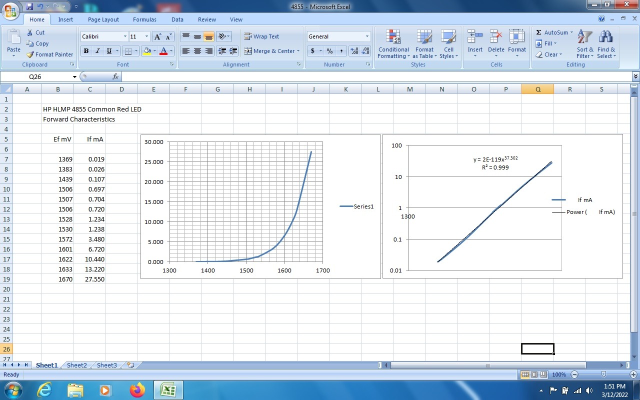

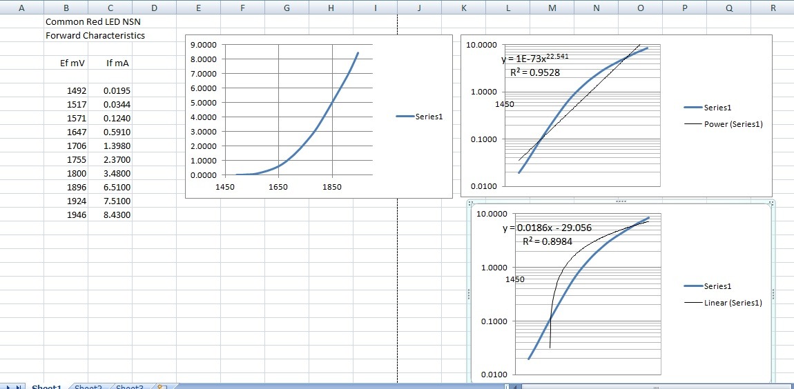

So here is the result of running forward currents thru a common red LED
picked at random from my stash of original HP parts. This one an HP HLMP 4855.
The measurement data results in a very smooth curve without the application of Cookes Variable Constant.
Both linear & log-log plots. A square law device has a slope of 2 on log-log graph. Like this one.
Will it matter in the cathode of a tube? Have a look tomorrow.

Ref: post #61
Very interesting data. Thanks very much! I eyeball this as a 9R slope at 5mA (in the knee) and 6R at 10mA (above the knee). Both of these are higher than a high mu triode will use, so this device would be operating below the knee for many applications. How much work does it take you to get this kind of data? After initial setup?
Thanks very much, as always,
Chris

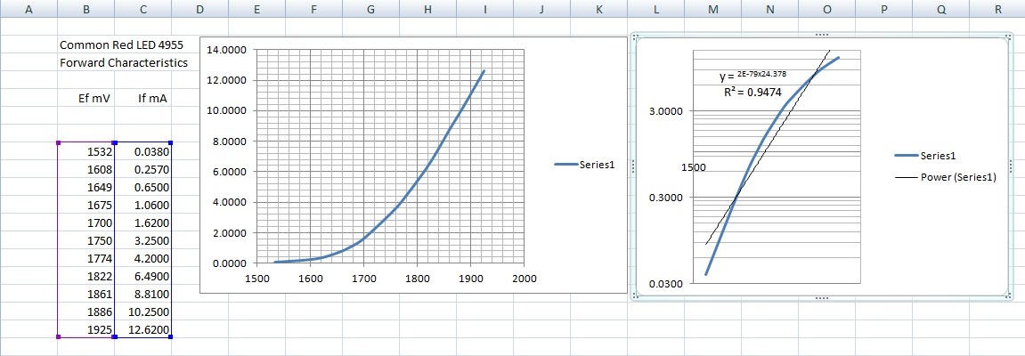

Using a simple variable constant current source to drive the LED samples, something I built about 50 yrs ago.
So setting the CC source powered up for about an hour, than set some low current to check stability.
Current & voltage are measured with separate digital meters. The LED forward voltage is measured directly
on the LED. The DVM looks like a 10M load.
The data on this run is taken from an HLMP 4955 red LED. Then into Office Spreadsheet to process the results.
The power series trend line gives the best fit. For currents from
0.65 to 1.06 mA the LED incremental resistance looks like 63.4 R
1.06 to 1.62..................... 44.64R
1.62 to 3.25.....................30.62 R
3.25 to 4.20.....................25.26 R
The cct in this thread fits that region. As the tube grid is varied the cathode current varies.
The changing current is converted by the incremental resistance to a voltage that is amplified by the mu of the tube.
That modified by whatever load is on the plate. A bit like reach thru on bipolar transistor.

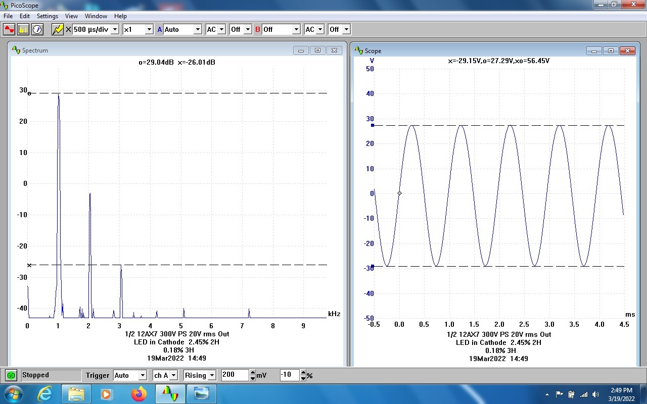

Using the last LED I ran the forward drop tests on I got some results as follows.
With a One KHz test tone an output of 87.8V p-p, 2.45% 2H.
Running the same cct without the LED I measured 97V p-p, 1.36% 2H.
The tube used is 1/2 of a 12AX7, very close to the 6SQ7 triode. Check the data sheets.
For a first look the LED biasing is not a good idea. Unless we like distortion.
I'll post some spectrum's later.

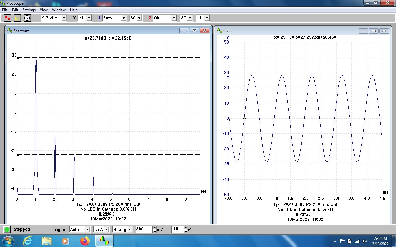

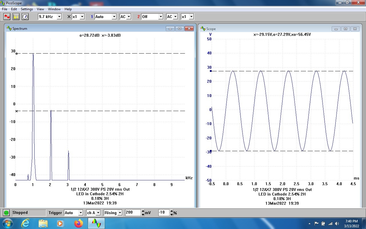

Here are spectrum's with & without a red LED in the cathode of 1/2 12AX7.
Looks like the LED causes a significant increase in 2H. The 3H is much farther down
so that THD is predominantly 2H. The cct is essentially the same as the OP for the front end of his amp.
I'll post that tomorrow.

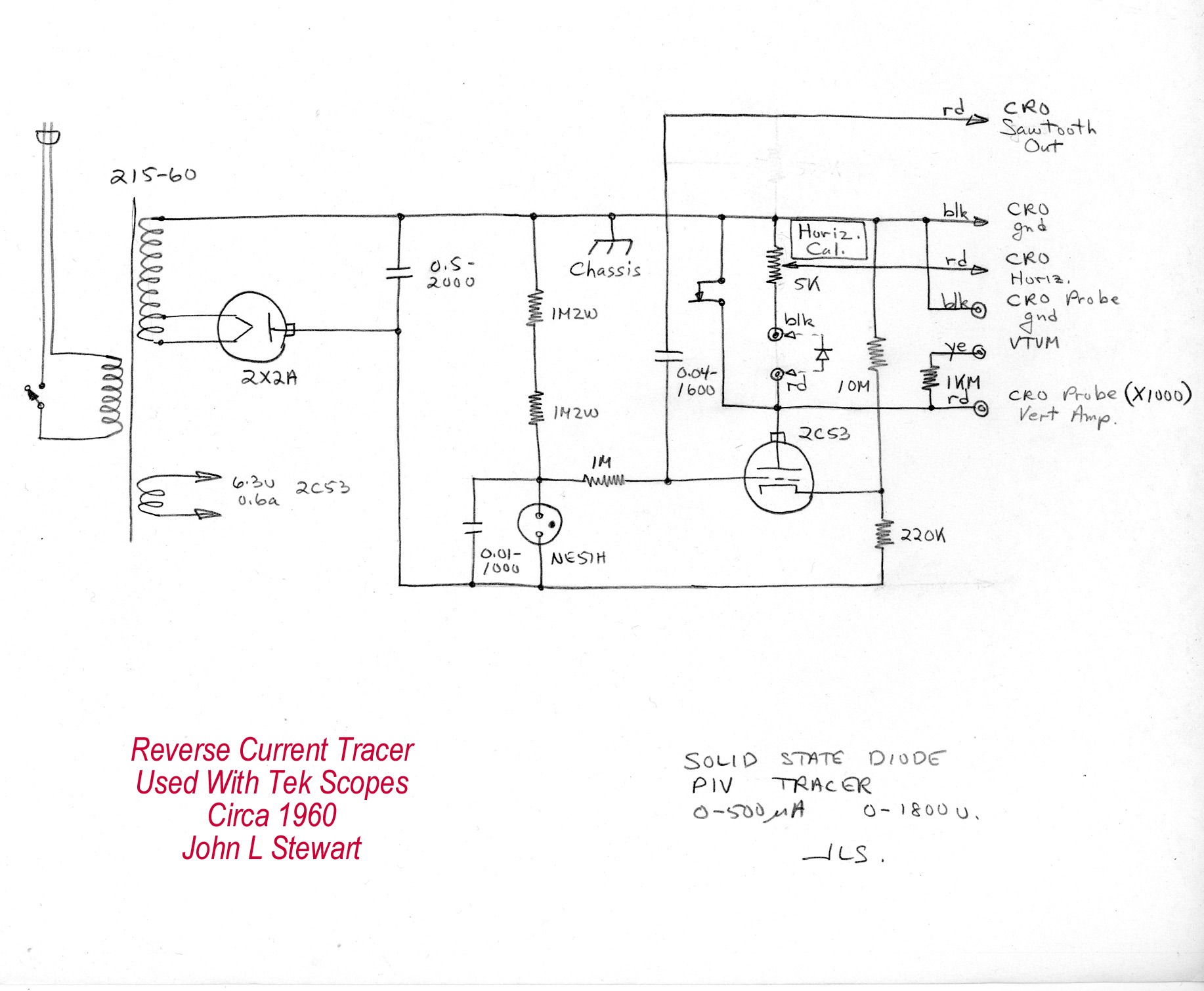

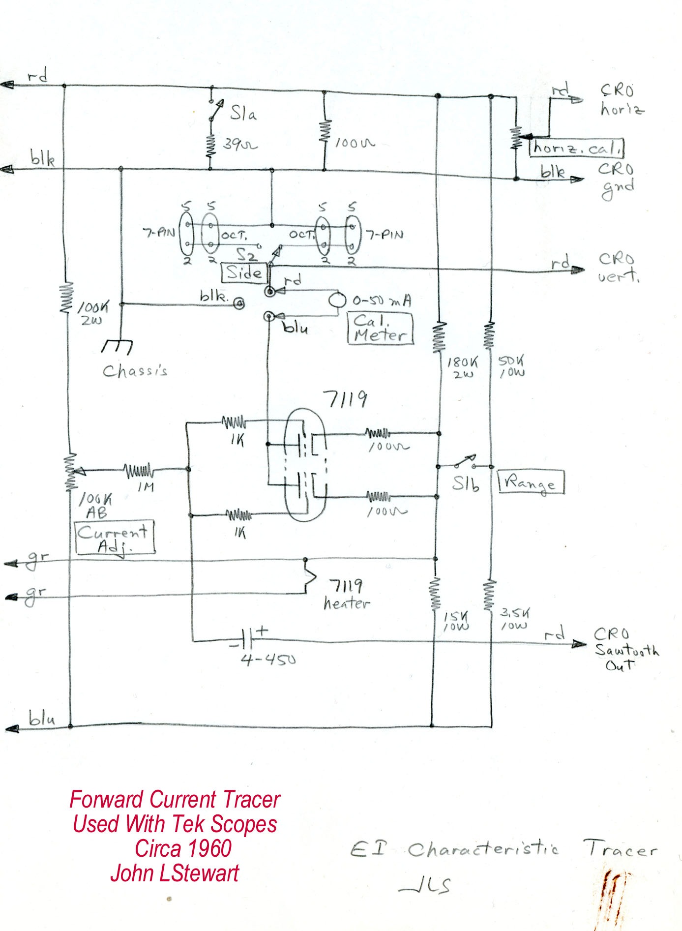

Diode Curve Tracer Schematics from the 60's, something I stuck together as a side issue in the research lab.
No photos, maybe someone put them in a museum after & left. Worked well, got fast answers on
questionable diodes. And the good ones. All from the archives.

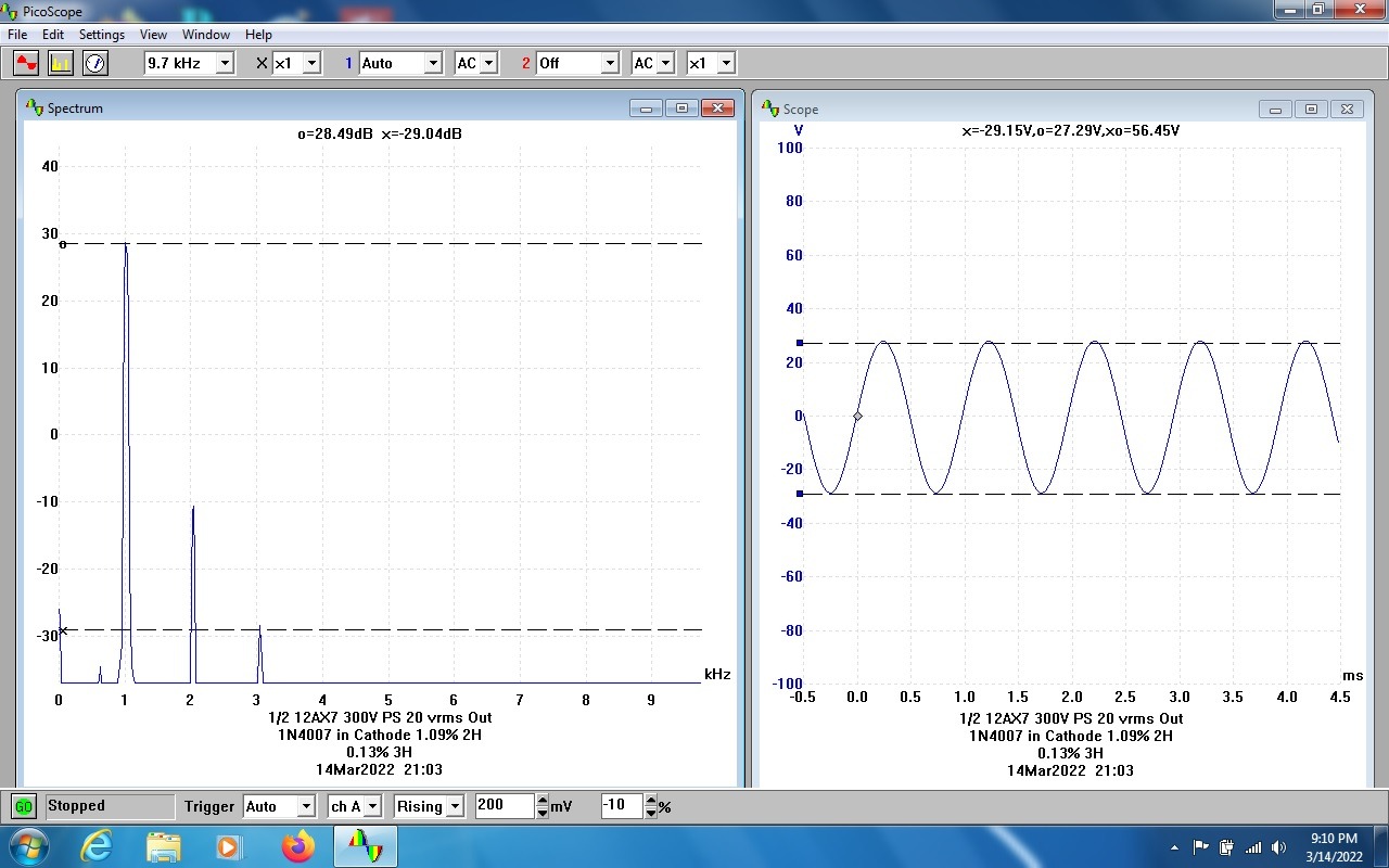

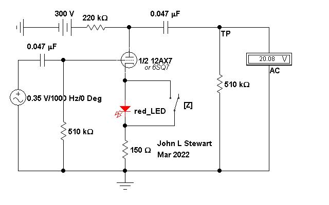

Here is the simple test setup used. The switch 'Z' in this case is nothing more than a shorting clip lead across the LED.
The SG generator is adjusted to get 20 vrms at the test point (TP), with & without the LED in cct. The PS is a regulated lab supply.
Then the FFT spectrum taken by a Pico 3224. 10 MHz, 12 bit, 2-channel FFY/Scope.

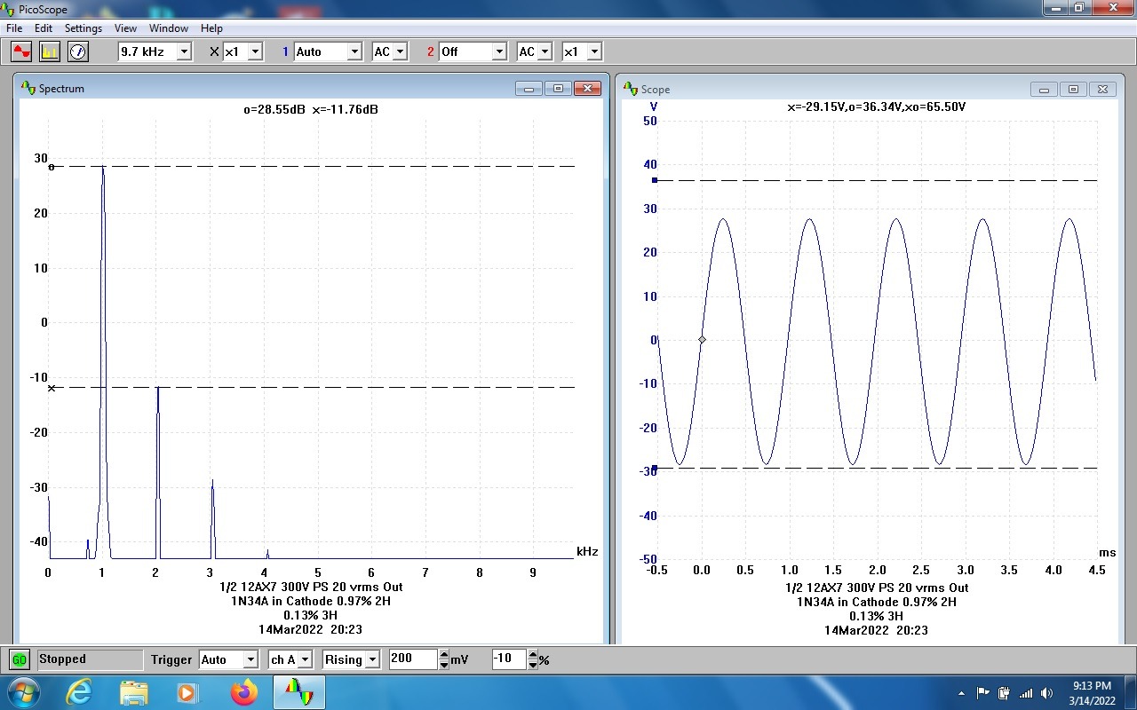

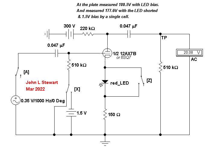

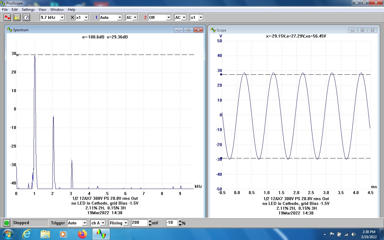

Hey Chris, of course you are correct. I figured I could get basic data needed without adjusting bias as long as the operating point
didn't move far enough to changes output level & D% a lot. To do that the signal level needs to be restricted, altho in this example
the 20 vrms (28V Peak) is enough to drive most common power tubes. So in the case of the 1N4007 in the test I've just run the
Q point moves from 105V with the diode in to 88 vols without. I'll have a look at another LED later & adjust the bias.
I'd originally planed to stuff a 1.5V cell into the grid to fix for the LED removed. That way Rk can remain the same.
So here is the latest, a 1N4007 in one test & a 1N34A in the other. All makes me wonder why we do this at all,
given it adds yet another part & in every case sofar increases distortion.
Before I got going I tried Googling to find if the work had already been done but came up empty.
Many thanks for the tests, results and discussion. So far:
- LEDs and other diodes delivering cathode bias can introduce measurable increases in distortion when passing bias current below their ohmic region (below the "knee").
- The amount of additional distortion depends on the diode used and is predominantly 2H.
- The increase is readily measured when the valve is delivering sufficient signal to drive common power valves to rated power.
- The results may (or may not) offend (or please) the constructor/listener.
- Constructors of the 6SQ7/EL34 amp can have fun finding out
- measuring LEDs in a manner similar to jhstewart9;
- employing infra-red LEDs to bias the input valves of phono amps. These draw 15-20mA cathode current (in the LED ohmic range) and were a good experience.
- employing a series string of HLMP6000s to bias the output valve in a single-ended pentode amp - good until low frequencies were amplified, in which case distortion was large and unpleasant. Caveats: I did not persist with the experiment to find LED-solutions but resorted to a by-passed resistor; and I have not tried diode bias in a push-pull output stage.

Tested at 5-6W at reasonable distortion levels as I recall.What is the approximate expected watt output for this circuit ?
Tests shew that at the same operating condition the D% of the 12AX7/6SQ7 frontend
is about the same whether LED biased or biased by a single 1.5V cell.
I would put the results of these tests on diodes in the cathode circuit in the category of
"May as Well Know'. I couldn't find any data regards this on the web, so looks like might be OK.
In this particular case, anyway. Before the test cct is recycled I'll have a look at other LED colors. Later.
The test cct switches are nothing more than clip leads.
