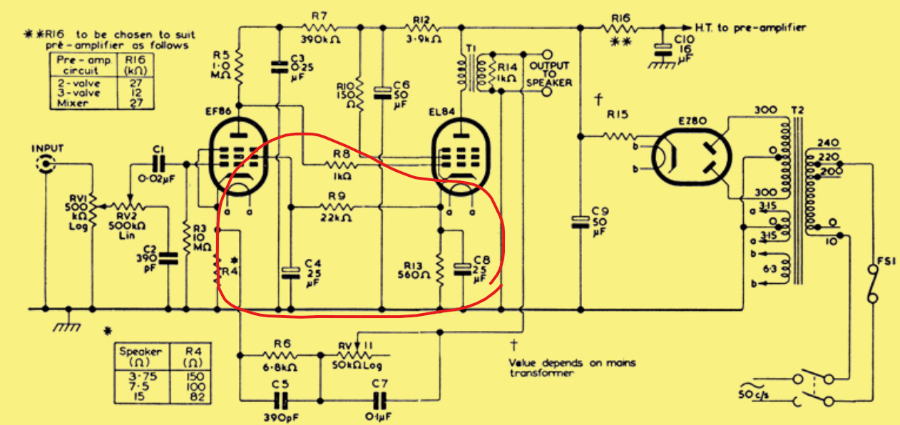

Hi Chris, is this the approach being used in the Mullard 3-3, except feedback being applied to G2 of the driver instead of the cathode?The other possibility is to incorporate some current sensing positive feedback from the output stage's cathode resistor (add a small one if needed) fed back to the driving stage's cathode. A small amount here will lower the impedance at the dreaded output valve / OPT junction, increase open loop gain for more negative feedback to use, and can still be stable.
R9 in the above case provides negative feedback at DC, and includes grid leak bias and starved conditions in the driver. IMO these are things that would have made sense for a cost-constrained design in the 1950s, before we all got so rich. Today, it's just a hill nobody need die on.
What I'd hoped to describe was, instead, some small positive current sensing feedback, cathode to cathode, to be massaged into some voltage sensing negative feedback, output anode to driver cathode. The driver cathode becomes our summing junction, signal plus positive current sensing feedback plus negative voltage sensing feedback. It's just two resistors plus the cathode resistor, but they need to be juggled. Do-able.

Hi Chris, apart from the grid bias and low anode voltage of the driver, isn't the connection to the driver G2 faciltating that current sensing of the output tube cathode AND applying some negative feedback as a result? It looked like another way to skin the cat?
Yes, for DC coupling some (DC, bypassed) negative feedback is a good stabilizing influence. What I've tried unsuccessfully to suggest is a combination of positive current sensing feedback and negative voltage sensing feedback, for signal. I'd assumed RC coupling.
The intent is to make the circuit impedance as high as possible at the driver's anode and as low as possible at the output stage's anode.

OldHector,
I believe that:
C8, 25uF, shunts all of the cathode signal current to ground.
And C4, 25uF, shunts all of the signal voltage to ground.
So, R9 only feeds back DC from from output cathode to driver screen.
You would have to remove C4 and C8 in order to get any signal feedback action from the output tube cathode to the driver tube screen.

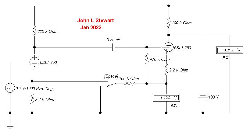

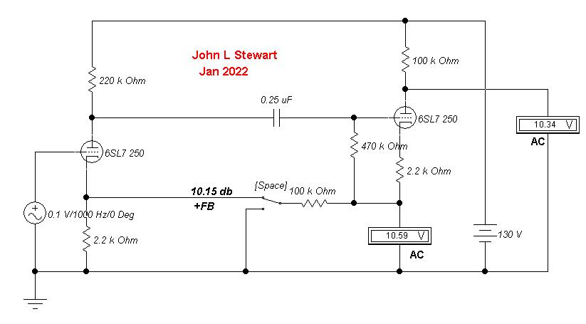

Back when the Earth had barely cooled (~1955) I tried combining PFB & NFB. The complete amp was PP 25L6s running into a Hammond 125D OPT. The B+ was 170 volts. When finished it managed a majestic 6 Watts.
It was meant for a friend who thought he could pick a guitar. But when the amp was tried there was not enough gain. So the cathode to cathode fix shewn solved the problem.
How cool is that?
How cool is that?
