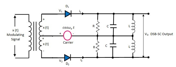

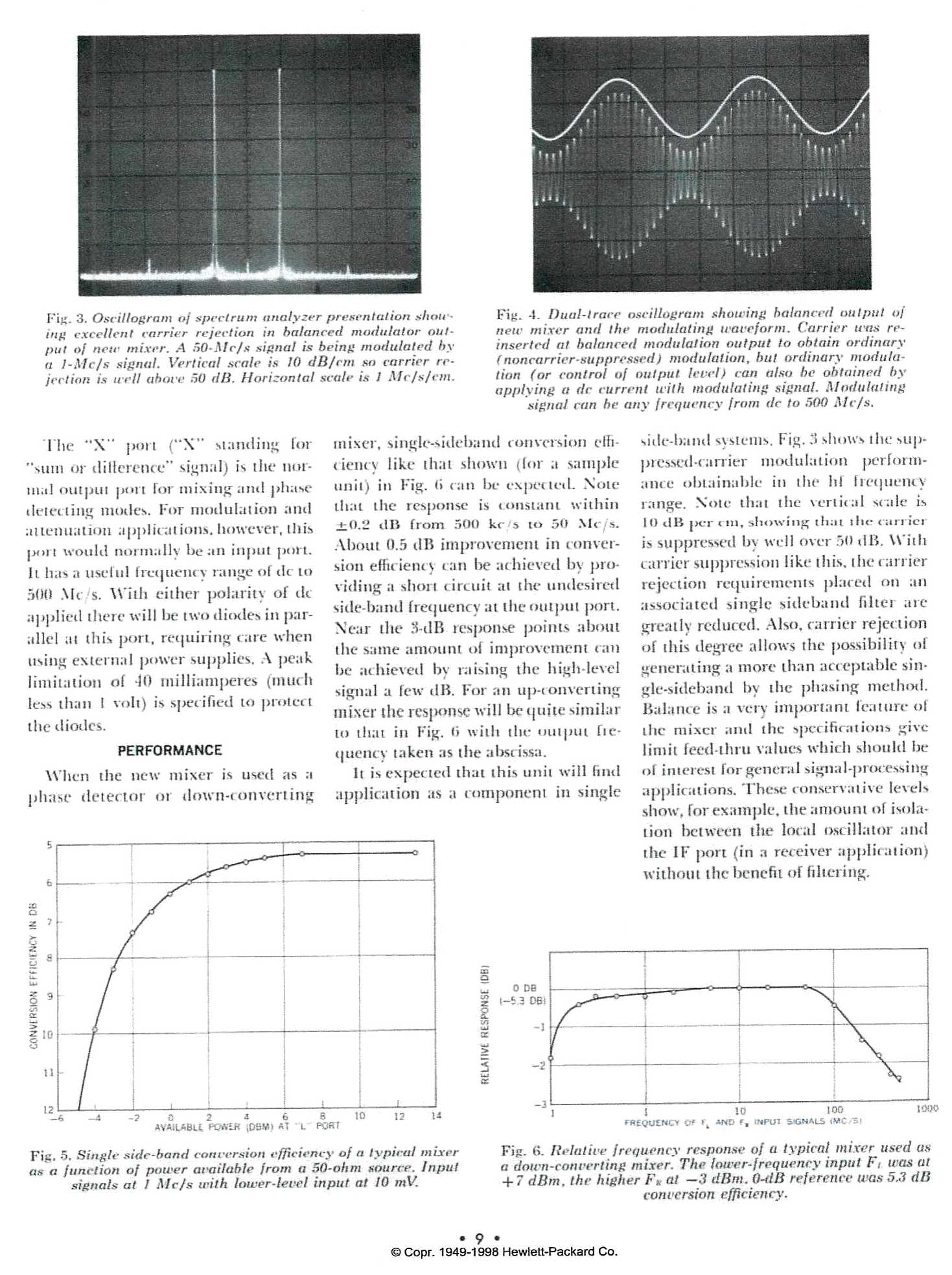

In the late 70s we were selling TI RED LEDs by the Million at prices like 6 cents US each. Back in the HP SS lab an over curious engineer got the idea, why not try LEDS in Ring Modulators & Balanced Modulators. We were selling thousands of small Schottky diodes into applications of this kind. The unofficial report that leaked out of the lab claimed the LEDs tried worked reasonably well.
A simple Modulator of two diodes configured the same as a common CT rectifier can convert audio onto a carrier were none of the carrier signal is left. It is called Balanced, Suppressed Carrier, the remaining sidebands contain all the audio information. There are others based on a ring of four diodes, such as used in the HP 10514A.
The signal produced is the same as that which carries the difference (L-R) information required for analogue FM stereo broadcast. The suppressed carrier is on the FM signal just above the main signal which is the L+R information. All accomplished by the non-linearity of a group of diodes.
With all that going on, does a LED Diode make sense in the signal path of your amplifier? Looks like it will generate some distortion & intermods.
