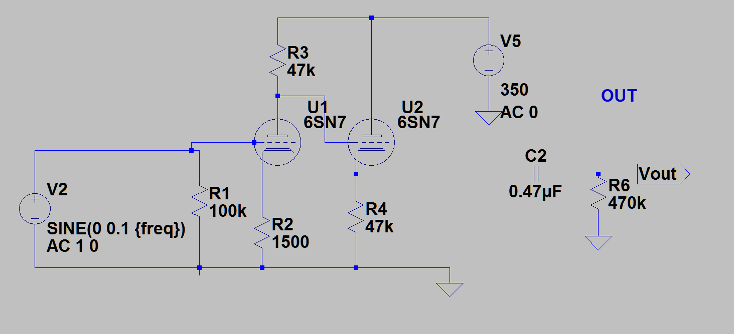

The mu follower is basically a common cathode amplifier
It is definitely not. It is a compound with new and fundamentally different properties and behavior.
increased the dynamic load resistance perceived by the lower device, which as you are no doubt aware will greatly increase linearity and gain.
On the contrary, distortion will greatly increase, but it is not simply a matter of increased impedance, there is much more to it.
I'm not even a huge user of the mu follower, but it's a great single ended (yes, this is not a blanced, or push-pull type of stage!) circuit
Did Morgan Jones say so? But no, the signal is balanced (not referred) to ground.
There is no "balanced action, and the harmonic content is very similar to a common cathode that is loaded with an equivalently selected load to the reflected resistance shown by the cathode follower and load resistor.
The harmonic content is very dissimilar to a common cathode, only odd harmonics being produced as one of many negative consequences of the balanced state.
Morgan Jones' book has obviously not helped you towards a better understanding of the present topic, which proves to be too elusive to treat for that genre of authors.

If you believe that the circuit is not single ended I would love to see your analysis on how/why. I'm genuinely interested in how this differs, because it does not appear to function that way. The difference in harmonic content is a feature of the topology, but is not due to balanced operation. Got any links or recommendations on reading material for me to check out? I'd love to admit I'm wrong if I find some research that proves to explain it differently.
Also I find it strange that you proclaim that many single ended amplifiers are in fact "balanced" in operation... Have any examples? I can't think of any reasonably popular/common SE designs that are balanced throughout other than occasional one-off projects from DIY builders.
Perhaps we aren't on the same page as to what "balanced" means?

The mu-follower is basically a type of SRPP, so it is push pull under certain conditions. This happens when the load impedance is less than the mu of the upper triode times the resistance that spans the anode (lower) to cathode (upper). It's sort of an academic argument though since the PP current is usually puny compared with the quiescent current in most designs.If you believe that the circuit is not single ended I would love to see your analysis on how/why.
It sounded quite good though just thinking that will it give higher SNR than the CF?
Maybe a couple grid stoppers, but otherwise it's simple and should work great. Lots of room for modifying later on.
It is said that there has to be capacitor between the first and the second stage.
Just hook it up, as is. It will work as shewn.It is said that there has to be capacitor between the first and the second stage.
The difference in harmonic content is a feature of the topology, but is not due to balanced operation. If you believe that the circuit is not single ended I would love to see your analysis on how/why. Got any links or recommendations on reading material for me to check out?
