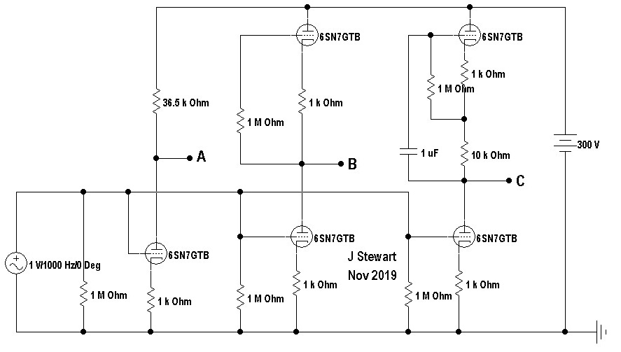

Some Mu Follower Distortion Measurement Results
I did this work in 1999 as part of a line follower cct investigation. If we think of it, the top tube in a mu follower forms the load for the bottom tube. What effect does the top tube have on the bottom tubes performance sofar as D% is concerned?
Theory & practice sez the load Rl should be at least 2X rp & preferably 3x or more to reduce distortion. When the top tube in these example is passive, load is only One times rp when both triodes are similarly biased.
So there are three kinds of loads in each series, an ordinary 36.5K load (A), a passive triode biased same as the bottom tube (B) & an active tube on the top (C). Conditions for each test are kept the same, a 300V PS & D% is taken at 10VAC out. The tests were done one after the other, not three triodes all in the cct together as in the schematic. Does all that make sense?
One series tests a 6SN7, the other a 6BL7. The 6BL7 is only marginally better than the 6SN7 in these tests. On the other hand, the 6BL7 can dissipate more watts total, 12 vs 7.5. So for driving low impedance loads where more current is required should do better than the 6SN7.

An interesting question but leads to another. First of all, the output is not 10V peak, it is 10V RMS, so 14V peak. For Class A triodes a rule of thumb is the D% is proportional to the signal level, so at One volt the D% would be 20 db less.I guess you dont need 10V peak output its way too much if the amplifier has got gain of 26db or above. So what is the THD in case of 1V peak?
For the 6SN7 Mu follower vers at 10 V RMS the result is 0.2% of 2nd & much less 3rd. So at One volt would be 0.02%.
The question becomes, 'Can You Hear 0.02% Distortion'. Probably not.
After passing thru your loudspeaker the D% will be orders of magnitude larger, will the Mu Follwer result be audible? To those with bats ears possibly, several who seem to inhabit DIY.
When designing a system all the parts need attention, some much more than others. The loudspeaker system & the listening space are by far the most important. A line stage is a trivial problem. Just needs some common sense applied.

How did you measure the gain? the 6SN7 has a Mu of 20, so gain in the cct as shewn would be ~15.
I did not use DC on the Mu Follower heater cct posted here yesterday but never had hum problems. That would have appeared in the distortion measurement. I used both an FFT & an HP334 THD Analyzer. The gain of a mu follower approaches mu of the lower tube, so almost 20.
