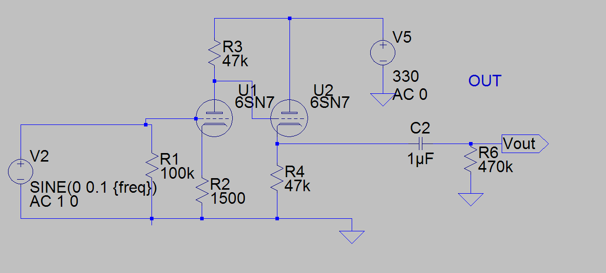

6SN7 Mu follower or cathode follower?
Any suggestions on how I can get rid of the hum

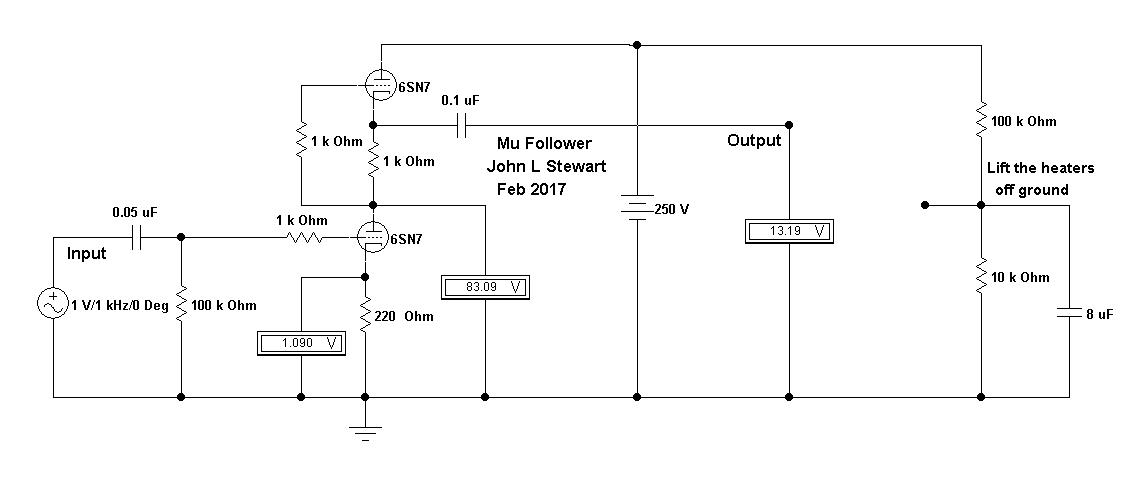

I have tried the following way with CF as well but the same hum residue is there. Which is 100Hz.
I have used the following elevated the heater rails to 60VDC with 220k resistor and 50k resistor and using 100uf cap decoupled to the elevated heater point.
Tried DC heater with 10000uF the hum reduced signficantly but its there.
applied artificial center tap for heater with two x 220ohm resistors and connected that to power ground and also tried with signal ground. Nothing the hum is still there.
Tried chassis wire to B+ gnd and tried both the ways with 10ohm resistor || with 100nF with 35Amp diode bridge.
The hum is still there

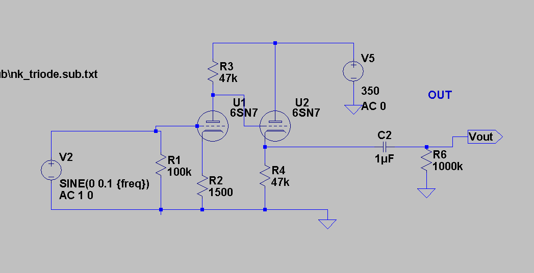

working on my second build. What if we change the cathode bypass capacitor in Mu follower to 1000uF unable to control the ground loops no matter what. Tried Toroidal transformer and also R core where R core is slightly better but when my hand goes near to the tube it starts humming even more.
OK if you think its getting in on the HT, split R3 say 47K to plate and 10K to supply. Then add say 22uF 400V to ground on junction. If its more of a buzz this can be the heater supply coupling into the first grid or cathode. Making sure your heater is balanced, keeping it away from the grid, bypass cathode resistor (will change gain) or DC heater helps. Keep any rectifier return currents out of signal ground.

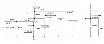

Im attaching the schematic of the DarkVoice preamp
Please advice me where are these two 220uF caps are added.
Ill try them and update in here.
