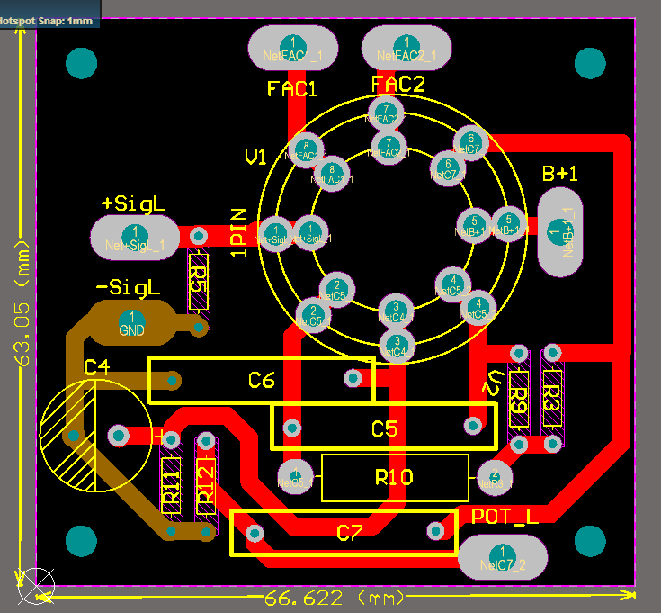

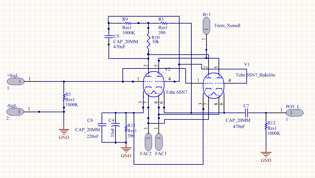

Im using the following. The B+ gnd is connected to the signal ground which is not mentioned in the pcb.

Im using single bridge 5010 followed by CLC 220uF/450V , 2H , 220uF/450V 470k shunt at the output.
Two AC terminals for the heater supply is joined via two resistors each 100ohm and the joint of the two resistors connected to the power ground.
Try DC filament. The problem with many 6SN7 tubes and layout is use of pin 1 as input. The structure of the tube and board layout are critical to eliminate hum.

True but is there any suggestion that you can give in the above layout? Its a single layer PCB as I saw no use of going to 2 layer as the wiring is relatively minimal.
schematic attached
You're running two 6SN7 in parallel, then.
The PCB looks like it's meant for running wires from each of the pads for the tube pins to externally mounted tube sockets. (Correct me if I'm wrong about that.) Those flying leads could somehow be picking up hum, especially if the power transformer is located near the audio circuits.

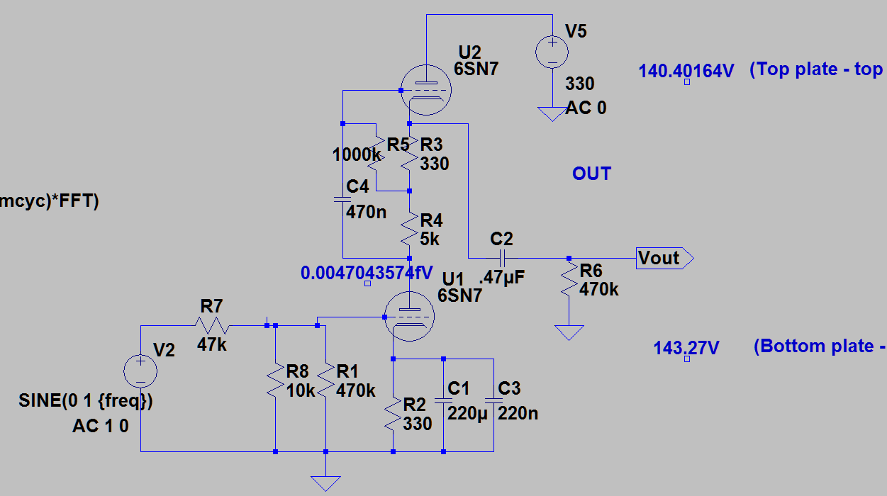

See attached schematic. I think it's correct...

LTspice seems to think that into typical solid-state amplifier input loads of 10k or so, distortion will be increased over the same circuit without the bootstrapping—I guess because positive feedback increases the output impedance of the cathode follower(?).
Perhaps, but also because the boostrapping imposes a load on the follower. 15k looks quite small for an anode and bootstrap resistor. If boostrapping does not reduce distortion then you are doing it wrong. The 6SN7 is not a particularly good CF valve, because it has low transconductance.
The mu stage exhibits high distortion. I am offering no explanation, please take it or leave it.
You are offering no explanation to a nonsense?
Thank you.
Mu-follower is a common cathode stage loaded on a huge dynamic resistance. Draw a horizontal load line on anode curves and see for yourself what distortions you get compared to load on a resistor.
Which version of the mu stage are you referring to? Schematic please.How was the distortion measured?
