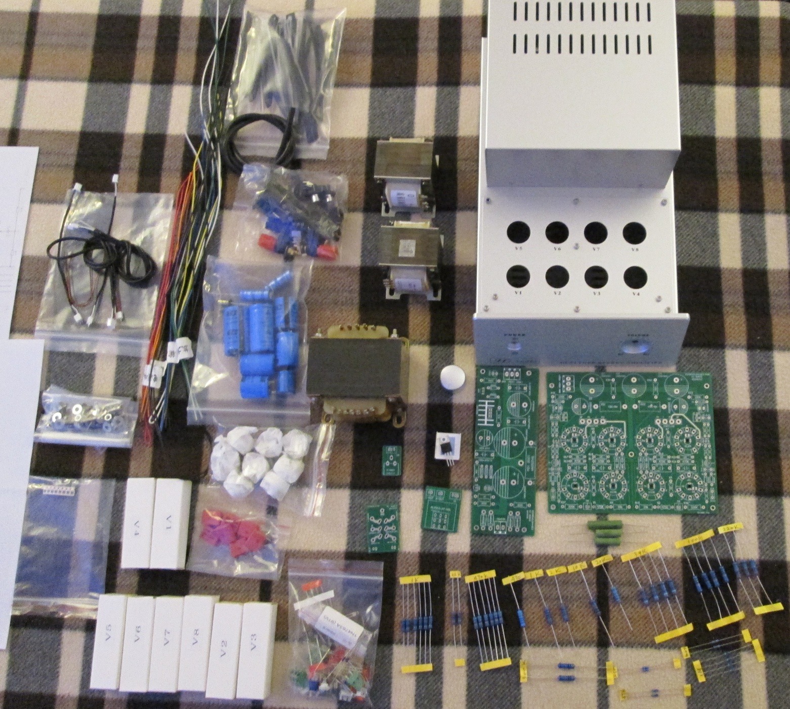

6P14/EL84 amplifier kit building questions - before I build - maybe during if I do

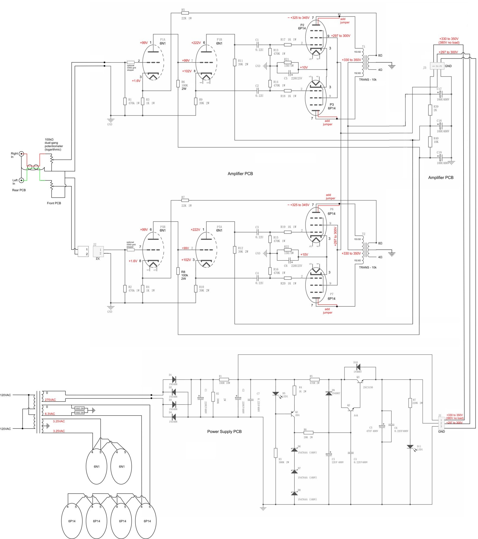

I watched XrayTonyB's video from the link in the first post. He did 3 videos on this amp.
He discusses all of the components and the schematics. And mentions that the parts are much higher quality than he expected.
He thought he was going to have to make modifications and component upgrades to get acceptable performance. That turned out not to be the case.
The only thing he did not like was the volume control circuitry. The 50k ohm volume pot was in parallel with the gain stages 470k grid leak resistor. This made the grid leak resistance effectively 45k ohm at full volume and downward from their.
He built it per spec and the performance was quite surprising for an under $400 amp. He got 14 watts per channel at clipping. And decided that except for the volume control issue their was nothing else he wanted to changae. And the Chinese version tubes were very good.

That's one reason why I decided to go ahead and build one. I paid about $350 and then spent about $50 on parts and supplies, so the total is about $400. Yes, the components do seem to be of decent quality, except one very old Philips power supply cap that I spent about $3 to replace just to be safe. I also replaced all of the wiring since I had enough on hand in my giant box of spare wire. The other issue is the possibility of broken or intermittent connections at the transformers, which happened on both my power transformer and left output transformer. As I was putting the repaired output transformer back in place last night, I think I discovered how I caused the problem. When turning the amplifier over with the transformers in place but without the protective cover, it is very easy to bump the transformer tabs on the table. Oops. Don't do that.

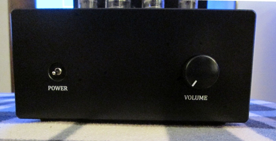

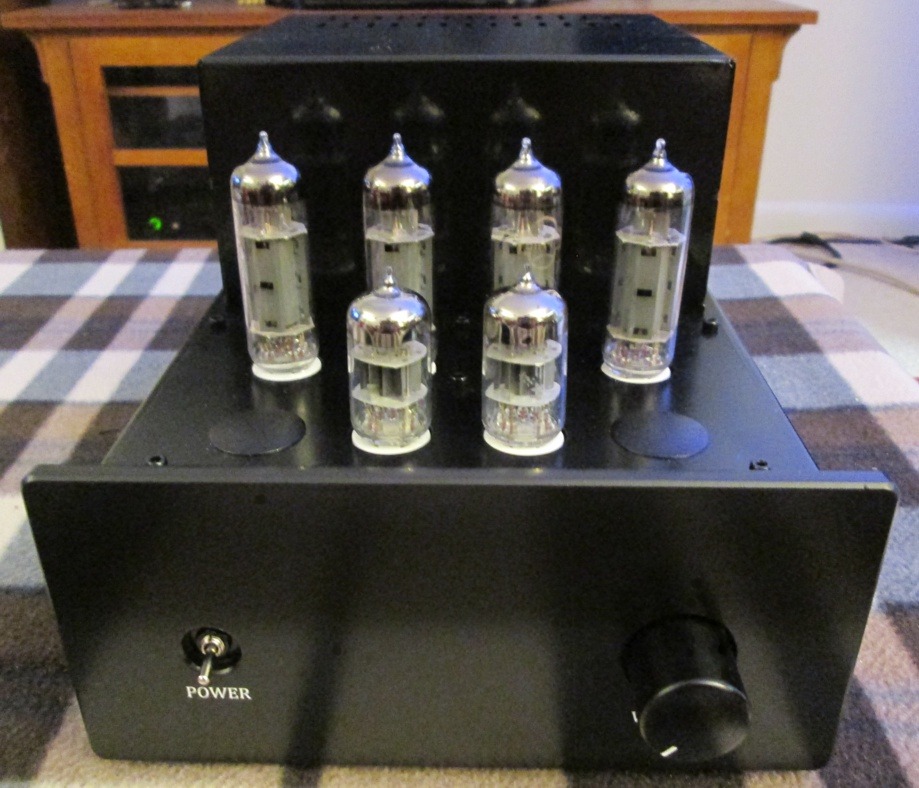

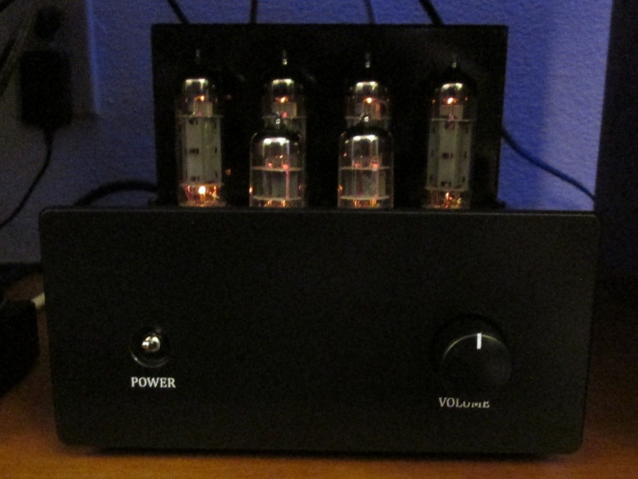

I finally got the amplifier back together after repainting the faceplate three times to get a professional result, with wet sanding and multiple clear coats over the decals to get a perfectly smooth finish and no visible edges from the decals. The whole amplifier is satin black, except the front of the transformer cover behind the tubes, which is high gloss black. I went for a minimalist approach on the faceplate, with no words like "Hi-Fi Tube Amplifier" or a logo or name or anything like that. Just white "Power" and "Volume" decals and a white indicator on the volume knob. There already was a notch there fortunately. The horribly smelly paint is still drying, but I got it in place with no scratches or fingerprints. 🙂
All voltages tested within spec this time, as did the DC resistance of the output transformers after repair and reinstallation. It plays music on both channels. That's as far as I have gotten. If it lasts a week this time without blowing up again, I'll then try some critical listening. Fingers crossed. :xfingers: I am hoping that it won't be light in the very deep bass response because that drives me nuts.
The silver made my eyes hurt. Glad that's gone forever! Only the back panel is still silver because it's not visible and I didn't want to do a bunch of decals for the connections back there.

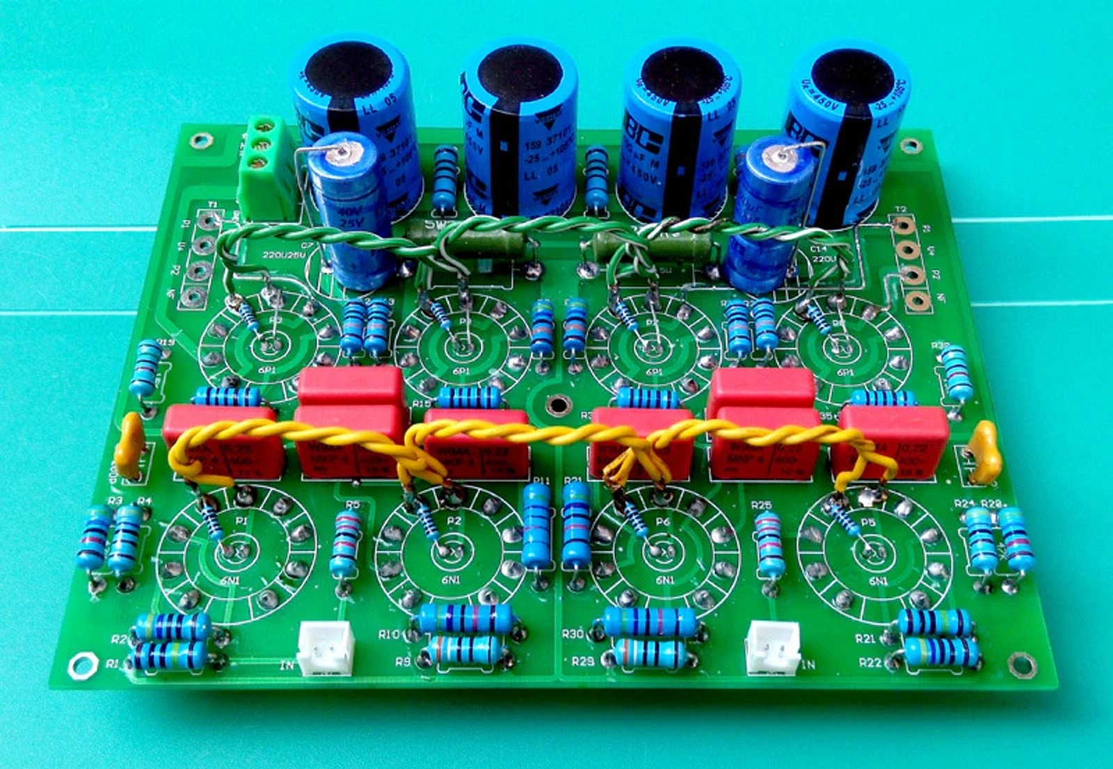

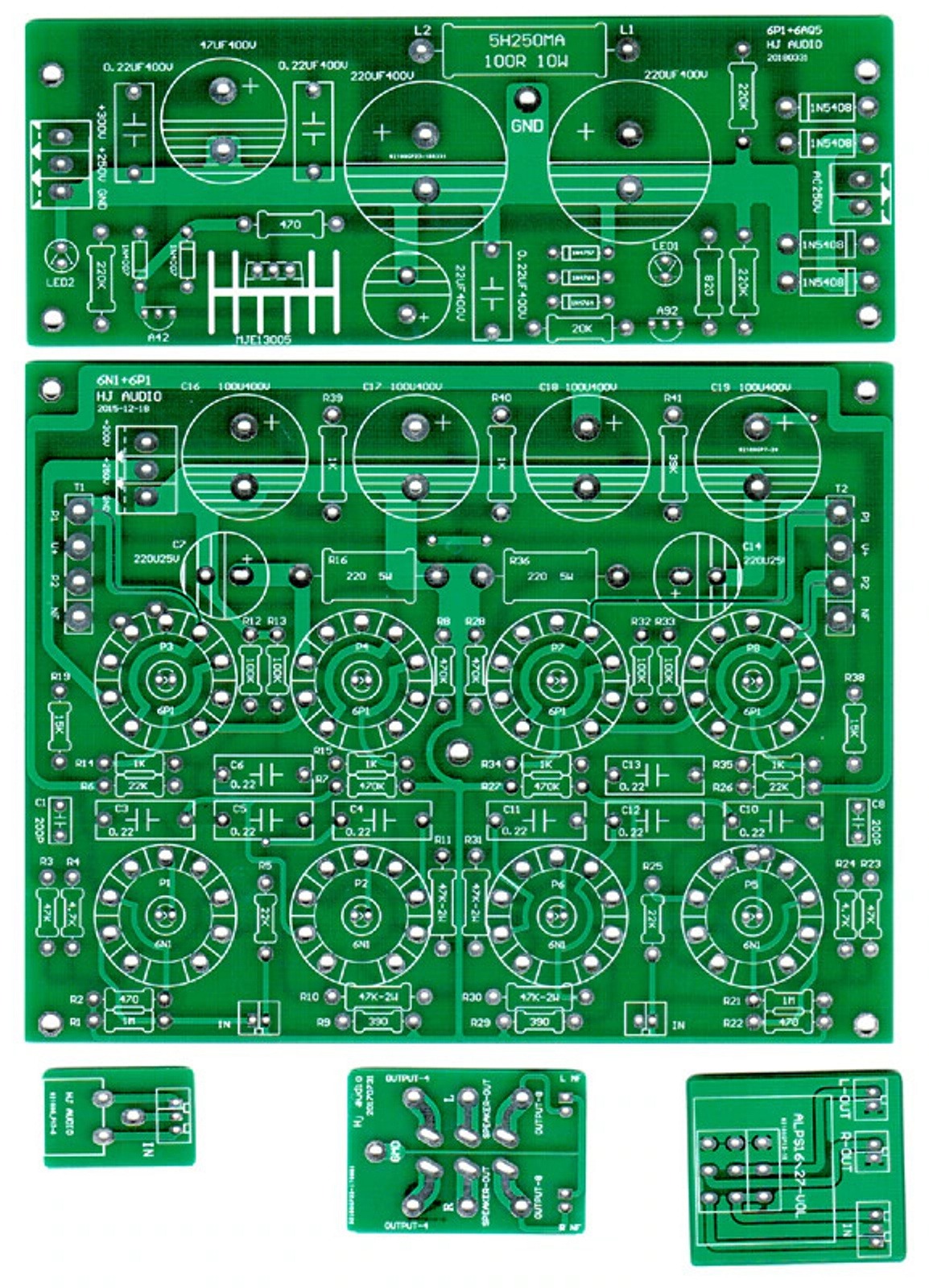

Can anyone speculate as to the circuit used in this different version of the amplifier? It uses four dual-triode 6N1 tubes and four beam tetrode 6P1 tubes. Why would they need four dual triodes in this circuit? Note the "creative" use of the connection in the center of each tube socket where the LEDs go in other versions of the amplifier. This circuit seems significantly more complicated than the version that I built in this thread with only two of the 6N1 tubes and 6P14 pentode output tubes. I am wondering why they went to this extra effort and what advantage, if any, this approach might bring.

I'm not going to post a full, critical listening evaluation for a couple of months, and this thread likely will be dead by then because this was intended to be a Q and A, and it has gotten very long - so long that others don't want to read it, and I don't blame them. 😵
I find the sound very pleasing so far, and improving daily, but the Russian 6P14P tubes are just now breaking in, and I just ordered 6N1P drivers from Ukraine. I don't know how long they will take to get here. I also need to order a pair of the Chinese 6P14 to replace the one that blew so I can properly evaluate those.
Listening so far: I do think that it will become my permanent amplifier, replacing both my hot-rodded, silver-wired, point-to-point-wired Dynaco ST-70 series ii, as well as my 1,500 watt 5-channel Outlaw Audio solid state amplifier. It's good enough for me to say that right now. However, read below though for mods. Note: my hot-rodded Dynaco easily beat out the solid state Forté, Classé, Adcom, and Threshold 50 watt/channel pure class A amplifers that I owned simultaneously back when I built it in the 1990's, and this little amp may end up being almost as good as my hot-rodded Dynaco, just with half of the power. It wasn't easy to beat that Threshold amplifer IMHO. That was a very expensive amp, about $1,800 back then, designed by Nelson Pass IIRC. I sold it and all the others and kept the hot-rodded Dynaco. Now this likely will replace it.
I suspect this has something to do with cloning the four dual-triodes of the Dynaco ST-70 series iii, which was a flop due to the $3,000 price tag attached to it. I find the quad-dual-triode version of this kit quite interesting though.

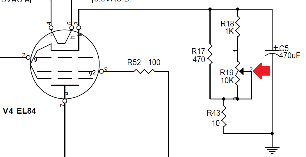

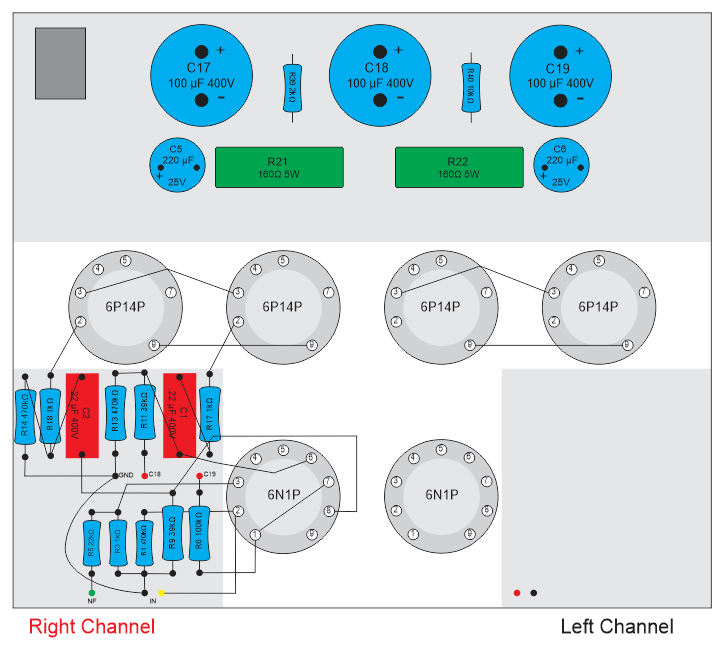

I think it may be possible to build this amplifier in the tight space using something like this: two pieces of fiberglass board (no copper) 2x2" for the input boards and a 3.75x12.5" piece for the power and bias circuitry. It would allow room for circuit modifications and also allow mounting the tube sockets directly to the chassis. This is how I rewired my Dynaco ST-70 series ii to get rid of its circuit board. I just drilled holes in blank fiberglass board and wired point-to-point underneath it. It has worked great for 35 years.
Question: If I use a separate bias resistor and separate cathode bypass cap for each tube, replacing C5 and C6 and R21 and R22 with four caps and four resistors, what would be the correct values? As you can see, this method of construction would allow plenty of room for that.
But you will need one capacitor per tube, of course.
On the other hand, if you have the room and want to tweak the bias on each EL84, you could use the method used on the (discontinued) DIYtube.com Dynaclone. See attached. I use it on most of my EL84 builds. Only the 470 ohm resistor needs to be 1 or 2 watt. Measure the voltage across the 10ohm, 1% resistor and adjust the trim pot for the current you desire.

Not that I would do it, but since the ultra-linear taps are already there, could they be used with minor circuit modifications? I wonder why they chose not to?
