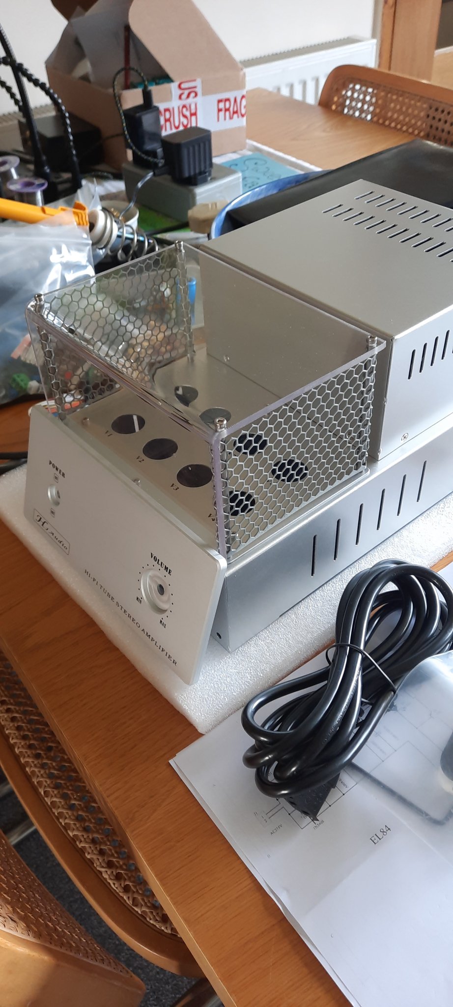

The first thing I have done is make a safety cover as I would not want the grandchildren to injure themselves or worse and also to protect the tubes.
That's a great idea, but I recommend against that design as it will partially trap the heat radiating upward from the tubes. Although it can eventually escape by traveling laterally, you really want an open mesh top, which should be relatively simple to accomplish.

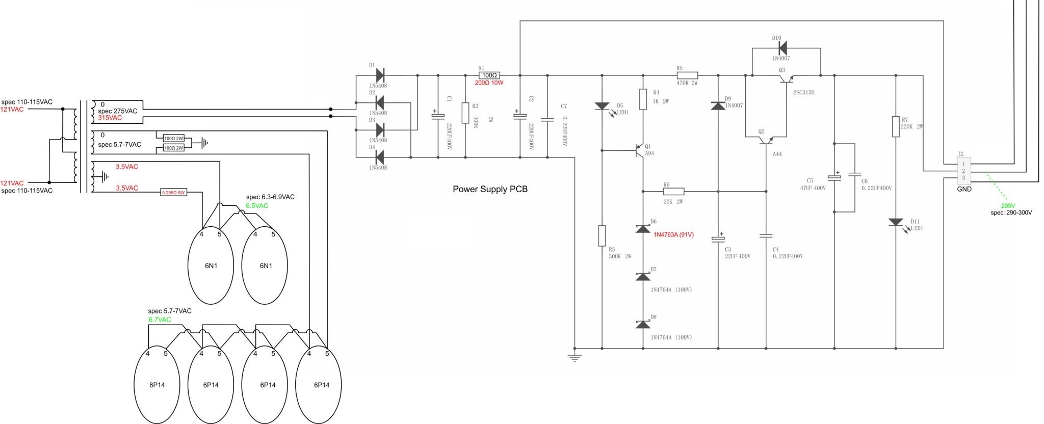

NGO,I am working on the schematic though, which I finally found last night, but due to poor printing, some of the values are not legible. However, when I gutted and rebuilt it, I made a diagram and a list of which resistor was which, and I wrote down all of the values, so I can put clear values on the schematic.
Do you have pic of that power supply schematic with part #'s and values written on it that you can post?
Interested in that regulator section-
Thanks,
Jim
The power supply in the Dynaco ST-70 series ii is different from the one for this amplifier. The power supply for this amplifier and the resistors needed to correct the voltage for USA 120VAC use without a bucking transformer is attached.

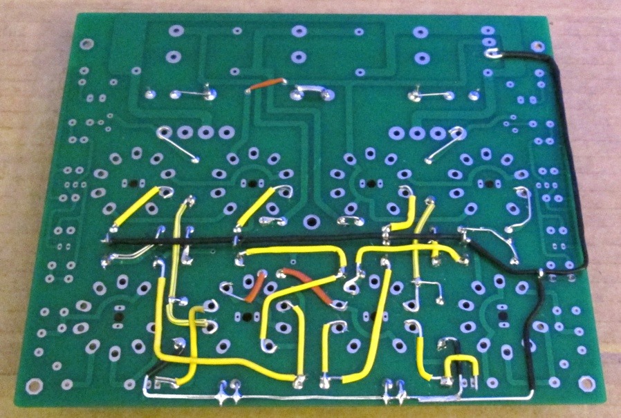

I think I mentioned this before, but I'm not sure that I ever added the picture. I did a pseudo-point-to-point wiring job on the input signal path using silver plated copper wire. I'm not a big fan of PC boards. This approach just requires a little extra care to ensure that all of the solder joints are good. I used standard 2% silver solder. Note that little red jumper at the top of the picture. It's not shown in the directions, but it obviously belongs there if you look at the schematic and the circuit board.
I also took a few minutes to match all of the caps and resistors in pairs to 0.4% or less. It's easy and it doesn't cost anything, so why not? I upgraded the cathode bypass caps to Nichicon Muse, bypassed with small film caps, which was not an expensive upgrade. I had plenty of wire on hand, so every piece of wire in the amplifier got upgraded also, including very heavy wiring to and from the output transformers and very heavy power wiring. One of these days I may upgrade the volume control. It's on my to-do list. However, I have started tinkering with a new Dynaco ST-35 kit that I bought, so it may never happen.
