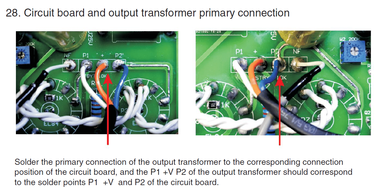

6P14/EL84 amplifier kit building questions - before I build - maybe during if I do

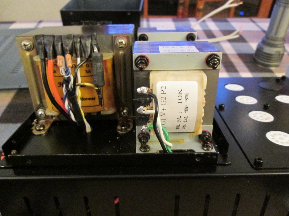

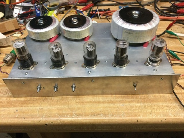

Unsolder and remove the wiring from the P1 terminal. Scrape or sandpaper the end of the internal wire to remove any possible residual enameling that might be causing the open. Resolder, say a Hail Mary, and retest. If still open, you've done all that can be done to save it.
Easy now that it's out. Done as described. Still open. Transformer is officially dead now.
However, there is no point in proceeding if this is just going to happen again for some reason that cannot be identified. Unknown gremilns running around = bottomless money pit and endless frustration.
Back to this point again. I have no idea how or why this happened or what might be done to keep it from simply happening again even if the factory in China does find me a matching output transformer to replace it. No definite (or 95% likely) cause = no real solution, just a gamble I probably am not willing to take.
The B+ end of the winding could also be unconnected.
I already checked that as I was working on it. I checked all three to be sure. It is dead.
What a major disappointment this project turned out to be. I guess where I went wrong was proceeding when I knew there was a left channel problem between pins 7 and 7 on the very first power up test with all tubes in place. I still have no idea what would have caused that. The directions never said to test that, so I never would have known if I hadn't happened to test it in hopes of matching tubes.

Did you put heat shrink on the OPT tags like you did the power transformer? I had some good cheap transformers from Ask Jan First (an option for you since they'd probably fit), but I had to be very careful with the thin winding wires and how they were attached to the tags.

There was a definite difference of ~22 to 26mA across pins 7 on the left channel and 0mA on the right channel, from the very first moment I turned it on. So far, nobody has been able to explain what would cause that or what to do if it happens again. It ran like that for 48 hours before self-destructing. If I put in a new transformer and it measures that way again, I have no idea what to do or what would cause it.
Yes, and I checked to make sure that didn't dislodge the wire as it did with the power transformer. All of the leads from the windings are there, and I actually resoldered them to the tabs on the transformer last night after I removed it, just to make sure, as advised by another member. The transformer is officially dead internally. That half of the winding is open for some reason somewhere inside. Thes transformers have ultralinear taps that are unused. I am wondering if those connections internally have something to do with the issue. More internal complexity = more can go wrong.

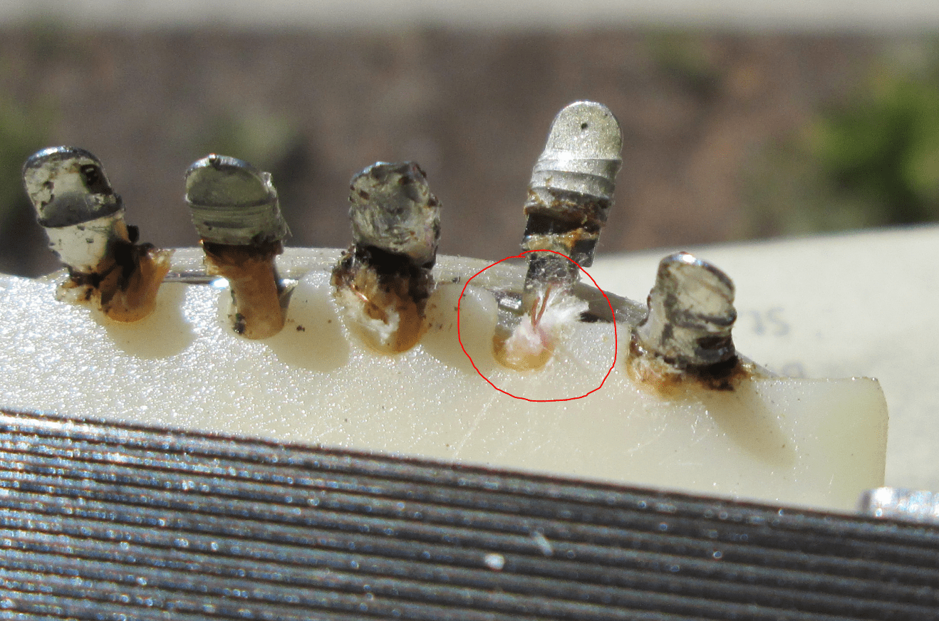

But to your question, what this means is that the OPT primary was open at the time you made this measurement. The amplifier channel operated well enough with only the other output valve conducting, because our audio processing is actually very forgiving. Golden Ears Gurus would be offended to consider this reality, but it's a result of millions of years of optimization, so they need to get over themselves. G2 continued conducting (too much) and melted.
Consider this scenario: winding a transformer like this is done onto a bobbin with two "parallel" cups for the wire. (We know this because the resistances are so equal). The simplest way to connect the wires on each side of the "UltraLinear" tap is at one of the external terminals. This is another possible location of the open, so must be checked. Resistance tests from here to B+ and anode ends was requested above, but not reported. In this scenario, where is the most likely source of a failure? Possibly the winding tension was so high as to break a wire somewhere inside the densely packed winding, but much more likely the fragile wire ends could fail where brought out or where connected.

The simplest way to connect the wires on each side of the "UltraLinear" tap is at one of the external terminals. This is another possible location of the open, so must be checked ... likely the fragile wire ends could fail where brought out or where connected.
You, sir, deserve a trophy. 🏆🏆🏆🏆🏆
I had no idea that each ultralinear tap has not one but two wires from the windings. I assume that one wire of the winding comes out and the other wire goes back in, using the tab to connect the two. I always assumed that it was just a single wire that was there for no purpose if it was not used.
So, what happened? It turns out to have been among the worst possible electrical situations (for me) - an intermittent connection. Very close and careful inspection and further testing this morning revealed that even the slightest touch of the ultralinear tab on the open side of the transformer made intermittent contact. What a mess that made, as we have seen. I teased back the braided insulation as gently as I could using fine sewing needles so as not to disturb the two wires. They were both laying up against the tab but had broken loose from it. It could very well have been making contact one minute and not the next when I was listening to the amplifier. Heating up the transformer over the course of the 48 hours that it ran, and shifting the amplifier around in the cabinet to get at wiring behind it, which I did a few times, could have been enough to make or break that contact. To make matters worse, I discovered this condition on BOTH of the ultralinear taps! It was merely luck that as I have been testing the transformer over the past few weeks that it was always making contact on that tab.

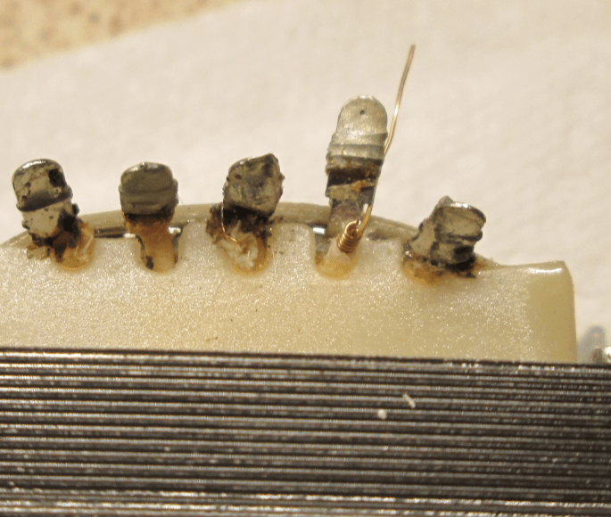

So, I did to this transformer exactly what I did to the high voltage tab on the output transformer when that winding came loose from its tab. I wrapped a strand of fine copper wire around a needle to make a pigtail with 4 turns of wire and a 1/2" lead. I soldered one of these pigtails onto the exposed pair of wires of each ultralinear tap and then wrapped and soldered the tail to the tab. The resulting connection seems to be quite solid. I also didn't like the appearance of the connection at the center, so I put a reinforcement wrap around that one as long as I was at it and soldered that. Better safe than sorry.
The transformer now tests just fine for DC resistance. Live and learn.
Now I'm concerned about the other output transformer. I don't know if I want to go with the old saying if it ain't broke don't fix it, or if it may very well have the same problem with its ultralinear connections and it just hasn't showed itself yet. I'll have to examine it very carefully to see if it warrants removal of the transformer and the same treatment. Of all of the problems I thought I might have, this is one that never even crossed my mind.
I redid both ultralinear taps on the bad transformer with pigtails like this:

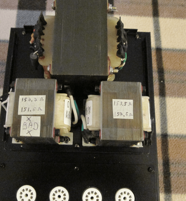

Now I have to examine the other output transformer and determine if it needs attention. I took this opportunity to remove the faceplate from the amplifier to paint it black as I had planned. It will take several days to do the paint and decal work on that before I can consider putting everything back together again. If the factory in China finds a matching output transformer, I already agreed to buy it for $50 delivered, even now that I have repaired this one. I had no idea that this one could be fixed. They have already gone to significant trouble, so if they find one, I will buy it from them. I can just stick it in my parts box with everything else I have accumulated over the years. Who knows when it might come in handy for something.

I examined the other output transformer out of concern for the same issue, and apparently there was a quality control issue. The other one has large globs of glue around each wire where it exits the transformer winding and attaches to its tab, encasing and protecting the connections. The one that I just repaired because of the issues has no glue. I will not fiddle with the one that has all of the protective glue. If it ain't broke, don't fix it.

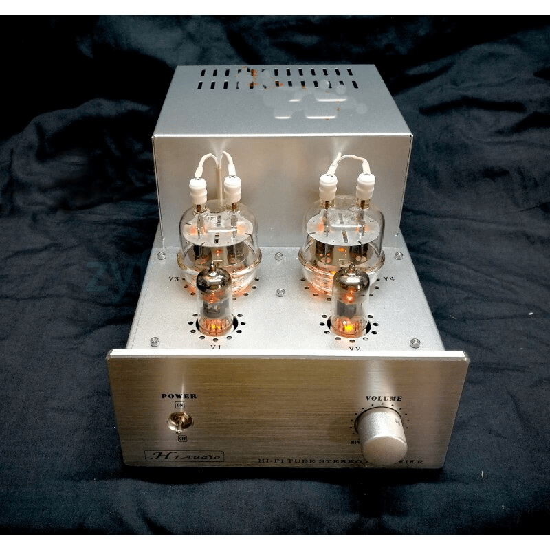

I would love to know what this bizarre looking version of the same amplifier sounds like. I love the funny looking output tubes! Aren't those wires poking out of the top a little dangerous with no protective cage?
https://www.aliexpress.us/item/3256804993363963.html
The performance in audio amplification is highly praised, and its timbre is described as "ecstasy".
I want ecstacy timbre!
Here I sit waiting for the black laquer (very smelly) to dry on the faceplate so I can decal it and put my amplifier back together to test my repair work on the output transformer. Maybe I can get it back together by Friday. I'll have the only all-black version of the amplifier on Earth. Black paint sounds better, right? ; 😉
"Aren't those wires poking out of the top a little dangerous with no protective cage?"
