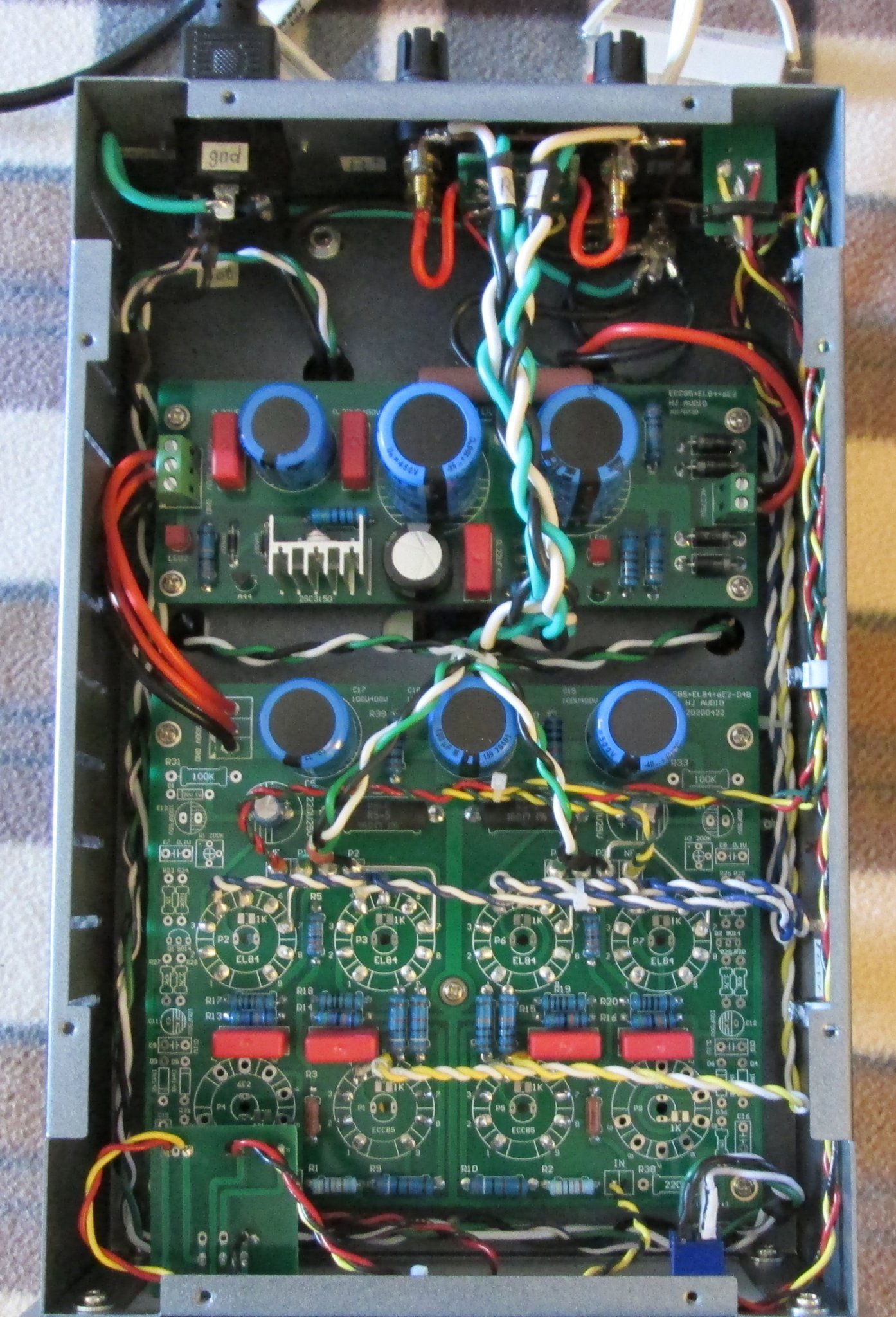

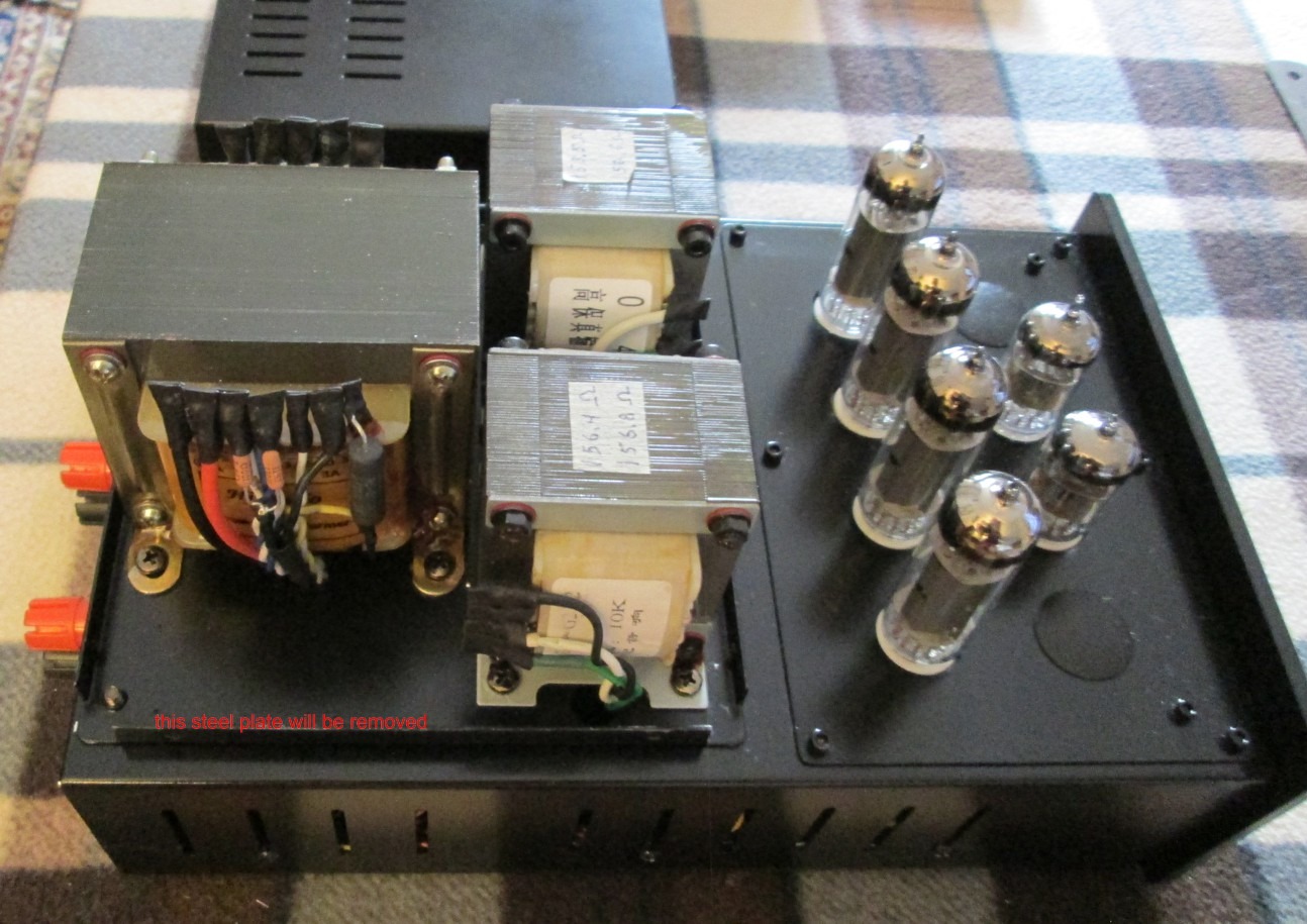

I am consulting with someone who custom winds transformers. I want to get rid of the metal box that covers the transformers this time and get ones that have nice end bells. Stay tuned!

Yes, the output transformers will be the primary target of the upgrade. The included output transformers sound great, but if you look at XrayTonyB's bench tests on YouTube, they distort heavily below 30 Hz when you put more than about 6 watts through them. I suppose this is why the amp is rated 30Hz to 20kHz.
The power transformer also will be replaced/upgraded because, 1) I want one that actually puts out the specified 275V with a 120V input. 2) I want end bells and wire leads so I can get rid of the metal box that covers the Chinese transformers, which have solder tabs and no end bells.

I'm trying to get the transformers made now. I spent all morning doing scale drawings because the new OPTs are bigger than the included ones, necessarily so. It will take 2 weeks for the kit to get here and I suspect a month or two for the custom transformers.

One more note on this little amplifier kit. Unlike the ST-35 that I built, this amplifier gets the "timing" of the music right. I'm not sure how else to describe it. Imagine a band where the players aren't all playing well together and their timing is a little off from each other. So many amplifiers that I have tried over the years, both tube and solid state, seem to have that problem. This little amplifier kit, as inexpensive as it is, does not have the problem. It's great. The "timing" of the music is right.

With the cover off today so I can measure the transformers. I'm glad I did the all-black paint scheme. The silver hurts my eyes!

New here and really tempted to make this my first build. I read through this thread yesterday but still have a couple questions. Full discloser I was nursing a sick kid while making my way through and was slightly distracted, so don't skewer me if I ask a question that was covered in here 🙂
First of all, I have some soldering experience but have never tackled a full kit like this, I've built a couple guitar fuzz pedals. Is this too much for my first build? Or is this a good place to start?
Second, I'd really love to be using EL84s as I have a couple nicer quads that are just sitting around here. Has anyone actually tried them with any luck? How'd they sound compared to the 6P14 variants?
- This also was my first time building a full kit. Previously I had done small projects and upgrades, but never a full kit. Thus, this thread was born.
- I would practice on a small, inexpensive test project to make sure you are comfortable with soldering properly and consistently. There are lots of small, fun projects on AliExpress. Something like this: https://www.aliexpress.us/item/3256805926540684.html
- Use a good soldering iron and good rosin-core electronics solder. My iron is old and desperately in need of replacement. A good iron makes the work much easier. Keep the tip clean.
- I hate lead-free solder. Ordinary 60/40 is fine. I use Kester 2% silver solder, but a little extra care is required.
- The components on the PCBs are soldered onto it outside the amplifier so you can work on it easily, inspect it thoroughly, and clean off all of the soldering flux before mounting it inside the chassis. You do need to make sure that the solder has flowed through the hole and you have a solid solder joint on both sides, especially the tube sockets. I used a scrap of cardboard to ensure that the required gap between the components and the PCBs was proper.
- You must have and be comfortable with using a voltmeter to test your voltages, and you MUST respect the 340 volts inside the chassis! Always keep one hand behind your back is the rule. One nice thing about the power supply is that it has LEDs on it to help indicate that high voltage is present.
- Fitting everything into the chassis during final assembly and routing all of the wires neatly is the most tedious part of the build I think. It's a small chassis with a lot of wires inside. Be patient and pay attention to details.
- Attaching the heater wires to the PCB I would say was the part of the build that tried my patience the most. It requires patience. Don't rush it.

- There is a little wire jumper on the PCB that is not noted in the directions. The board will work without it I think, but I recommend installing that jumper.
- Two 100 Ohm 2 watt resistors are used on the output tube heaters as shown in the instruction manual and they are not included in the kit.
- I opted to replace one very old Philips power supply capacitor that comes in the kit. The others seem fine. It only cost a few dollars. Better safe than sorry.
- I used Nichicon UKA series 220uF cathode bypass capacitors instead of the weird ones that come in the kit. It now appears that 470uF might be a more appropriate value, and I have changed them to Nichicon UKA 470uF in my amplifier. Some people prefer Elna. I checked and Elna Tonerex 470uF are available.
- I really didn't like the hookup wire that came in the kit, and I replaced all of it.
- I lowered the bias a little bit by using 160 ohm resistors instead of the included 150 ohms.
