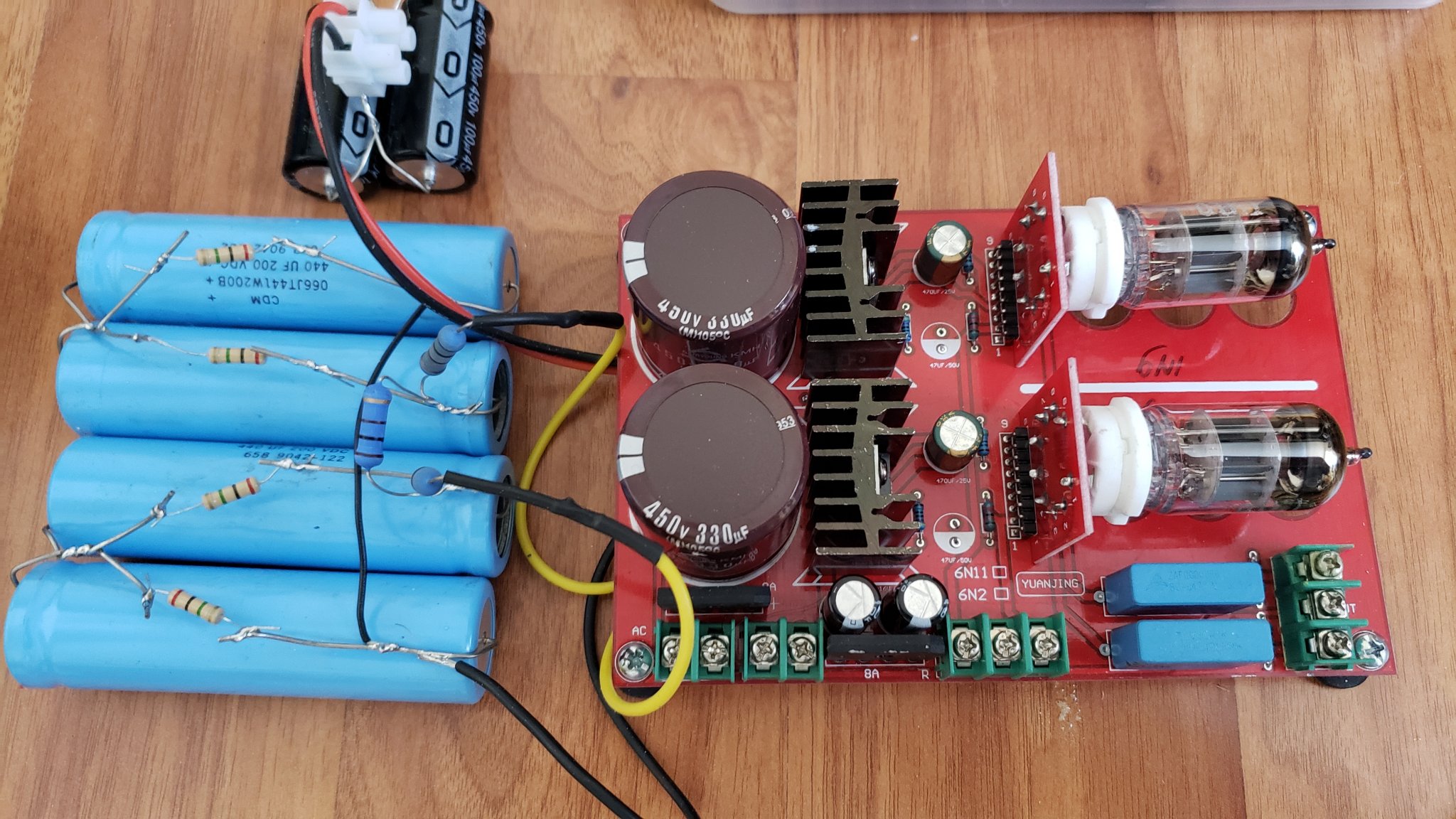

SRPP topology is also my favourite. Here is my construction (phono 3 tubes, line 1 tube):
SRPP preamplifier
I use E88CC or 6N23P, without cathode bypass. Power supply uses CRCRC filtering. I struggled a lot with stray hum shielding. Eventually I used permalloy sheet here and there, shielded signal cables, and ground loop breaker. Shield caps on the tubes were of no use, not necessary either.

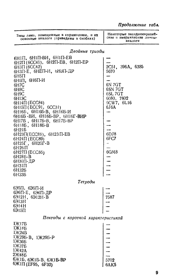

6N1 is not a 6DJ8. Lower gm, higher rp, works at higher voltages. (High impedance) The Russian version is 6N1P. That's a fine tube, but it's definitely not a 6DJ8 equivalent.
6N2 is definitely nothing like a 6DJ8. It's basically a 12AX7 with a 6V heater. The Russian version is 6N2P.
6N11? What the heck is that? Maybe that's the Chinese version of 6922/E88CC.
6N23P is essentially the Russian version of 6DJ8 or ECC88. 6N23P-EV is similar to 6922 or E88CC.
From audiotubes.com:
Wait... 6N1P is electrically equivalent to ECC40??
Wonder if the 6n23P is not in fact a E88CC/6922.
The 6n23P-EV is the low noise version of the 6NP23P. So is a 6NP23-EV not an ECC88 in spite what is marked in that sheet ?
The EV is superior to the non EV, no ?

Saw your pictures. That's some impressive building.
How do you come to 3 tubes for the phono? Do you have a schedule?
My preamp doesn't have a psu as extended as yours but it's completely silent.

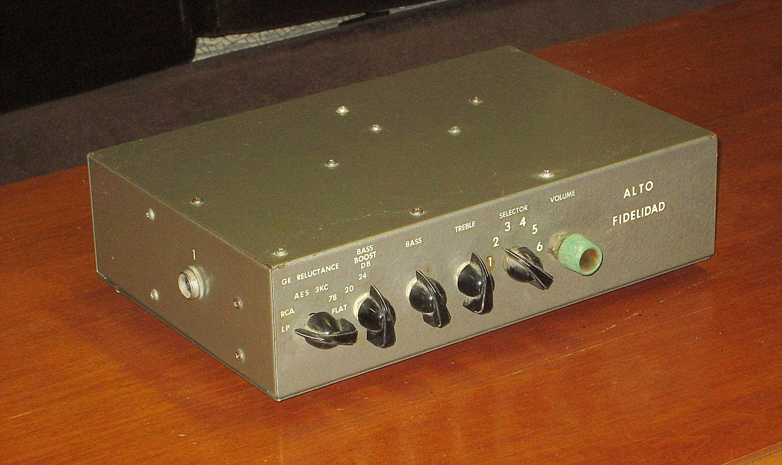

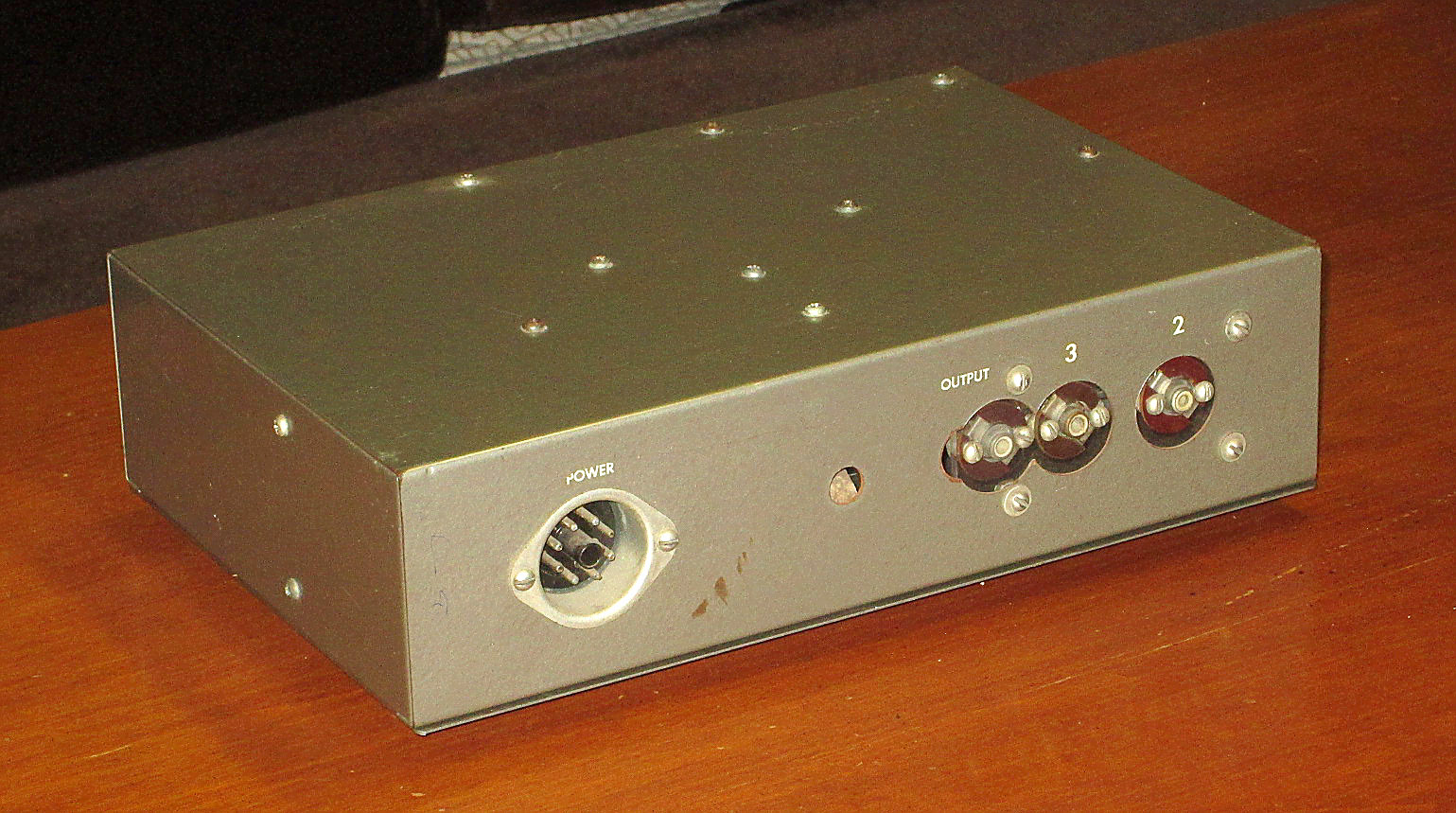

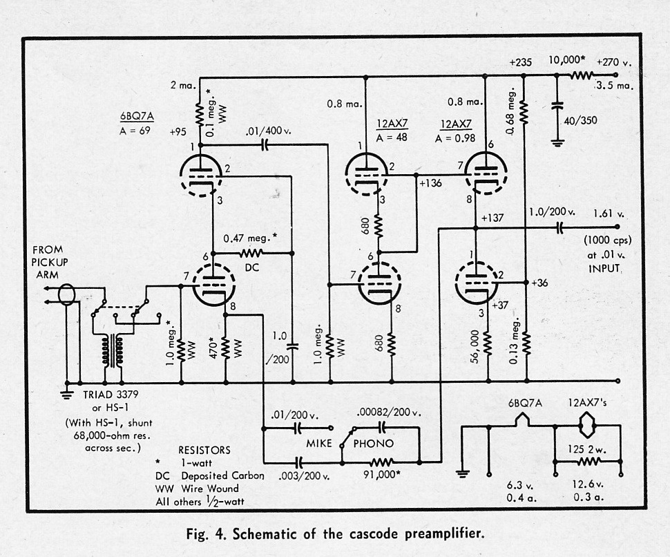

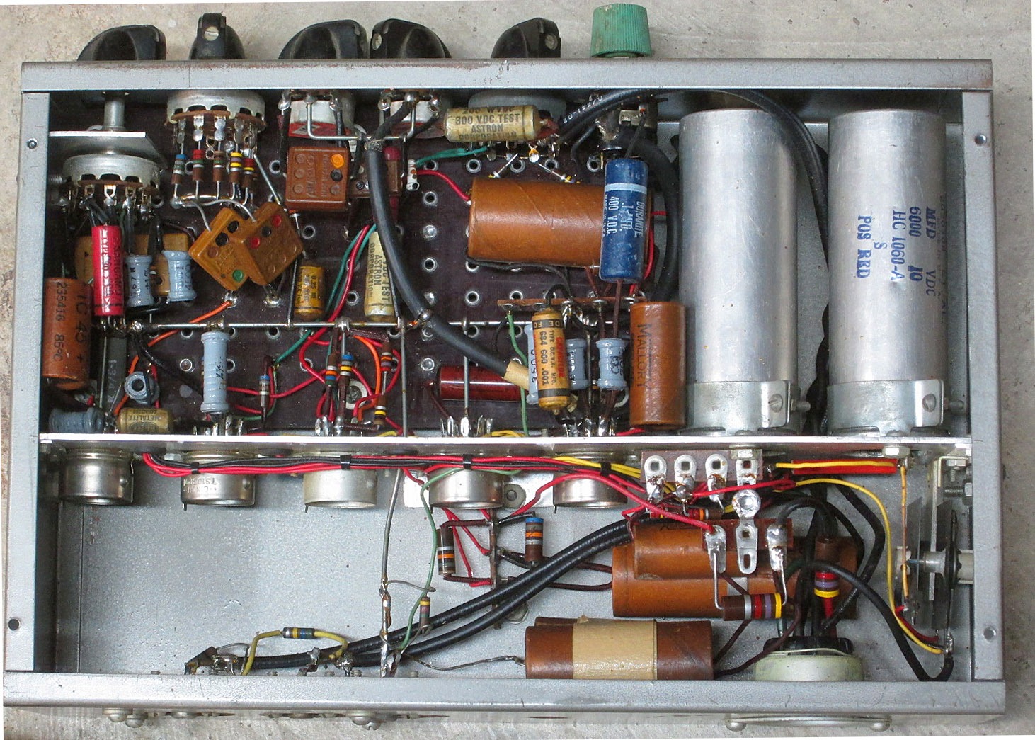

Here is a Cascode Preamp I built circa 1956. Ran it for a few years with a GE VR phono pickup.
Still here but on the shelf
