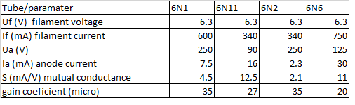

I have tube pre kit which (supposedly) works with any of these. Which is most linear? Most musical? Or otherwise preffered?
I can get some or all, and compare, but even different supliers can result in different sound.
Any recommendation? They do have different heater current demands, so i have to account for this.
I already have one working in box and second is up and running on the floor. I want to replace all my solid state pre, as this pre has more musicality for me. I got no schematics, sorry.

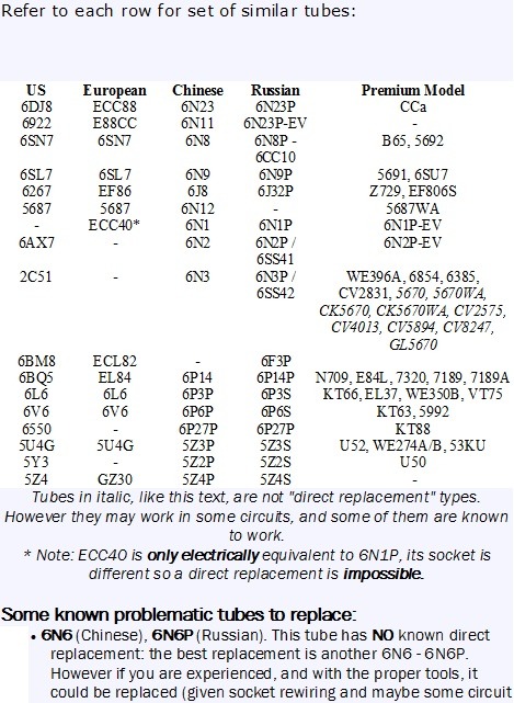

6N1 is not a 6DJ8. Lower gm, higher rp, works at higher voltages. (High impedance) The Russian version is 6N1P. That's a fine tube, but it's definitely not a 6DJ8 equivalent.
6N2 is definitely nothing like a 6DJ8. It's basically a 12AX7 with a 6V heater. The Russian version is 6N2P.
6N11? What the heck is that? Maybe that's the Chinese version of 6922/E88CC.
6N23P is essentially the Russian version of 6DJ8 or ECC88. 6N23P-EV is similar to 6922 or E88CC.
From audiotubes.com:
Wait... 6N1P is electrically equivalent to ECC40??

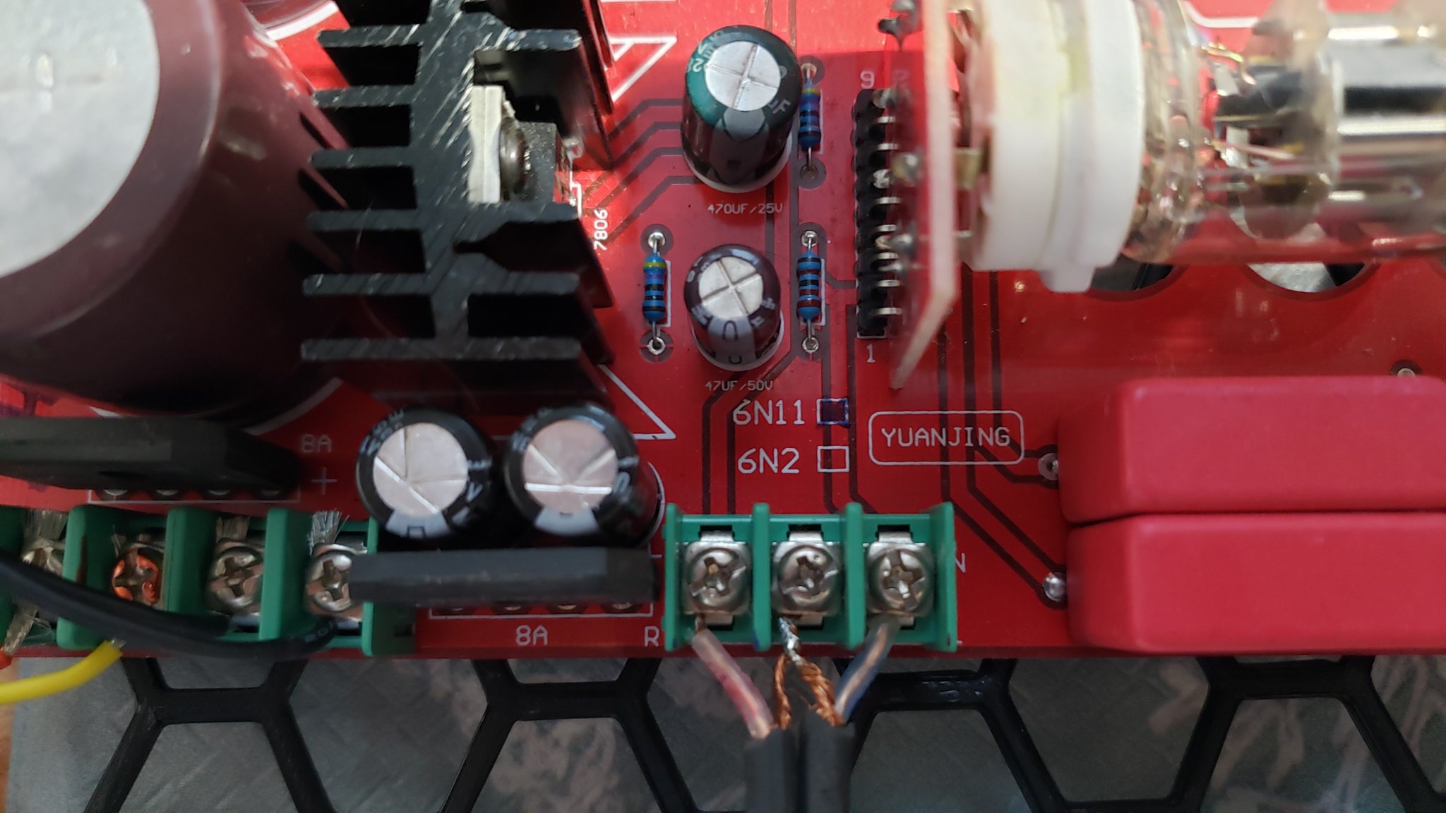

Hi rongon, thanks for plethora of information. That's exactly what i am looking for. Kit comes standard with either 6N11 or 6N2. I do not know what is 6N11.6N1 is not a 6DJ8. Lower gm, higher rp, works at higher voltages. (High impedance) The Russian version is 6N1P. That's a fine tube, but it's definitely not a 6DJ8 equivalent.
from some other thread info from member in Ukraine:
6N11 - I believe this is actually 6N1P, and if I'm right then it may be directly substituted with 6DJ8/6922/ECC88, although they are noticeably different. Or you may try Svetlana 6N1P.
some else comments: if 6N11 = 6N1P as our ukrainskij friend suggests, then it is also very easy to find
I do have plenty of NOS unbranded (military?) 6N1P and new Svetlana 6N1P still in the original package. Should be fun to compare sound/spectrum once I finish the power supply.
These kits do have power supply on board, but the filtration is not sufficient, so there is some hum. This is what I need to remove first in order to do proper measurements.

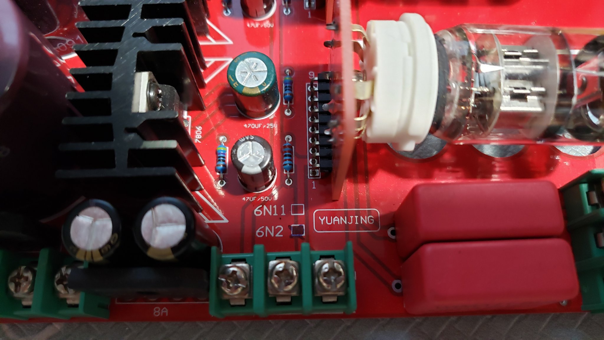

I do have plenty of 6N6P, but I do not want to try them in this kit as they require enormous heater current.
My goal is to have 4-5 functioning tube pre, which would accommodate various tubes. Then compare sound to harmonic spectrum. But I do not want to randomly swap tubes which were never meant to be equivalent. Hence I am gathering the information.

Gain of 6N2 is 100. The rest of the data seems correct.
