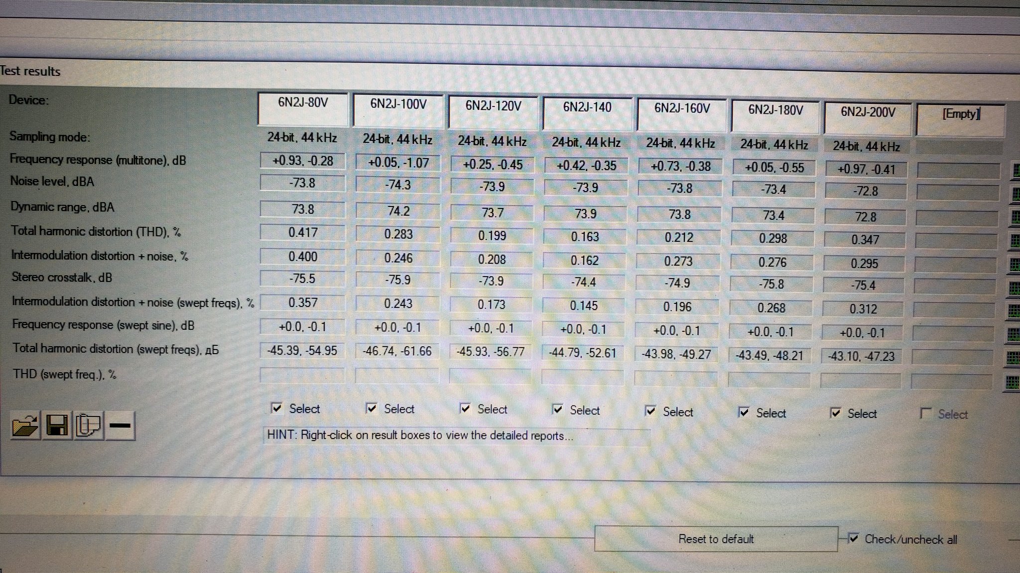

Since I felt bad for poor 6N2, I did test the distortion from 100 volts supply to 200 volts, in 20 volt increments. There is smiley effect, distortion going down, then up. I will post results when I have a chance. I made no mods into the circuit, except used variac for HV part. Heater part was separate and kept as before.
I dunno... They used to quote 10% THD figures on datasheets. 0.1% is great IMHO. a Marantz 2220 has 0.9% THD and people sing their praises, right?
Right...
Its just that all previous tests and comparison were done at ~240 volts, so it was not fair to 6N2, so i wanted to remedy that.
