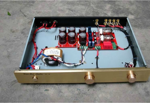

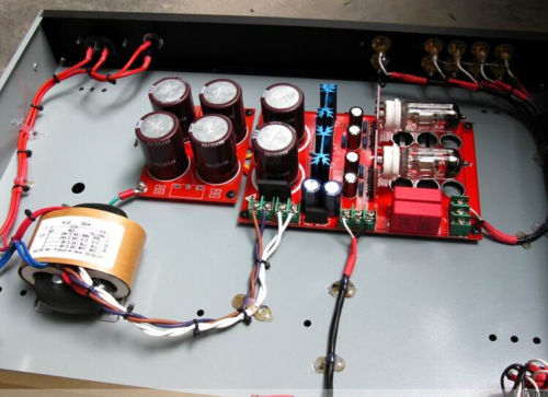

This is what I found on the web, somebody's commercial offering. Four inputs, selector, volume...and lots more filtering 🙂
That thing looks lethal The mains safety earth pin on the mains input connector appears to be unconnected!!!

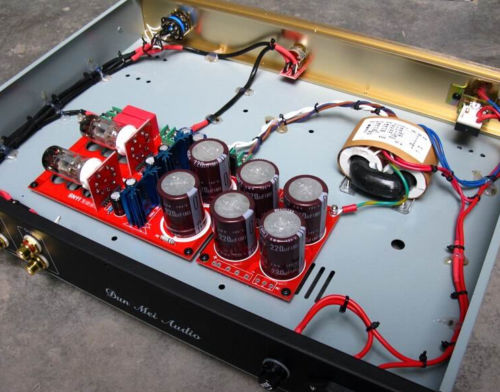

an update...since I still keep working on these, here is what I learned so far
When it comes to four types of tubes I used in this simple SSRP pre, 6N11 are the most linear and transparent, with lowest distortion. I have two pairs only, but that is enough to finish two pre in the final box. Two boxes were finished, one is in foamboard, has AC heater, and has lowest noise. Due to significant HV power upgrade with more CRC filtering. I will get to it later. This pre is in main system with Aleph J right now (tried F3, M2, few F1J...), all sounded great, but there is synergy with Aleph J. Sound is crystal clear, transparent, bells and triangles pure pleasure, yet the main characteristic different form solid state pre I tried is that sound is more musical, "liquid" is the best way to describe it.
Second pre is in blue aluminum box, working with F4, and its the same improvement, as it replaced BA3FA or J2 pre.
I have received 20 russian tubes 6N1P from ukraine, all working great but one. I measured all on vintage tube tester first, and discarded one. It was not showing "bad" but it was low in comparison to others. While measuring them, I selected two pairs and tested them in two remaining kits. While the distortion with 6N11 was ~0.018%, distortion with 6N1P is ~ 0.032%, this at high level, ~10dB below max soundcard signal. Still very clean sound, will finish with these tubes. Btw, compared to 6N1P Svetlana's I already had, exactly the same distortion, I think they are identical.
Here is what I learned so far about the hum. I tried on one kit about 5 different adapters to power the heaters. From 6VAC, to 12VDC, various sizes, normal trafo, switching brick, and so on. Switching supply was messy, so I did not used them. There was no difference between AC or DC adapters, because kits have 6.3 V regulator on the board. So it did not matter if I prefiltered the supply. I tried to lift the heater to ~50 volts DC tied to main HV power supply, but it had absolutely no effect. Biggest effect on overall hum was adding more filter stages to main HV power supply.
So I purchased lots of capacitors from parts express, they have sale or closeout deal on 440uF/200V caps, which I used in series with 1Mohm tied together. And they have 100uF/450V, both quiet cheap. Original filter after the rectifier is 200uF-150ohm-200uF filter. So only CRC. I removed the 150ohm on board and added external RCRCR and brought it back. This reduced hum to ~90dB below zero, the 60Hz peak is actually very low now, its 120Hz which is dominant, but above, the rest looks very clean. Above 1kHz, almost no noise, reaching -110dB. So adding more filtration steps was the way to go.
