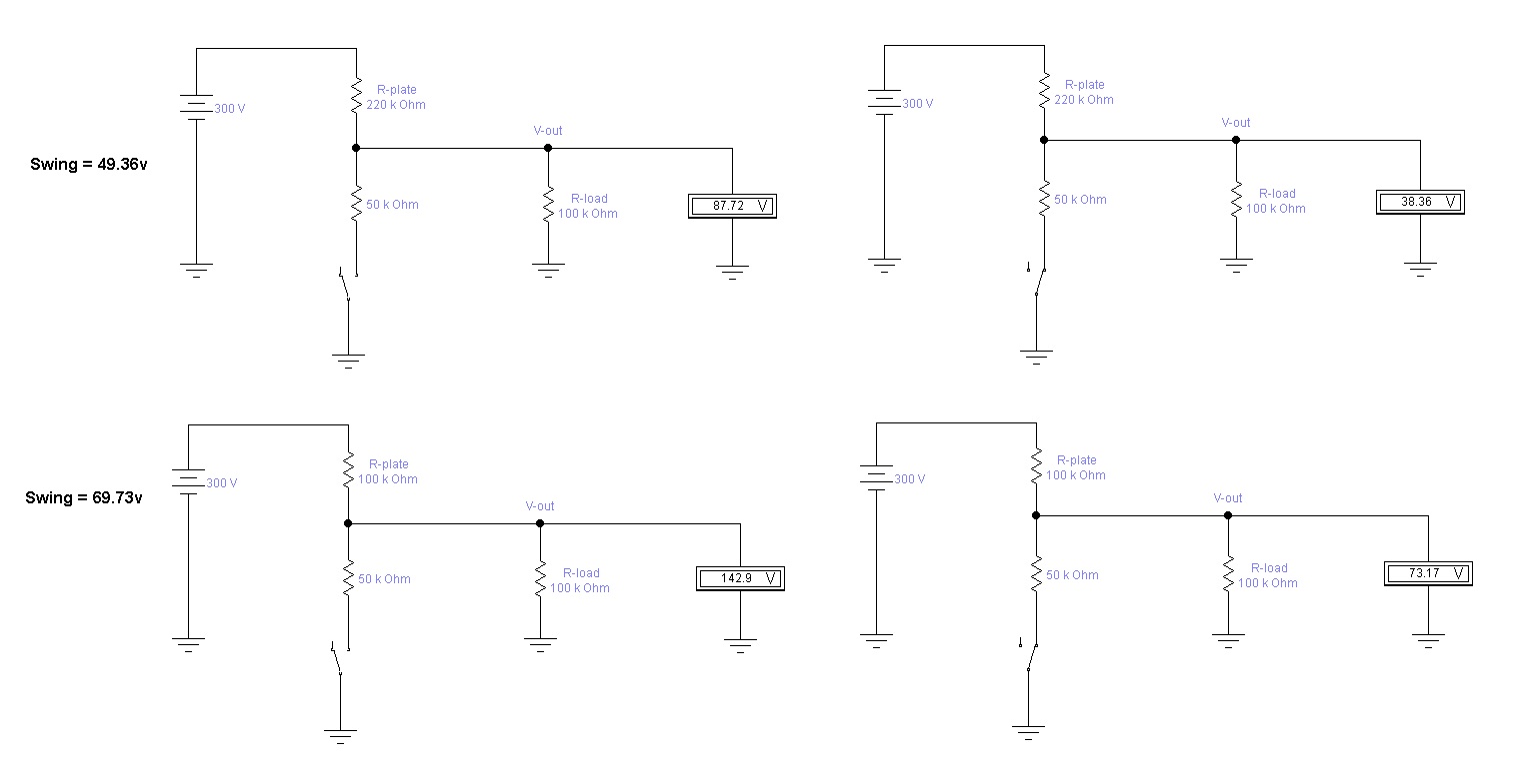

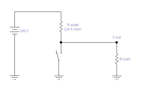

Here's what I'm seeing. In this example a switch is used to represent a valve that can be fully opened and fully closed. The swing between the 2 states is 0 to Vout. A smaller R-plate (in this example) would give a larger V-out.
Vout= B+*Rplate/(Rplate+Rload) ?

Your circuit is too simple, which is why it doesn't reflect reality. You need to add a resistor in series with the switch to represent the valve's internal anode resistance. Then you should find that although the voltage can be pulled up to 300V (more or less) when the switch is open, it cannot be pulled all the way down to zero when the switch is closed. Increasing the load resistor allows the output voltage to be pulled down further (closer to zero), which basically means more voltage gain.Here's what I'm seeing. In this example a switch is used to represent a valve that can be fully opened and fully closed. The swing between the 2 states is 0 to Vout. A smaller R-plate (in this example) would give a larger V-out.
Correct. That's why I said "a valve that can be fully opened and fully closed". The effect of r-plate (in the drawing) is still the same. A larger value will result in less swing between the open and closed state. If the switch was a transistor, the circuit would perform as shown (more or less). A tube on the other hand is backwards or is working backwards from what I understand of this circuit. If a tube becomes 'more conductive' (it's ability to shunt v-out) with a smaller r-plate then I can sort of understand why the circuit seems to work backwards but that's a variable I'm not aware of.

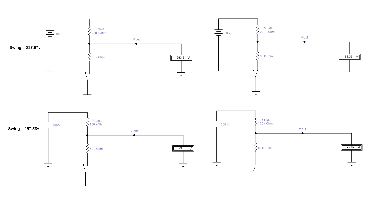

You need to delete that extra 100k resistor ("Rload") at the output of the circuit. You are drawing a DC circuit, and that resistor is in reality isolated by a coupling capacitor. If you do that then you will see how the output voltage can be pulled right up to 300V when the switch is open (valve cut off).Correct. The effect of r-plate (in the drawing) is still the same. A larger value will result in less swing between the open and closed state.
Also bare in mind that signal swing is not the same as gain. You can vary the load on a pentode or transistor over a fairly wide limit without affecting the output swing (which is rail to rail), but the gain certainly does change.

That is true but there is ALWAYS r-load. Typically 100k-1m on the next stage's grid resistor. It will effect the output level, v-out, but will not change the point I'm trying to make. The above example will always have more swing with a lower r-plate. I'll gladly change the r-load to another value for you. The result is still the same.
Yes, but it is isolated by a coupling capacitor, so it plays no part in your DC equivalent circuit. If you want to include the extra grid leak then you need to draw an AC equivalent circuit, which shows the valve as a signal generator (no battery). As it is, you are trying to mix and match AC and DC equivalents, which is why you're getting a result that contradicts reality.That is true but there is ALWAYS r-load. Typically 100k-1m on the next stage's grid resistor.
So which do you want? A way to understand an amplifier using a DC model, or an AC model?
Ok, try a 1k anode resistor. I think you'll find the output swing is only 6V, which goes against the trend you're suggesting!I'll gladly change the r-load to another value for you. The result is still the same

I tried to model it using capacitor coupling r-load and replacing the switch with a transistor and using a signal generator. The software glitched and the output was >2kv. So much for emulation. I only use ewb for drawing anyways. I have yet to find an emulator that works.
I sort of understand it when I take the DC load out. The meter is still 10m but I see where it's going. This is like general electronic stuff. I must just be having a serious brain fart. 😕
Perhaps you need a resistor in series with the base of the transistor? If you feed an AC signal directly into the transistor then the SIM may well do strange things. Whatever it is, it sounds like you have simply overlooked some essential part of the circuit that the software needs to run properly.I tried to model it using capacitor coupling r-load and replacing the switch with a transistor and using a signal generator. The software glitched and the output was >2kv.
