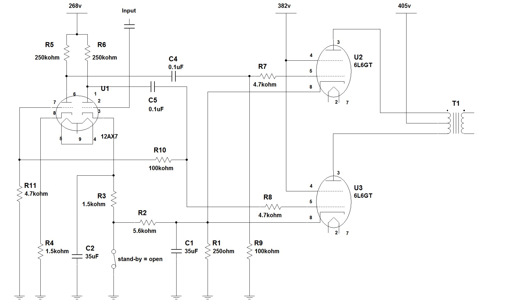

Pin-6 and 1 are unused pins. They just used them as a connection points. Did you mean the 4.7k resistor? That is the input to pin-5.
This schematic should be how the amp is wired now.

In the diagram above those two triode sections in the 12AX7 tube act a a phase splitter to transform the single ended input to a balanced signal to drive the two 6l6 tube 180 degrees out of phase. If you change something do make sure the two 6l6 grides are still driven with equal but out of phase signals

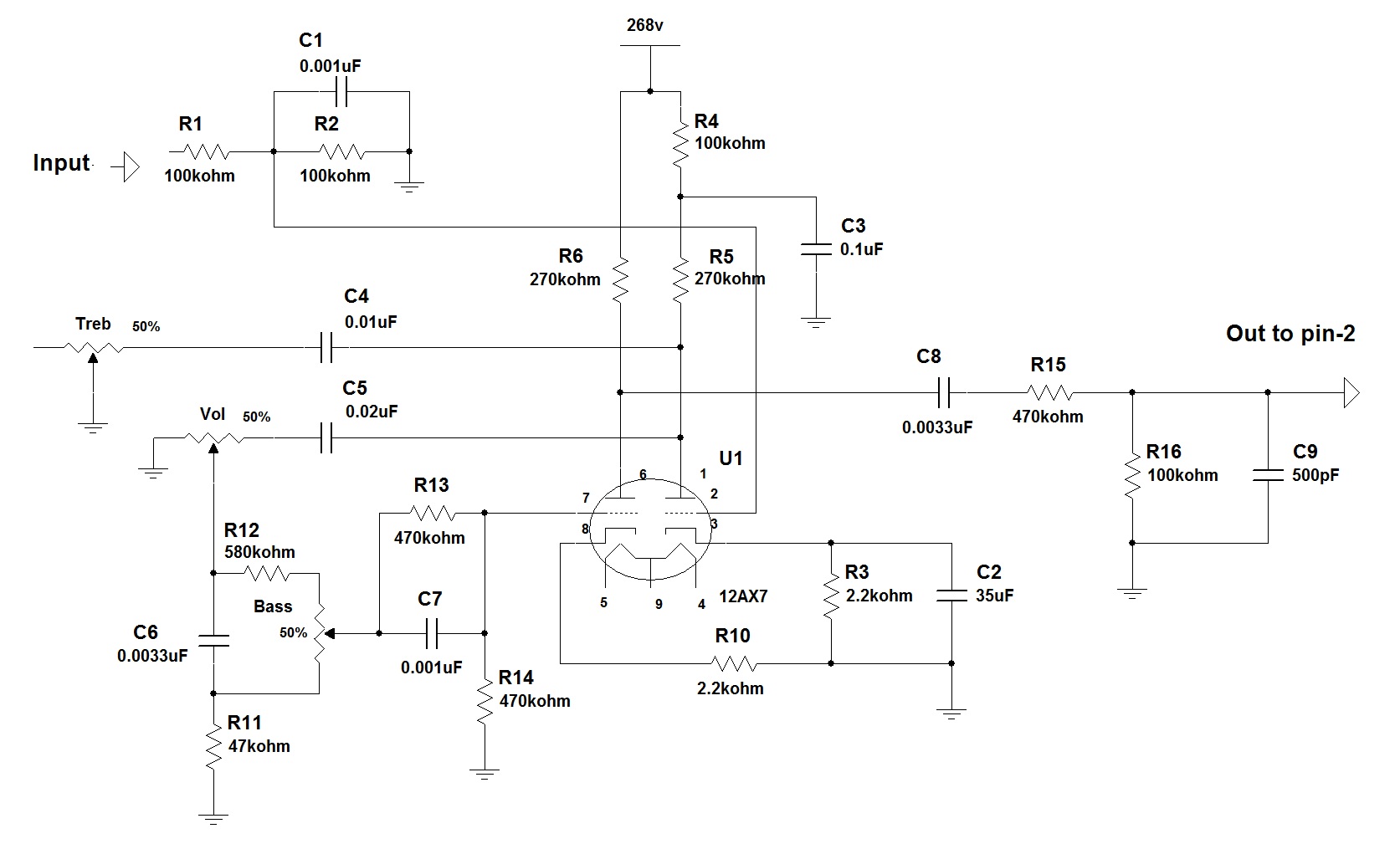

That last schematic doesn't show the preamp. There's another 12ax7 before the phase splitter. That's the circuit I'm tweaking. I haven't made any changes to the phase splitter. The tone and volume controls are in between the preamp and phase splitter and are the cause of much of the noise problem I have. Turning the bass up, for example, adds a ton of noise. I don't have a lot of hum but I have alot of buzzing that sounds like an open line in.

Does the input tube in your above schematic for the phase splitter have a grid resistor? Also, if you have to much gain, try paralleling the preamplifiers tube halves and running a 100k plate resistor. Cascade the tone control between that and the phase splitter, and move your volume control to the input to the preamp.
The above schematic is the preamp. It has a 100k on the output to pin-2 of the phase splitter so, yes?

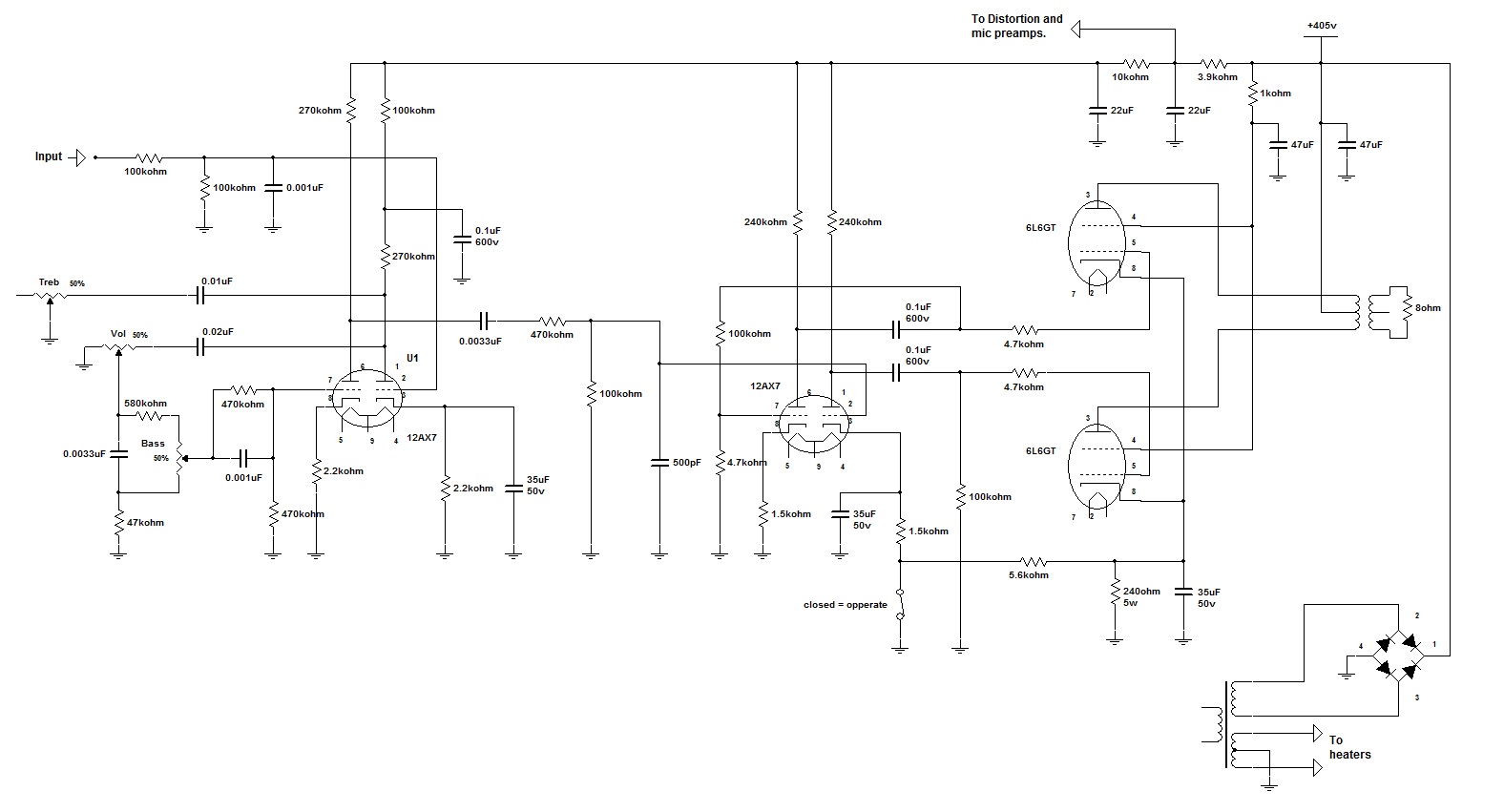

This is how I have 2 channels wired now. I'm 98% sure I have everything right. For everything else there's Mastercard (to buy the parts you blow) 😀
I forgot to note that one output from the opt is grounded. If I tried some feedback, it would go to pin-8 of the preamp right?
If I wanted more range for the bass control, would I increase the .0033uf cap or change the 580k and 47k resistors?
Not sure on the tone control, but for kicks, I'd run a 10k resistor from your positive speaker output to pin 8 of your input tube, see how the feedback changes the sound characteristics and gain.

I see how this bass control works. The .0033 is a high pass and if the pot is towards the 580k there's "less highpass" or more bass. Lowering the 580k gives much better low end.
The phase of the output transformer is important isn't it? I wouldn't want to make an oscillator and fry speakers. 🙁
I haven't tried the feedback suggestion yet. What is the purpose of it? From what I understand, feedback is used to control the gain of an amplifier.

Feedback might be good to tame down the amp and "tighten up" things, and decrease gain slightly. Can you easily drive the amp into clipping?
Does "tightening things up" have a compression-like effect? The way it is now I actually like how the instruments pop out at me while listening. Transient response I believe it's called? Or maybe just attack.
"Can you easily drive the amp into clipping?"
Using my CD players line-level into pin-2? Easily. I have a 100k gate resistor from pin-2 to ground. Also a .001 parallel with that resistor. From the volume (500k) is a 100k series resistor to pin-2. So even with a 1/2 divider, I can drive it to clip with only the paraphase driver. The first thing I notice is the high-end start to roll off (OPT saturation?) then the bass gets flabby and distorted. Clipping I would assume. I'm sure my neighbors love me by now. 🙄
I now completely understand how the paraphase works. The 12ax7 paraphase driver has 2 (A and B) triodes. The input audio feeds triode A where it gets inverted. The inverted signal from triode A feeds one output tube. It also gets fed into triode B where it gets inverted again back into phase with the audio. The in-phase signal then drives the other output tube. One is on while the other is off. Push-pull. I had to stare at the schematic awhile before it clicked. I've never built anything with tubes before but when I realised they work like a transistor voltage amplifier it all made sense. 😀
I made a pre-amp using parallel triodes of another 12ax7. Tone control is in between that and the paraphase driver. Trebble is a cap to ground through the trebble pot and bass is a series cap with the bass pot parallel with that cap. It's as simple as it gets. I'm tuning everything by ear and once I like it I'll throw it on the scope and see how bad it really is.

I will have to take some time to look at Ian's schematic as it is not obvious to me how the PI balance is assured.
The grid of the 2nd 12AX7 stage is connected to the junction of the two 330K resistors, which is a virtual ground point, since the two resistors form a voltage divider across the two out-of-phase output signals.
If the two out-of-phase output signals do not exactly match each other (in magnitude with opposite polarity) then the grid of the 2nd stage will get an error signal from the junction of the two 330K resistors to correct the imbalance, forcing the 2nd stage to mirror the first stage.

I still have to much gain on the parallel triode preamp. I may need some help with it. What I need is to buffer the input not amplify it. The paraphase has enough gain that a preamp isn't needed but if I want tone control, without effecting the input impedance and capacitance, I need to add another tube at the input. The tone controls would go between that tube and the driver.
What about just a cathode follower as the first tube input stage, it will give no gain but will be a low impedance source for the tone stage.

Feedback is kind of a slippery thing. Tightening things up in this context probably refers to tightening the bass response and some of the distortions inherent in pentode mode output distortion. The problem is that one of the unintended consequences can be sucking some of the life (or dynamics) out of the music if it is not done right.
Unfortunately if you are going to run pentode mode you almost have to have some type of feedback. Global (not including the tone control section) is the normal approach but there are some other options all of which have pros and cons. GNFB including the output transformer helps to linearize less than ideal transformers but is more susceptible to instabilities (oscillation) even outside of the audio band due to the transformers reactance. Having access to an oscilloscope helps a lot with this. Another problem is that if the response of the transformer is rather poor to begin with the correction signals applied via. feedback can be quite large and can drive either the OPT or other components into an overload condition.
Another approach is to use either local feedback or global that does not include the transformer. You can't compensate for transformer performance this way but you can deal with the nonlinearities and high Zout of the output tubes this way which will help wit overall distortion and bass response (tightness). If you have UL taps on the OPTs the UL mode connection provides some local feedback (or at least something that acts a lot like it). Triode connection also provides local feedback but reduces output power substantially. That may not be a problem if you have plenty of power (not gain but power) already.
Another type of local feedback that I am planning on trying in a couple of projects that I am now working on is the plate to plate feedback where a resistor between the output tube plate and the driver plate provides feedback essentially to the output tube grid. The idea is to linearize the output stage and reduce effective Zout. I am not sure but in your case you might have to insert a separate driver stage after the PI to accept the feedback as the impedance seen by the feedback resistor might otherwise be different in the two phases causing a different amount of feedback on each side. Again this is just my gut feeling.
